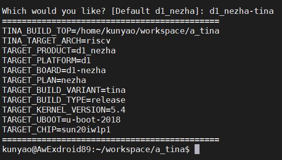

Compile and package
The compilation and packaging commands are as follows:
source build/envsetup.sh
lunch d1_nezha-tina
make -j32
pack
Among them:
  • source build/envsetup.sh : Get environment variables
  • lunch D1-H_nezha-tina chooses D1-H_nezha-tina scheme, or you can just lunch directly without adding parameters, so there will be options to choose, among which lunch D1-H_nezha-tina is the standard scheme of D1-H_nezha-tina, and `lunch D1-H_nezha_min-tina can only make the system run The smallest system scheme.
  • make -j32 : Compile, where the number parameter after -j is the number of threads used for compilation, which can be selected according to the actual situation of the PC used for compilation by the developer.
  • pack : Pack, pack the compiled firmware into a firmware in .img format, the firmware path is /out/d1_nezha-tina/tina_d1-nezha_uart0.img.

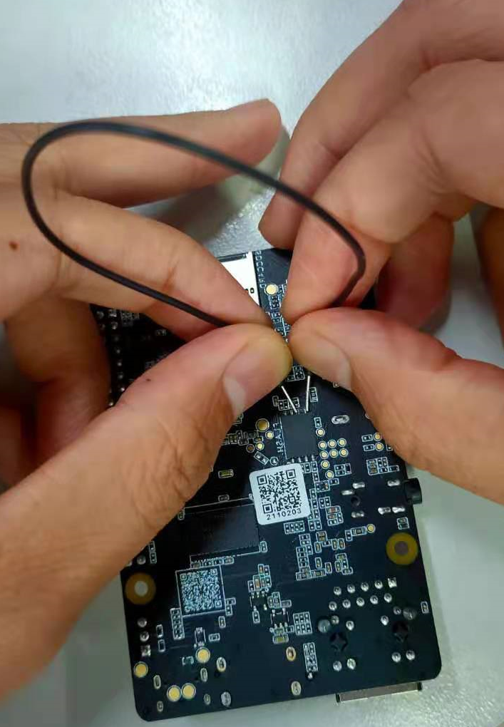

Short Nand
When the device is is starting, use tweezers or a Dupont cable to short the power supply pins of Nand (the two pins on the lower right foot), so that the device will not be able to detect the existence of Nand during the startup process, and mistakenly think that this is an empty film , In this way, the device will automatically enter the programming mode according to the process of starting the blank film. As shown in the figure: Short Nand
*Prompt: When the PC recognizes the device pops up a prompt, you can loosen the shorted Dupont line without having to keep shorting it
