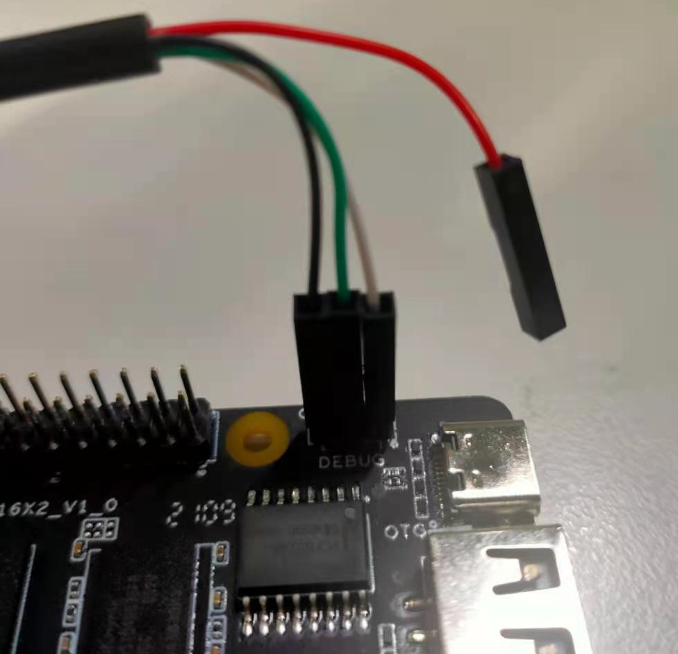

Serial port driver
You can use the USB to serial cable to debug the device. The recommended serial cable is CH341SER, and the drivers are as follows:
CH341SER serial line driver download
Baud rate: 115200
Wire sequence: black-GND, red-3.5V, green-RX, white-TX

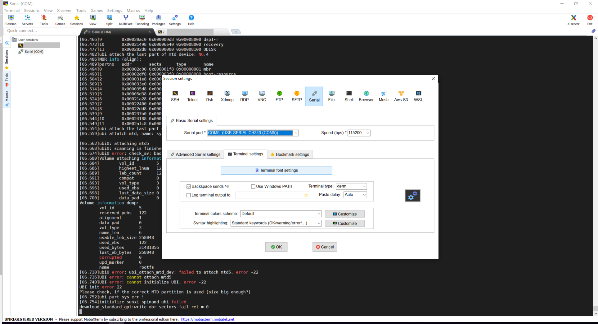

MobaXterm
MobaXtermbackup is a powerful and easy-to-use remote computer toolbox, you can use it for serial debugging, connecting to remote servers, etc.
You can go to MobaXterm official download and use, link: https://mobaxterm.mobatek.net/download.html

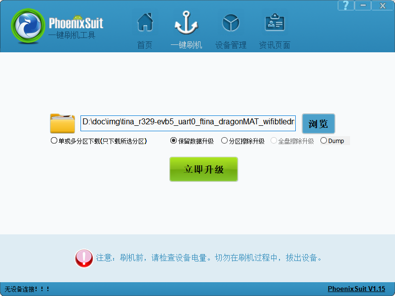

Firmware burning tool PhoenixSuit
PhoenixSuit is the Allwinner firmware programming tool, which can program (download) the firmware (.img) compiled by the host computer to the development board.
Download link:https://www.aw-ol.com/downloads/resources/13

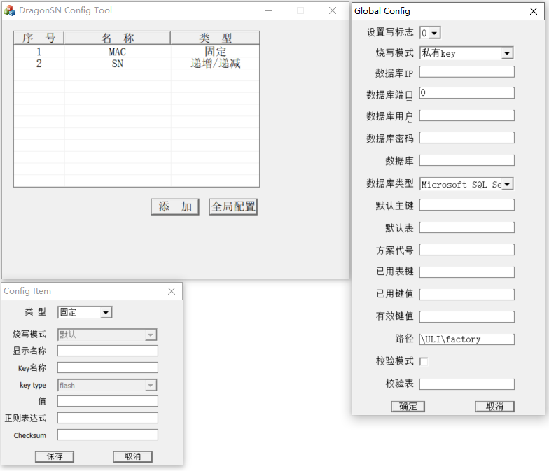

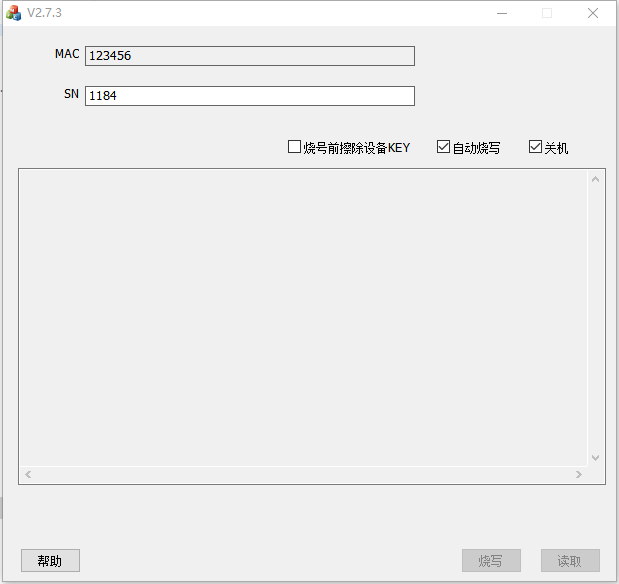

Device number burning tool DragonSN
DragonSN is an Allwinner device number burning tool, which can burn the device number (SN), MAC address, security key, etc. to a certain partition of the development board via USB.
Download link: https://www.aw-ol.com/downloads/resources/11

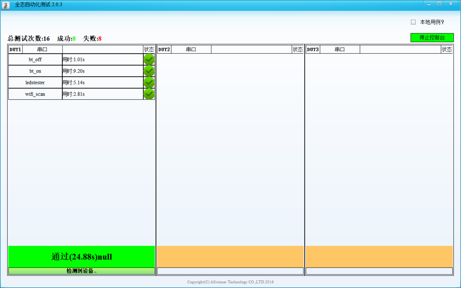

Production test tool DragonMAT
DragonMAT is a production test tool for Allwinner. It can cooperate with Tinatest for R&D performance testing and production function testing, such as Bluetooth switch test, WIFI scan test, LED three-color lighting and flashing test, nand read-write test, power-off restart test, Recording/playing test, etc., test items, test times and test rules can be configured by yourself. At the same time, Allwinner has opened up the interface of related tools, and can carry out the secondary development of the original software, and customize the supporting test software suitable for the use of the factory in order to build the test system.
