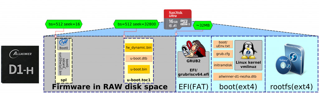

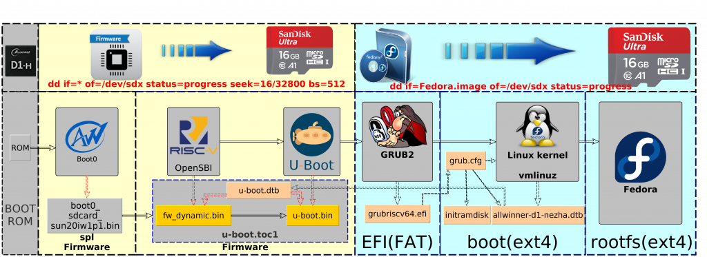

Firmware Build order
SPL(Boot0)
boot0 or SPL (Secondary Program Loader) which the first stage after BootROM, it is responsible for initializing DRAM and loading next stage firmware from storage(Flash or SD).
Using Smaeul SPL directly.
Build binary
git clone https://github.com/smaeul/sun20i_d1_spl
pushd sun20i_d1_spl
git checkout origin/mainline
make CROSS_COMPILE=riscv64-linux-gnu- p=sun20iw1p1 mmc
popd
Flash to SD card
pushd sun20i_d1_spl
sudo dd if=nboot/boot0_sdcard_sun20iw1p1.bin of=/dev/sdX bs=512 seek=16
OpenSBI
RISC-V Open Source Supervisor Binary Interface, like arm-TF
Using Smaeul's patches, but rebase to the latest upstream OpenSBI, and fix some issue.
Build binary
git clone https://github.com/tekkamanninja/opensbi -b allwinner_d1
pushd opensbi
CROSS_COMPILE=riscv64-linux-gnu- PLATFORM=generic FW_PIC=y make
popd
The build/platform/generic/firmware/fw_dynamic.bin will be used to make u-boot.toc1 below.
U-boot
Using Smaeul's patches, but enable more features and add some default env for auto-booting into GRUB, and also rebase to the latest upstream U-boot.
Build binary
git clone https://github.com/tekkamanninja/u-boot -b allwinner_d1
pushd u-boot
make CROSS_COMPILE=riscv64-linux-gnu- ARCH=riscv nezha_defconfig
make CROSS_COMPILE=riscv64-linux-gnu- ARCH=riscv menuconfig
make CROSS_COMPILE=riscv64-linux-gnu- ARCH=riscv u-boot.bin u-boot.dtb
popd
The u-boot.bin and u-boot.dtb will be used to make u-boot.toc1 below.
Build u-boot.toc1
- toc1.cfg:
[opensbi]
file = fw_dynamic.bin
addr = 0x40000000
[dtb]
file = u-boot.dtb
addr = 0x44000000
[u-boot]
file = u-boot.bin
addr = 0x4a000000
- build command:
pushd u-boot
cp ${PATH_TO_TOC1_CFG}/toc1.cfg ${PATH_TO_OPENSBI}/fw_dynamic.bin .
tools/mkimage -T sunxi_toc1 -d toc1.cfg u-boot.toc1
popd
Flash u-boot.toc1 to SD card
pushd u-boot
sudo dd if=u-boot.toc1 of=/dev/sdX bs=512 seek=32800

You can build a grubriscv64.efi by following the page above. Then put it into the /EFI/ dir of the EFI partition of SD card.
Some example files in the boot partition:
/boot/uEnv.txt
bootcmd=load mmc 0:2 0x58000000 /EFI/fedora/grubriscv64.efi; bootefi 0x58000000
bootcmd_mmc0=devnum=0; run mmc_boot
/grub.cfg
set default=0
set timeout_style=menu
set timeout=3
set debug="linux,loader,mm"
set term="vt100"
menuentry 'Fedora vmlinux-5.15.0-rc1' {
linux /vmlinuz-5.15.0-rc1 earlyprintk=sunxi-uart,0x02500000 console=ttyS0,115200 console=tty0 loglevel=8 root=/dev/mmcblk0p4 selinux=0 rhgb LANG=en_US.UTF-8
devicetree /sun20i-d1-nezha.dtb
initrd /initramfs-5.15.0-rc1.img
