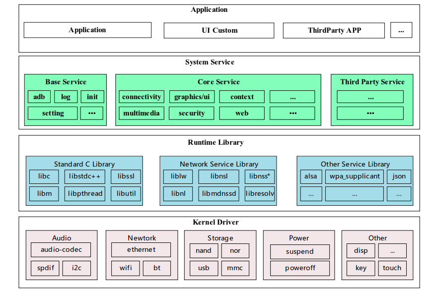

Block Diagram of System
The Tina system software architecture is shown in the figure. From bottom to top, there are four layers: Kernel && Driver, Libraries, System Services, and Applications.
Kernel && Driver
The main layer of Kernel&&Driver provides the standard implementation of Linux Kernel. The Linux Kernel of the Tina platform uses Linux3.4, Linux3.10, Linux4.4, Linux4.9, Linux5.4, and other kernels. Different hardware platforms use different kernel versions to provide security, memory management, thread management, network protocol stacks, etc. Basic support, and through the Linux kernel management device hardware, such as CPU scheduling, cache, memory, I/O, etc. The D1-H resource adaptation is the Linux 5.4 kernel.
Libraries
The library layer corresponds to the general embedded system and corresponds to the middleware layer. Including its various basic system libraries, support for open source libraries, API development interfaces, system customizers, and applications can develop new system services and applications based on library layer APIs.
System Services
The system service layer corresponds to the system service layer, including system startup management, configuration management, hot-swap management, storage management, multimedia middleware, etc.
Applications
The application layer is mainly to implement specific product functions and interaction logic. Developers can develop and implement their programs to provide end-users with various capabilities of the system.
