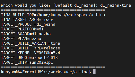

The compilation and packaging commands are as follows:
source build/envsetup.sh
lunch d1_nezha-tina
make -j32
pack
Among them:
- source build/envsetup.sh : Get environment variables
- lunch D1-H_nezha-tina chooses
D1-H_nezha-tinascheme, or you can just lunch directly without adding parameters, so there will be options to choose, among whichlunch D1-H_nezha-tinais the standard scheme ofD1-H_nezha-tina, and `lunch D1-H_nezha_min-tina can only make the system run The smallest system scheme. - make -j32 : Compile, where the number parameter after -j is the number of threads used for compilation, which can be selected according to the actual situation of the PC used for compilation by the developer.

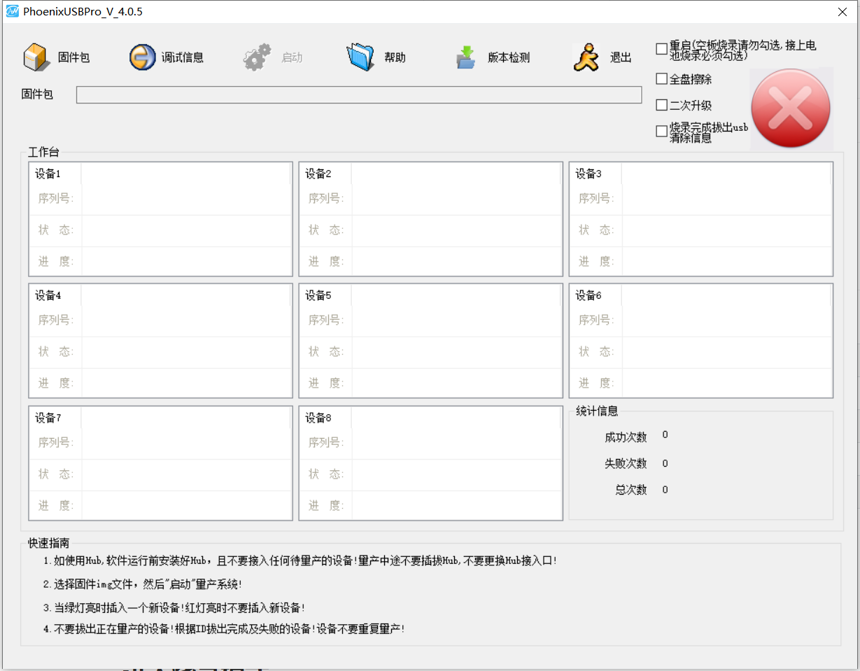

(3) PhoenixUSBpro: a programming tool for Windows-based systems. Connect the PC and the development board through a data cable to burn the firmware to the development board. A PC can connect to 8 devices at the same time, and they can be controlled separately for programming. Mass production on the production line. (As shown below)

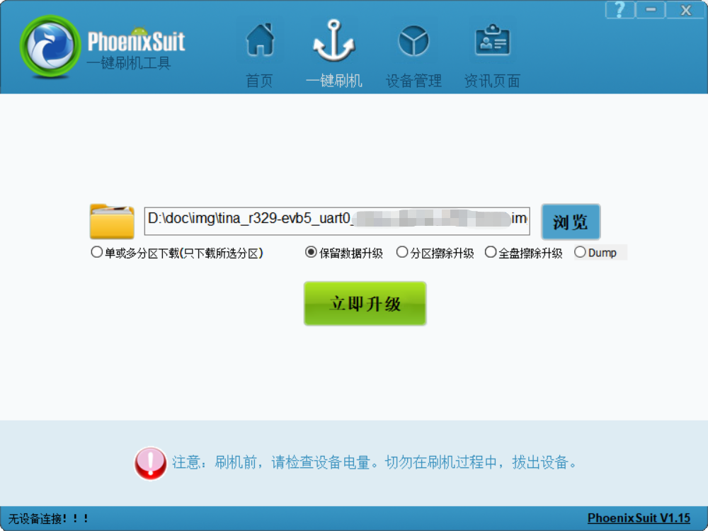

(1) Open PhoenixSuit, when the device is powered on and plugged into the USB to connect to the PC, PhoenixSuit will prompt to recognize the device;
(2) Click one-key flashing-browse to select the firmware to be burned;
(3) Click to Flash. At this time, a restart command will be sent to the device via USB, and the device will restart with the programming logo, and enter the programming mode during the restart phase;
(4) When the device restarts to boot, it will automatically burn and write, you can see the progress bar of PhoenixSuit is moving;
(5) The programming is successful and the device restarts.

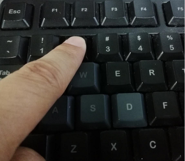

Press and hold the "2" key on the PC keyboard
When the device is starting, press and hold the "2" of the PC keyboard in the serial terminal and input "2" continuously. If the input of "2" is checked when the device is started, it will automatically jump to the programming mode. As shown in the figure (it is really pressing the "2" of the keyboard, many new developers do not understand this hidden operation):

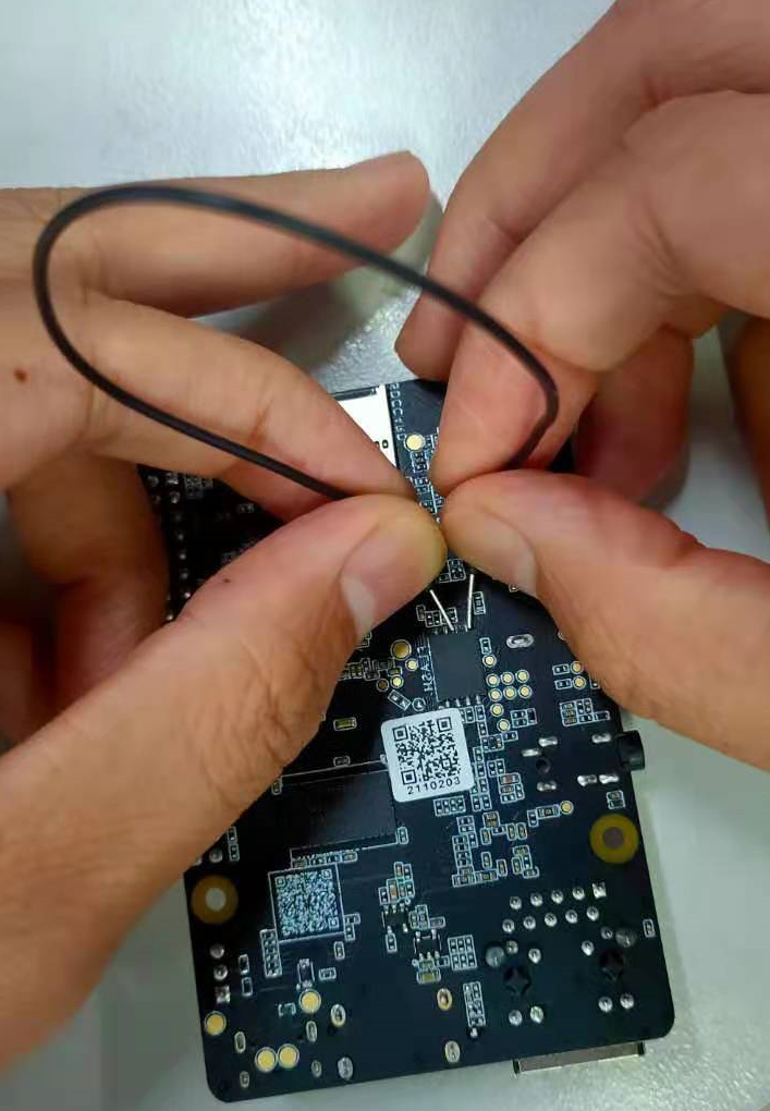

Short Nand
When the device is is starting, use tweezers or a Dupont cable to short the power supply pins of Nand (the two pins on the lower right foot), so that the device will not be able to detect the existence of Nand during the startup process, and mistakenly think that this is an empty film , In this way, the device will automatically enter the programming mode according to the process of starting the blank film. As shown in the figure:
*Prompt: When the PC recognizes the device pops up a prompt, you can loosen the shorted Dupont line without having to keep shorting it
