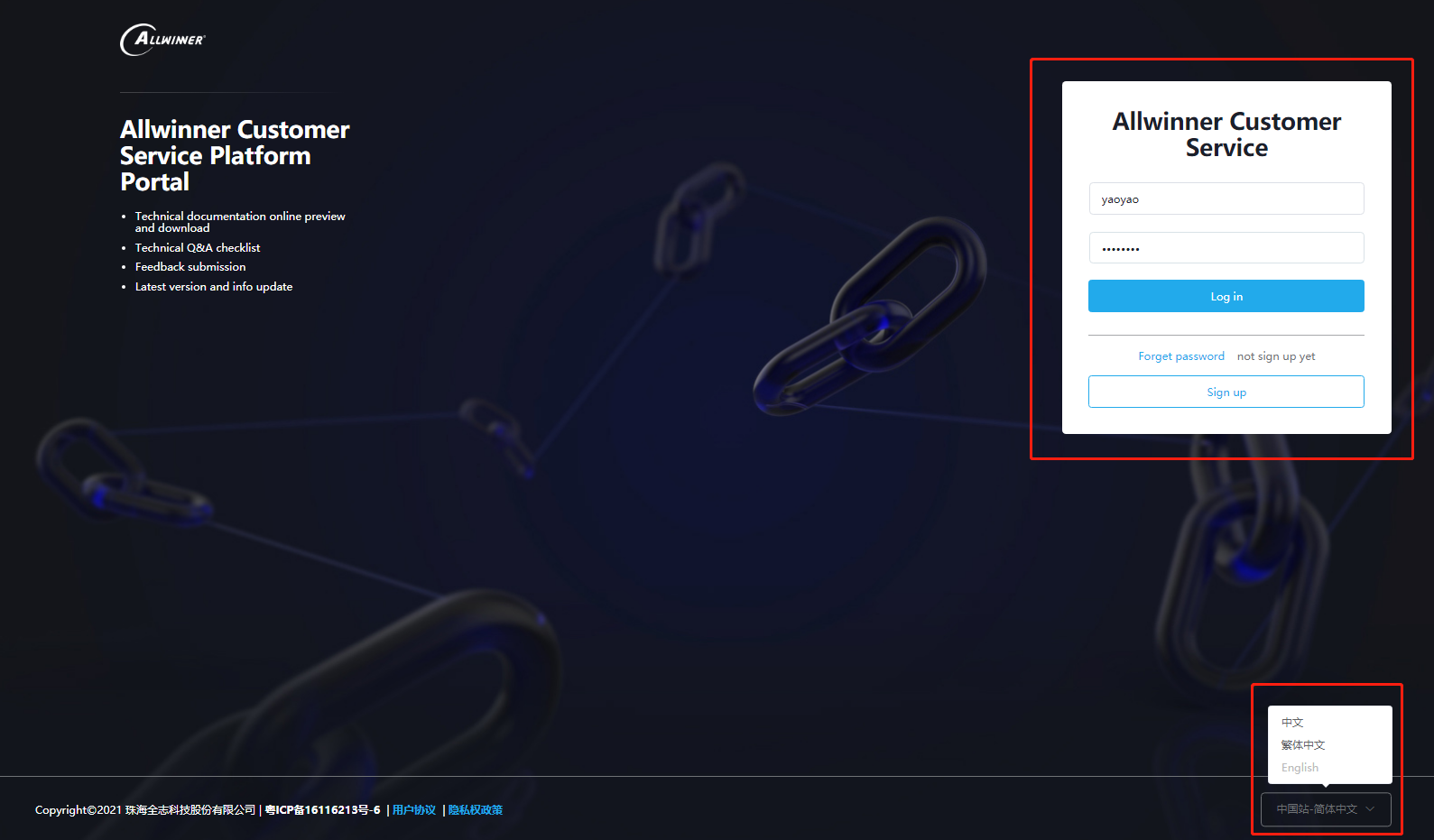

Log in
Allwinner customer service platform official website:
*At the same time, you can switch between Chinese and English through the options in the lower right corner

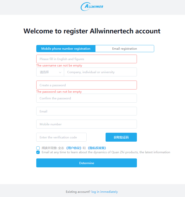

Register an account
Click "register now" to register. Registration means agreeing to the related user agreement of Allwinner Technology.

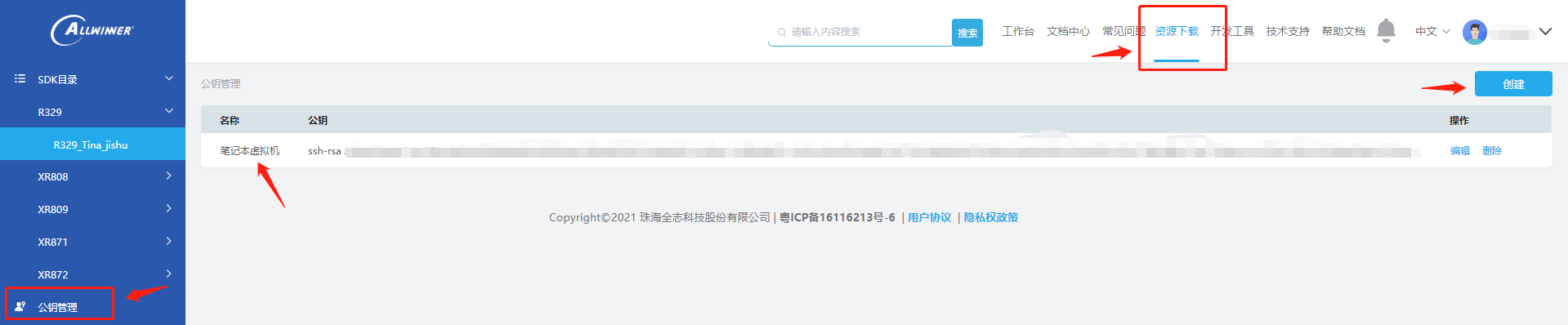

Add public key
Log in to your account, click "Resource Download" in the upper menu bar-"Public Key Management" in the left menu bar-"Create" in the upper right corner to add the public key, and add the public key of the PC used to download the code here.

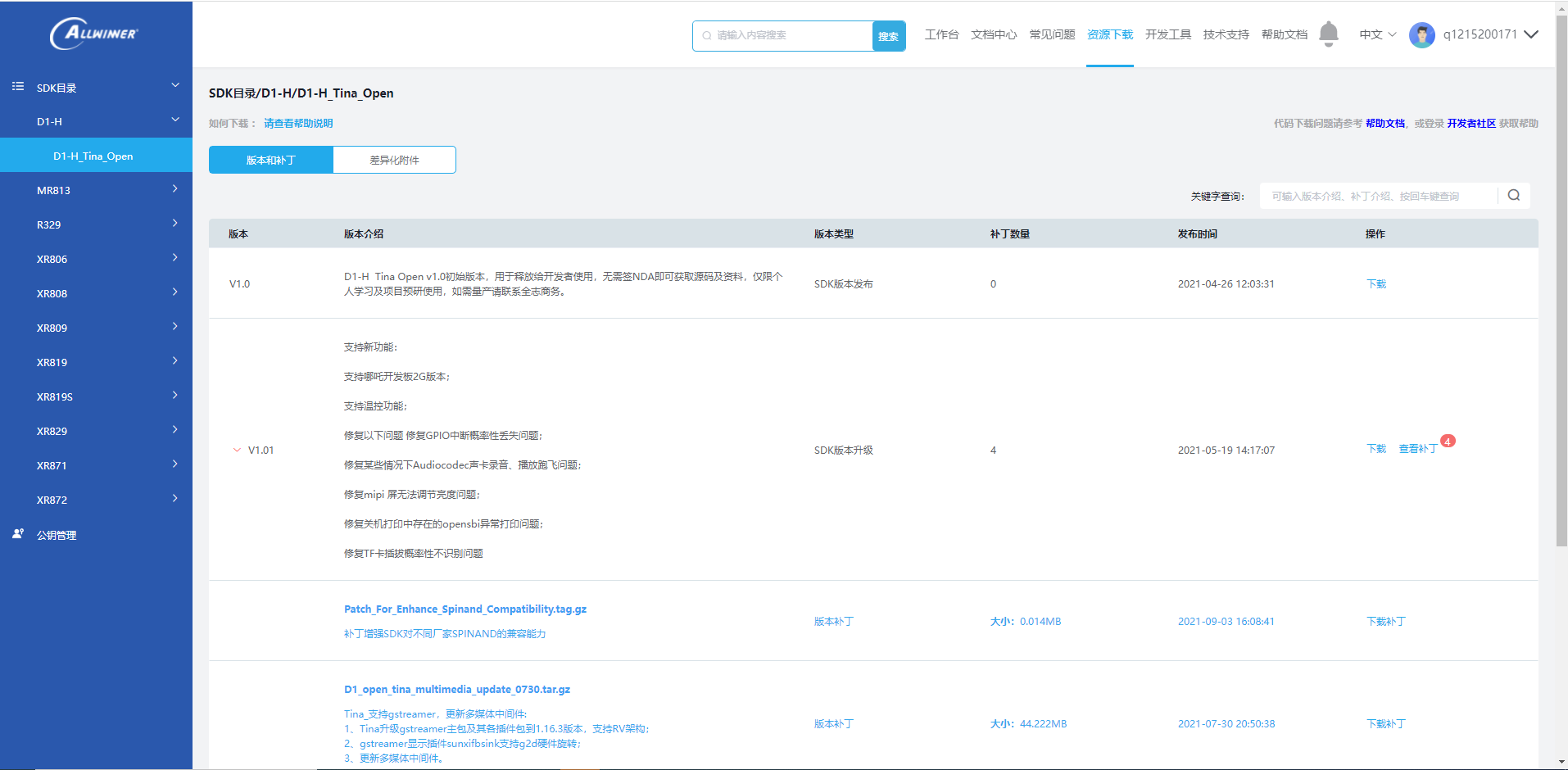

Code download
Click "Resource Download"-"SDK Directory"-"D1-H", you can see D1-H Tina SDK, click download will prompt related download command operation.
