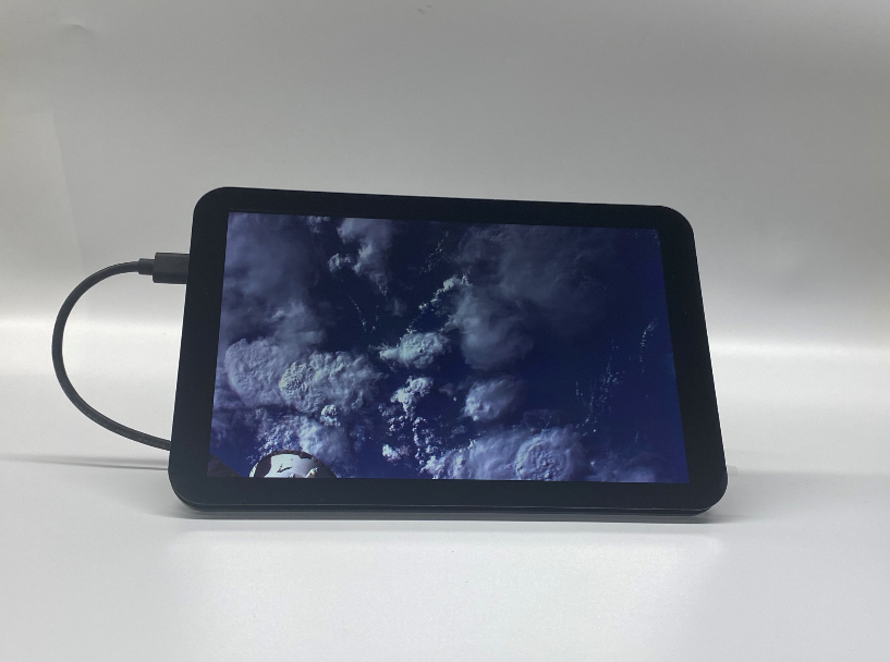

TFT080006 officially supports analog PI screen, 8 inches, resolution 800*1280. The official package supports playback.
image-20210517162453625

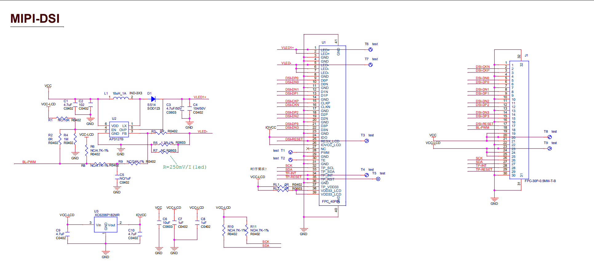

If the above command cannot adjust the brightness of the backlight, you need to check the hardware of the screen adapter board: Combining the schematic diagram of the screen adapter board, connect R6 of the backlight module to a 1K resistor (note that the resistance value of R4 is ≥10K or leave it blank, and R7 is set air)
Schematic diagram of adapter board
image-20210609095825950
