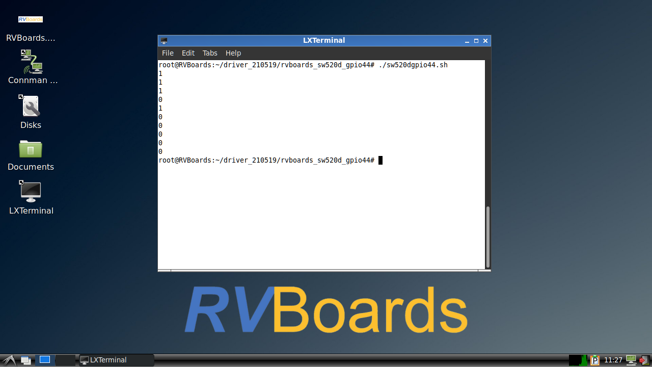

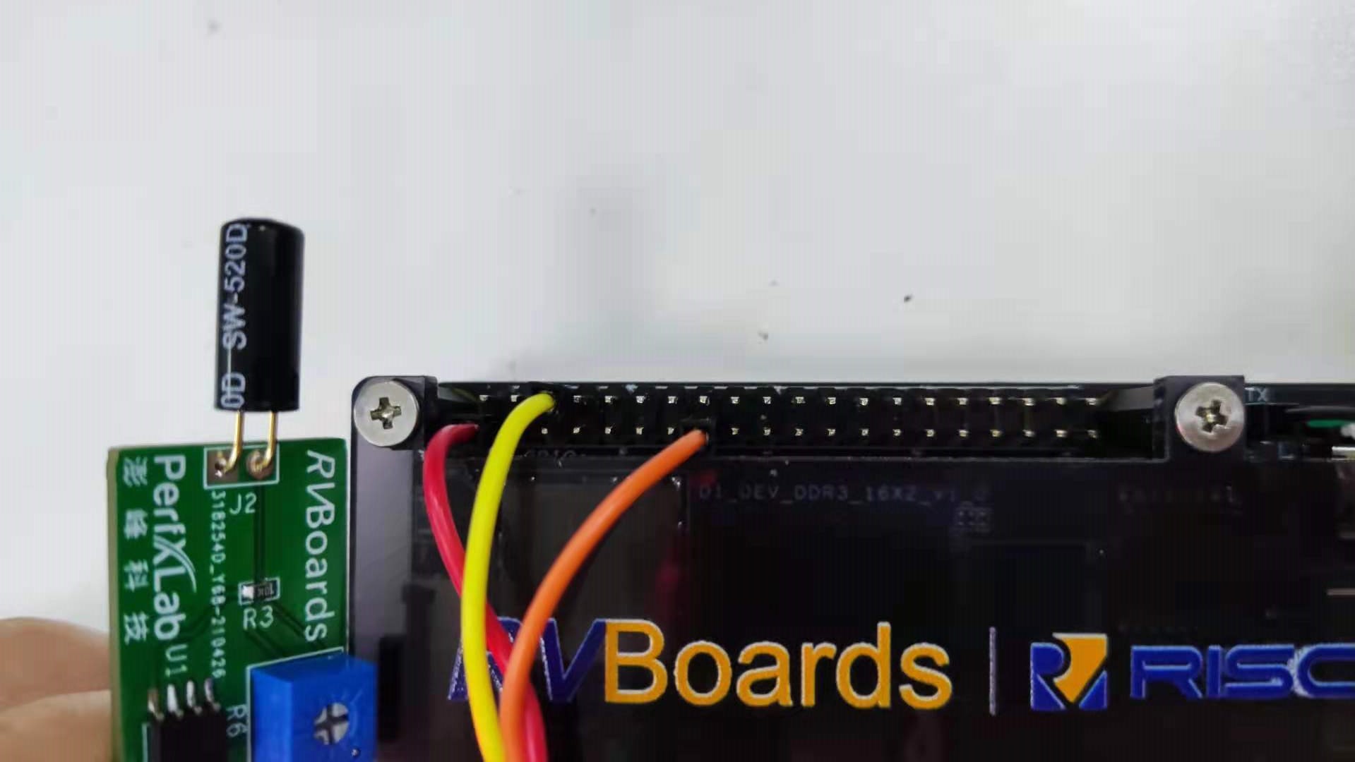

Tilt module sw-520 d
Module code address: rvboards/D1-H_demo: The demo projects for Allwinner D1-H SBC (github.com)
Code running method (requires sudo permission):
sudo ./sw520dgpio44.sh

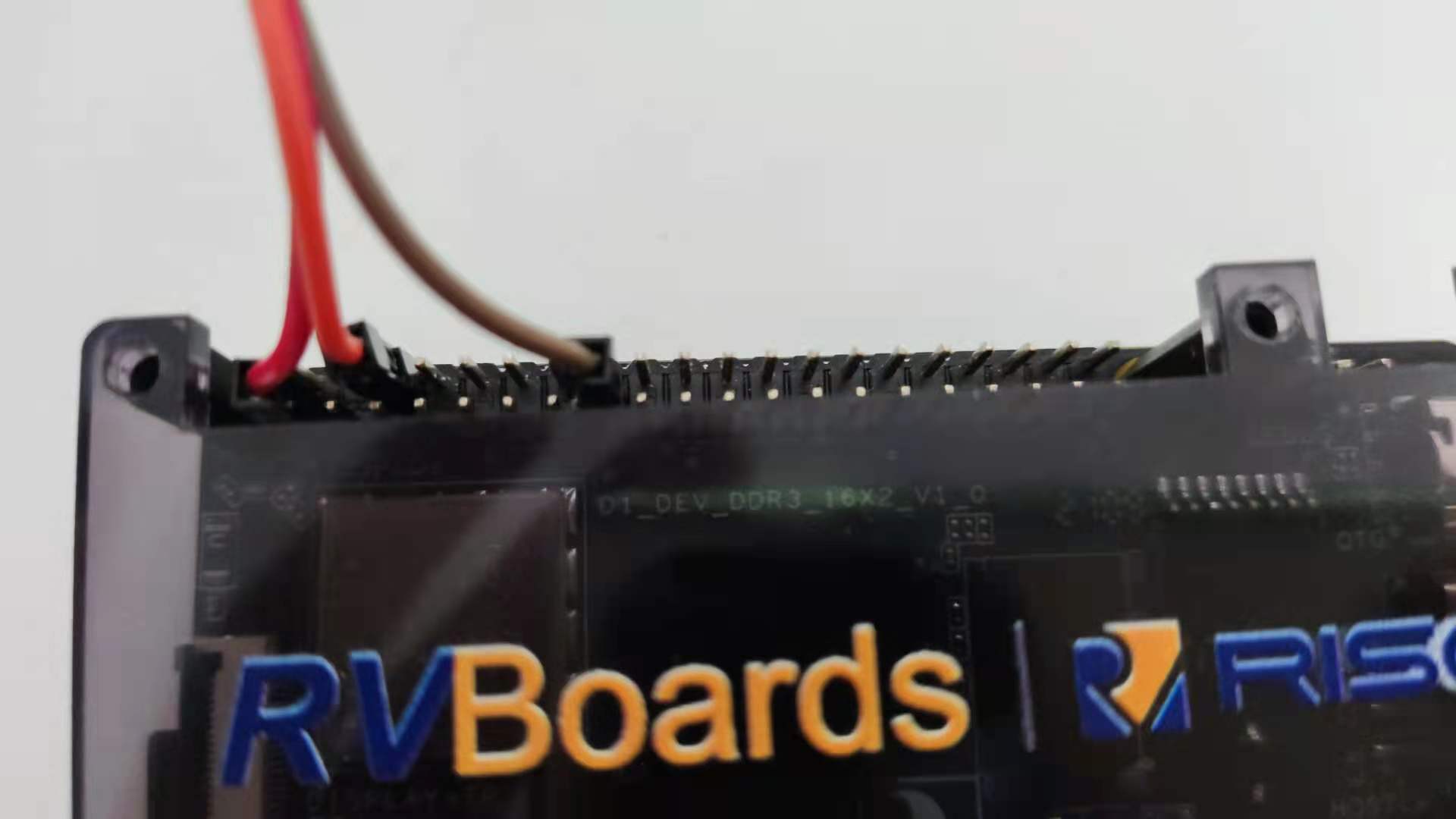

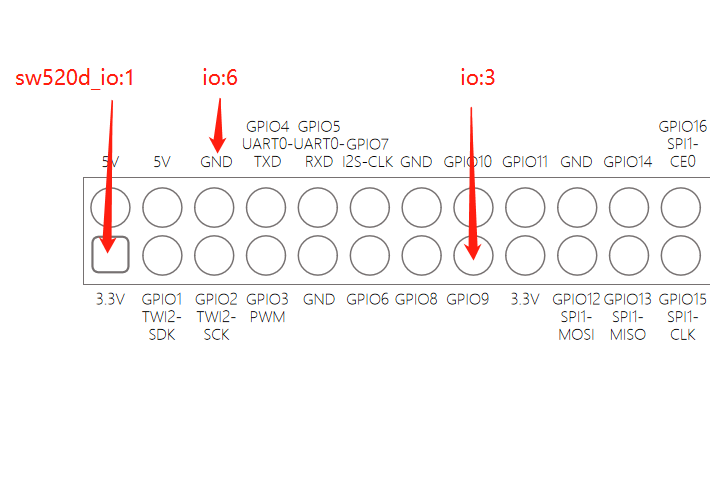

Need to use DuPont cable to connect the module;
The physical connection diagram is shown in the figure below, please check the schematic diagram for details:

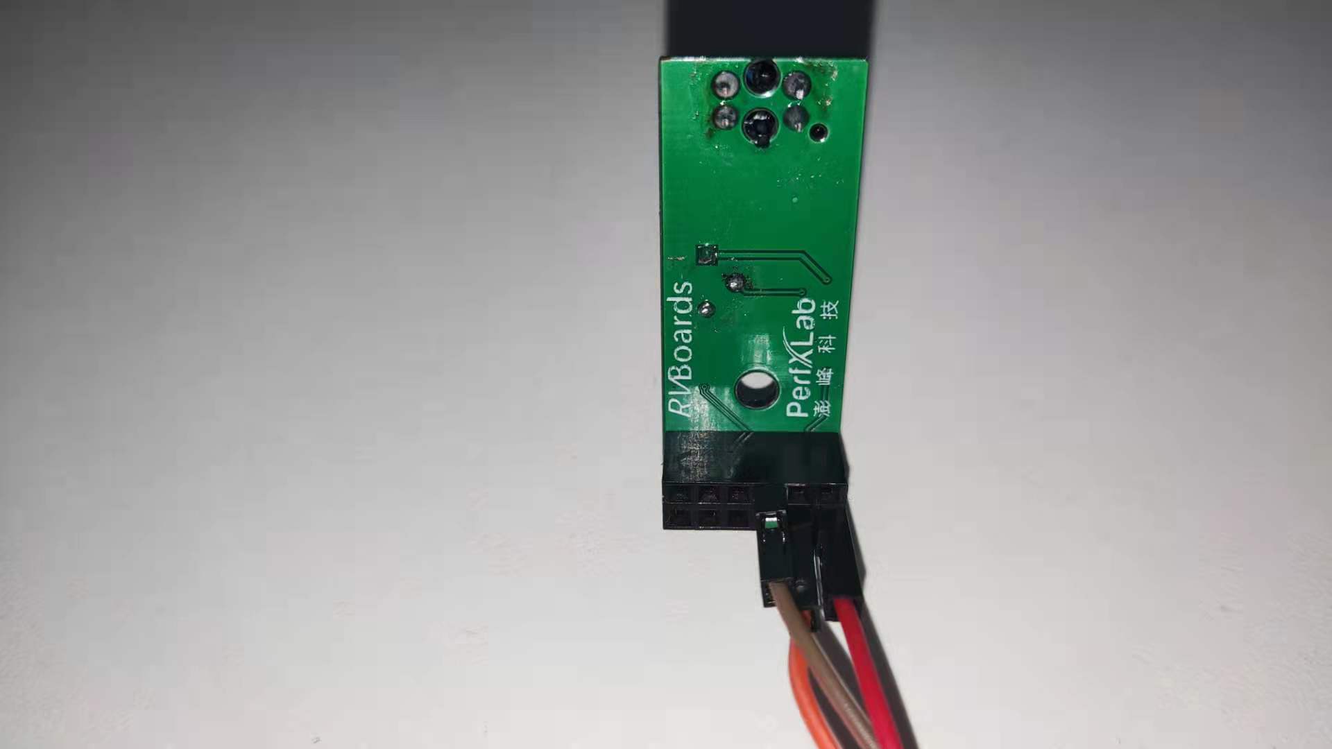

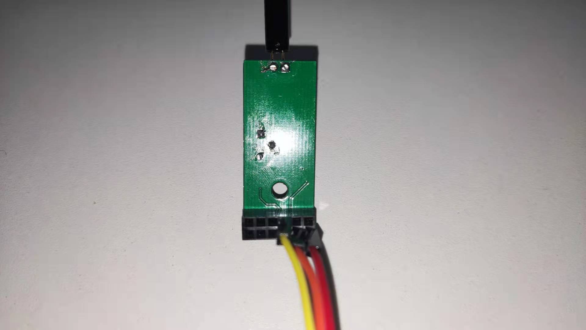

Tracking obstacle avoidance module TCRT5000
Module code address: rvboards/d1-H_demo:rvboards/d1-H_demo: The demo projects for Allwinner D1-H SBC (github.com)
sudo ./tcrt5000gpio44.sh
Need to use DuPont cable to connect the module, please check the schematic diagram for details:

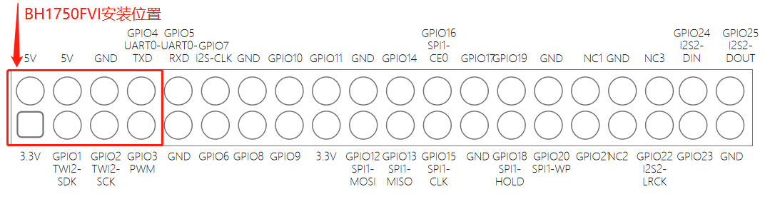

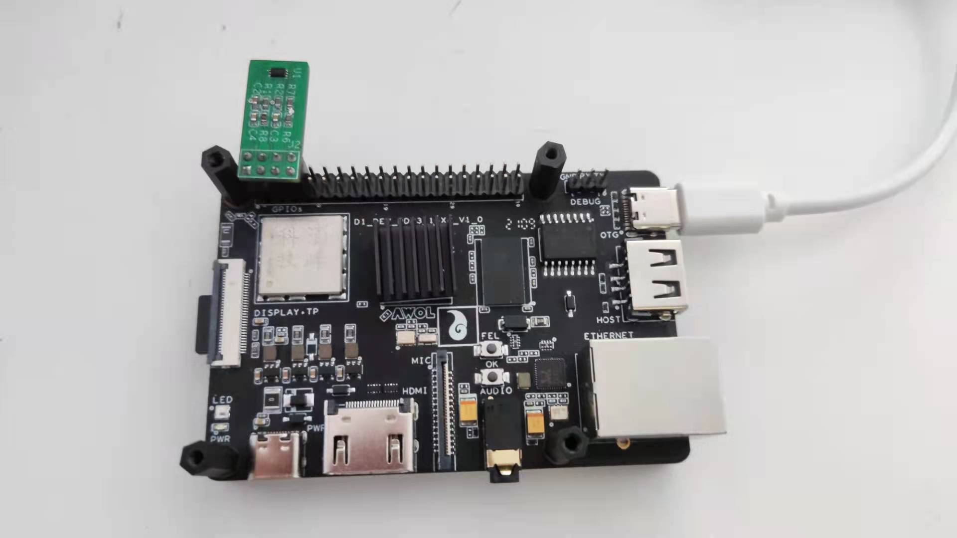

Light intensity sensor BH1750FVI----i2c
Module code address: rvboards/D1-H_demo:rvboards/D1-H_demo: The demo projects for Allwinner D1-H SBC (github.com)
make
./runtest.sh
- The connection diagram of the light intensity sensor module is as follows, please refer to the schematic diagram for details.

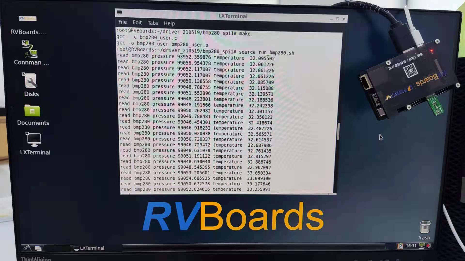

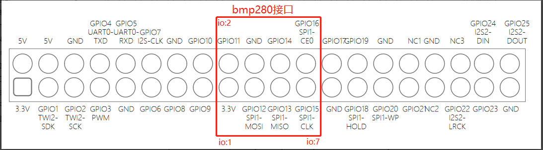

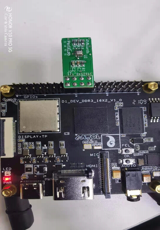

Atmospheric pressure sensor BMP280
- Module code address: rvboards/D1-H_demo:rvboards/D1-H_demo: The demo projects for Allwinner D1-H SBC (github.com)
make
./runtest.sh
- The connection diagram of the atmospheric pressure sensor BMP280 module is as follows, please refer to the schematic diagram for details:

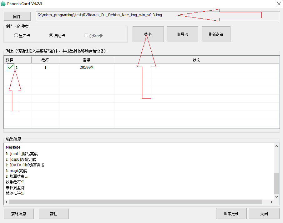

Burning under Windows 10 system
- Documents needed
RVBoards_D1-H_Debian_lxde_img_win_v0.3.img or RVBoards_D1-H_Debian_consose_img_win_v0.3.img
- PC system environment requirements
Windows10
- Tools needed
Software: AW PhoenixCard Hardware: SD card, 32GB is recommended
- PhoenixCard software installation (requires environment windows)
Click PhoenixCard.exe to install the card making software;
- Burn image
