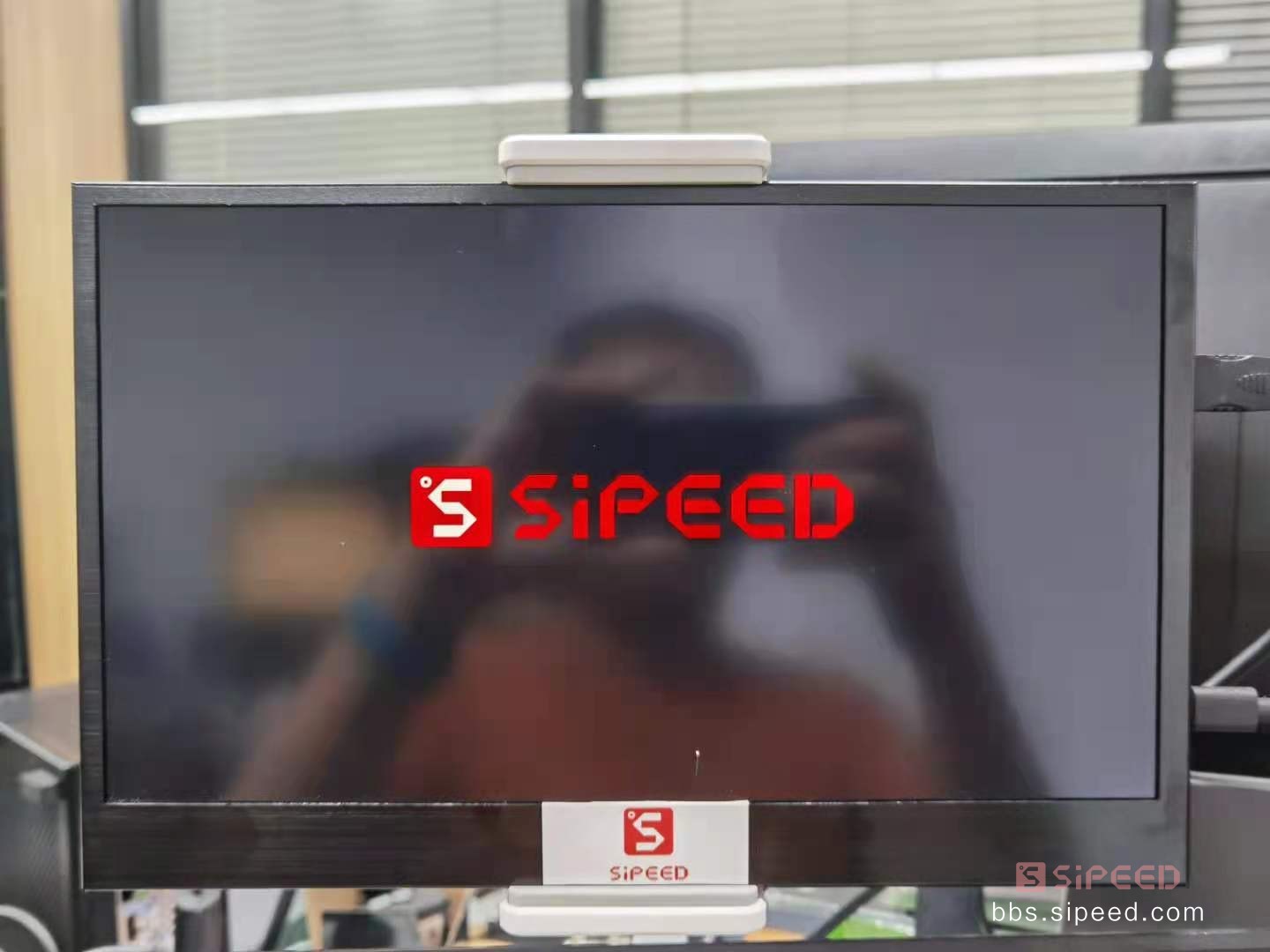

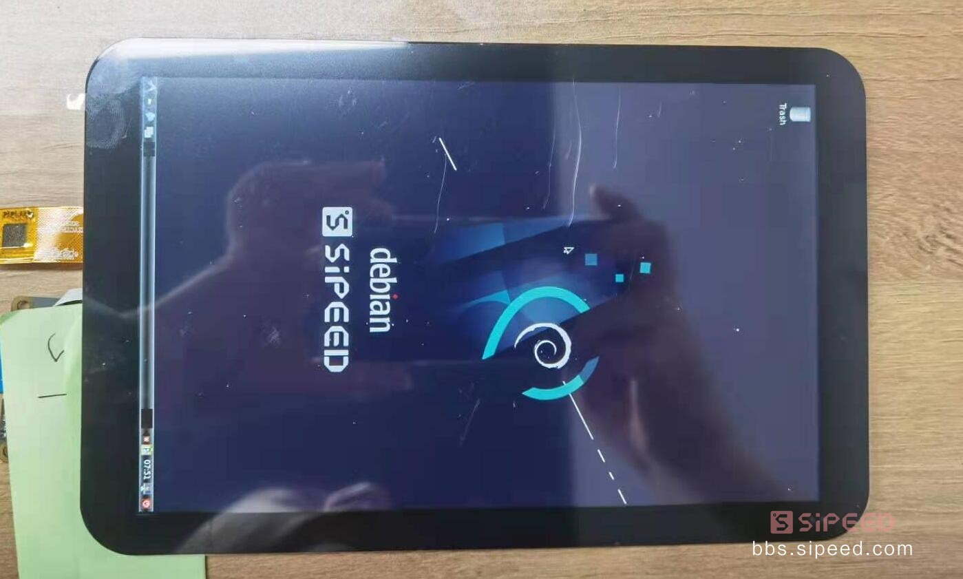

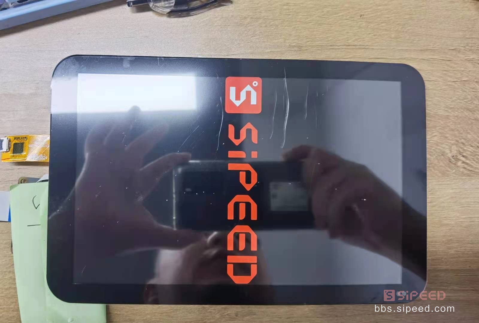

You can see the SIPEED logo on the screen after power-on for about 3 seconds:

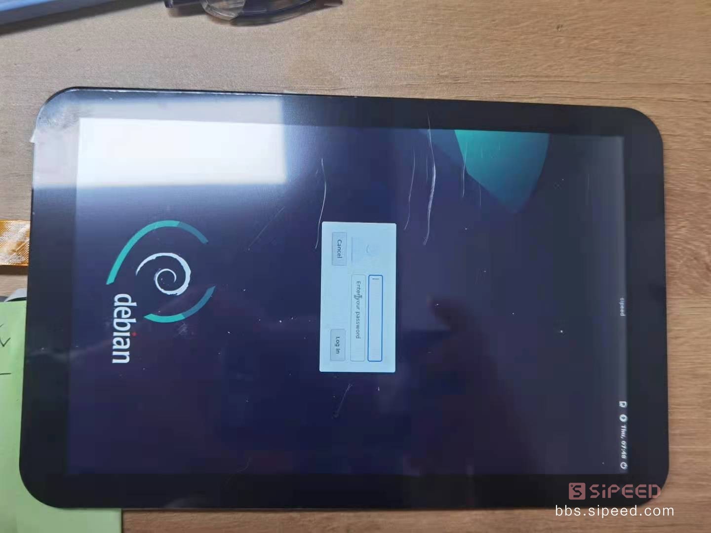

Wait another minute or so to enter the login interface:
*Login account is sipeed or root, password is licheepi

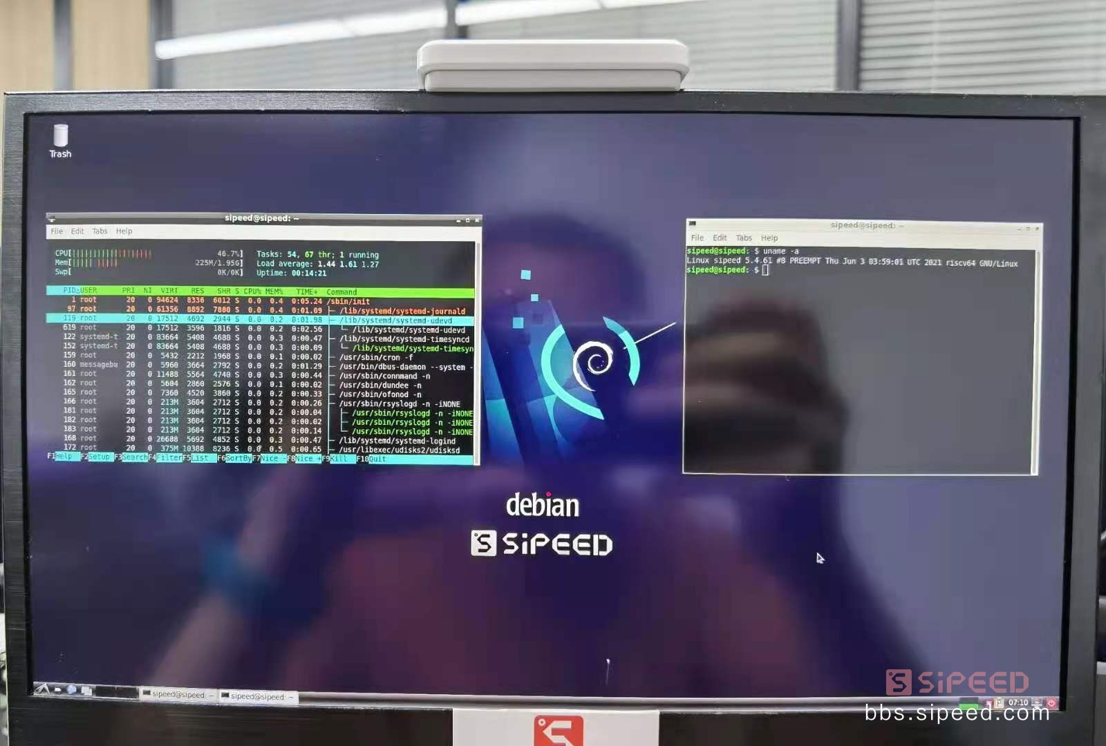

Wait a moment to enter the desktop system
Basic use of debian
The basic use of D1-H nezha's debian is the same as the desktop's debian
Plug in the network cable to get the ip network automatically, and you can use apt to install and download the software package (sudo required)
Debian's built-in gcc tool chain also facilitates developers to compile locally on D1-H.

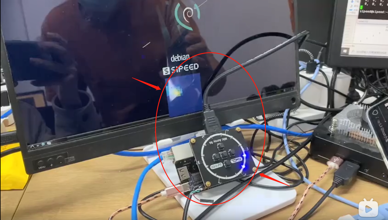

The user connects the microphone array board to the main board using an FPC cable and fixes it with a nut.
After running the demo program, the LED on the microphone array board will flash the R->G->B water lamp once, and then enter the sound field imaging demonstration.
A 128x128 pixel sound field imaging thermal image will be presented in the designated area of the screen, and the LED on the microphone array board will also simultaneously indicate the direction of the sound source.
