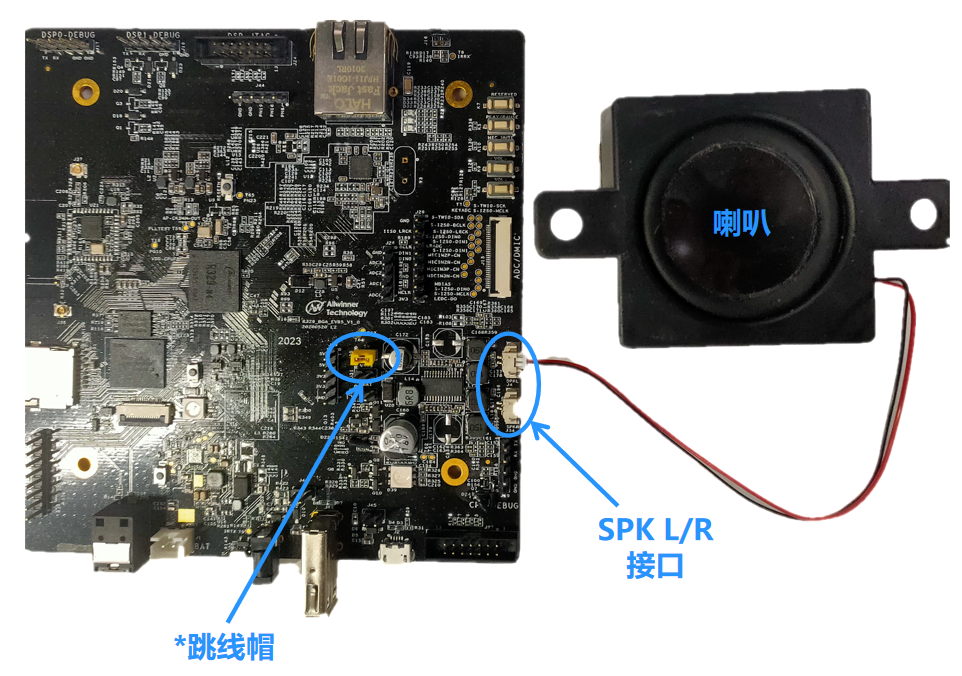

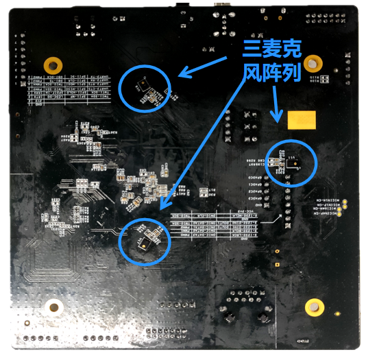

R329 EVB5 开发板背面贴了3颗麦克风,可组成麦克风阵列,配合降噪算法调试语音识别类产品。
image-20210108172926836
同时接出了SPK L/R,可以接喇叭进行音频相关的调试。
image-20210108184002507
*另需注意图中所示的跳线帽需要接上,否则喇叭播放会不出声音

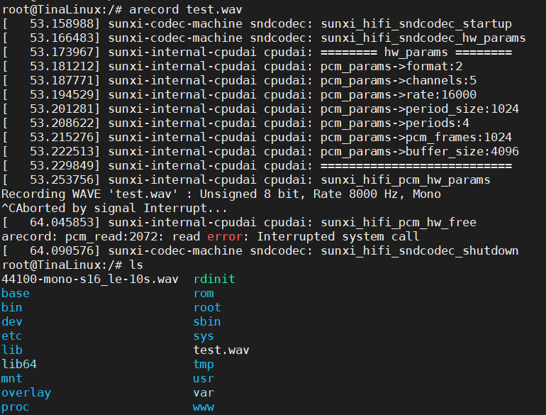

内置的固件中,已经封装好了音频相关模块,可以直接使用demo录音和播放。
root@TinaLinux:/# arecord test.wav
[   53.158988] sunxi-codec-machine sndcodec: sunxi_hifi_sndcodec_startup
[   53.166483] sunxi-codec-machine sndcodec: sunxi_hifi_sndcodec_hw_params
[   53.173967] sunxi-internal-cpudai cpudai: ======== hw_params ========
[   53.181212] sunxi-internal-cpudai cpudai: pcm_params->format:2
[   53.187771] sunxi-internal-cpudai cpudai: pcm_params->channels:5
[   53.194529] sunxi-internal-cpudai cpudai: pcm_params->rate:16000
[   53.201281] sunxi-internal-cpudai cpudai: pcm_params->period_size:1024
[   53.208622] sunxi-internal-cpudai cpudai: pcm_params->periods:4
[   53.215276] sunxi-internal-cpudai cpudai: pcm_params->pcm_frames:1024
[   53.222513] sunxi-internal-cpudai cpudai: pcm_params->buffer_size:4096
[   53.229849] sunxi-internal-cpudai cpudai: ===========================
[   53.253756] sunxi-internal-cpudai cpudai: sunxi_hifi_pcm_hw_params
Recording WAVE 'test.wav' : Unsigned 8 bit, Rate 8000 Hz, Mono
^CAborted by signal Interrupt...
[   64.045853] sunxi-internal-cpudai cpudai: sunxi_hifi_pcm_hw_free
arecord: pcm_read:2072: read error: Interrupted system call
[   64.090576] sunxi-codec-machine sndcodec: sunxi_hifi_sndcodec_shutdown
root@TinaLinux:/# ls
44100-mono-s16_le-10s.wav  rdinit
base                       rom
bin                        root
dev                        sbin
etc                        sys
lib                        test.wav
lib64                      tmp
mnt                        usr
overlay                    var
proc                       www

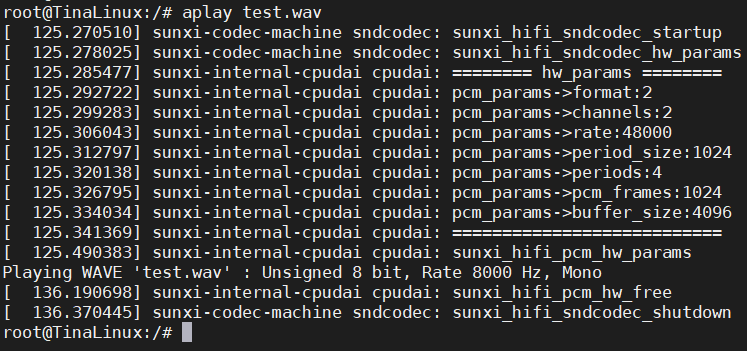

使用命令aplay +音频文件即可播放该文件,如:
root@TinaLinux:/# aplay test.wav
[  125.270510] sunxi-codec-machine sndcodec: sunxi_hifi_sndcodec_startup
[  125.278025] sunxi-codec-machine sndcodec: sunxi_hifi_sndcodec_hw_params
[  125.285477] sunxi-internal-cpudai cpudai: ======== hw_params ========
[  125.292722] sunxi-internal-cpudai cpudai: pcm_params->format:2
[  125.299283] sunxi-internal-cpudai cpudai: pcm_params->channels:2
[  125.306043] sunxi-internal-cpudai cpudai: pcm_params->rate:48000
[  125.312797] sunxi-internal-cpudai cpudai: pcm_params->period_size:1024
[  125.320138] sunxi-internal-cpudai cpudai: pcm_params->periods:4
[  125.326795] sunxi-internal-cpudai cpudai: pcm_params->pcm_frames:1024
[  125.334034] sunxi-internal-cpudai cpudai: pcm_params->buffer_size:4096
[  125.341369] sunxi-internal-cpudai cpudai: ===========================
[  125.490383] sunxi-internal-cpudai cpudai: sunxi_hifi_pcm_hw_params
Playing WAVE 'test.wav' : Unsigned 8 bit, Rate 8000 Hz, Mono
[  136.190698] sunxi-internal-cpudai cpudai: sunxi_hifi_pcm_hw_free
[  136.370445] sunxi-codec-machine sndcodec: sunxi_hifi_sndcodec_shutdown

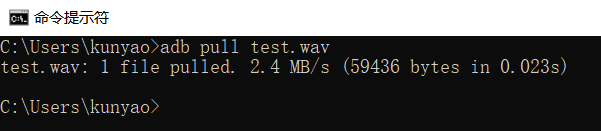

把文件拉到电脑上
我们可以通过adb将音频文件拉到电脑上查看。
adb pull test.wav

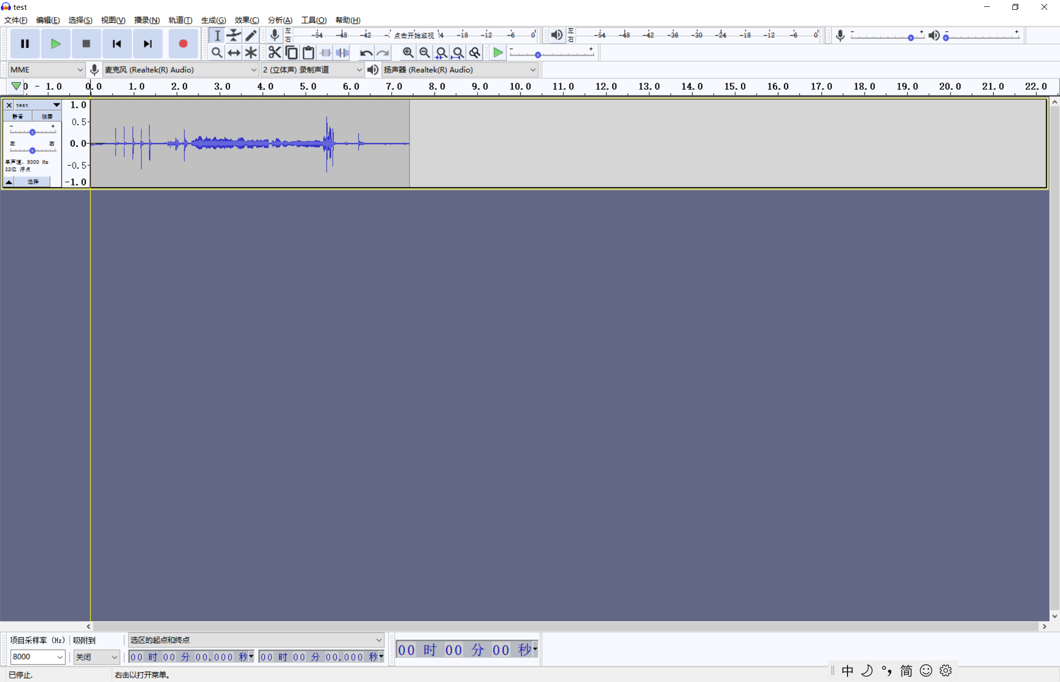

Audacity
查看音频文件可以使用音频处理软件,如Audacity。
这是一个常用的音频处理软件,免费,开源,遵循GNU协议,可以到网上搜索下载。Windows和Ubuntu版本均有。
image-20210108190102548

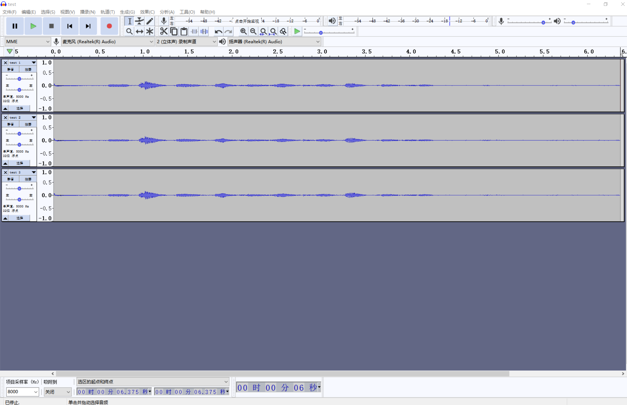

上图就是我们用Audacity打开刚刚录下的音频文件的样子。图中只有一个声道,如果是用三麦克风的阵列录得声音,我们可以看到有三个音轨。如果还有一路或者两路回路(AEC),我们一根可以看到四个或者五个音轨。
录三个声道
录三个声道可以使用命令:
arecord -D hw:audiocodec,0  -f S24_LE -c 3 test.wav
”-D:”代表设备,“-f”代表格式(采样深度和大小端),“-c”代表声道数。这里我们录了3个声道,如果3个声道的麦克风都是好的,拉到电脑用Audacity上查看可以看到如图所示的三个音轨:
