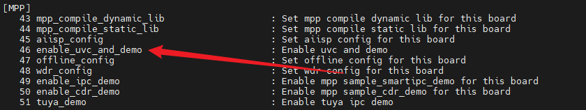

快速配置
v861/目录下运行quick_config
quick_config
可见 enable_uvc_and_demo 选项,输入序号并回车。然后显示是否同意执行配置,输入 Y 回车
接下来 SDK 会自动配置该功能,结束后编译并打包固件。

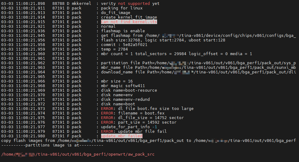

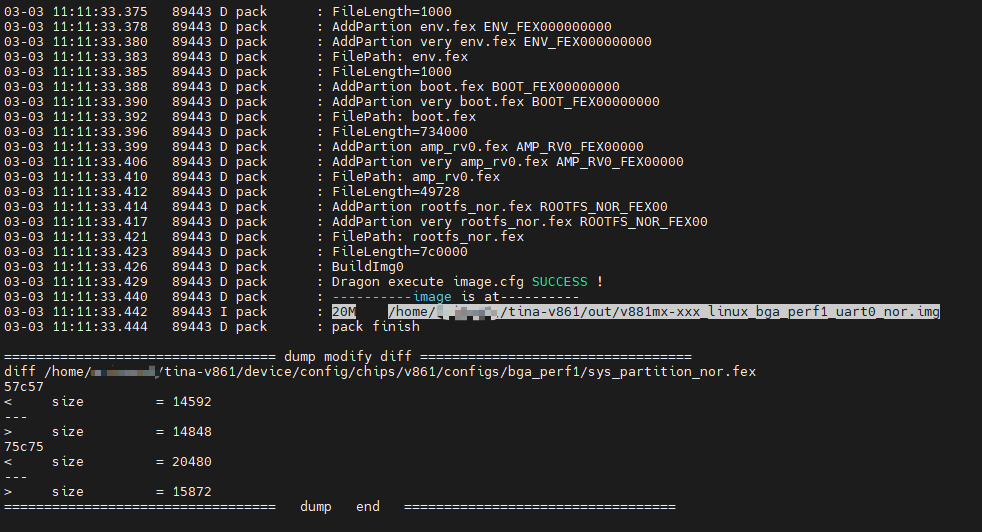

打包可能会失败,出现如下提示
解决方法: 执行 auto_update_partition,一路选择默认配置,会自动更新分区表并打包固件

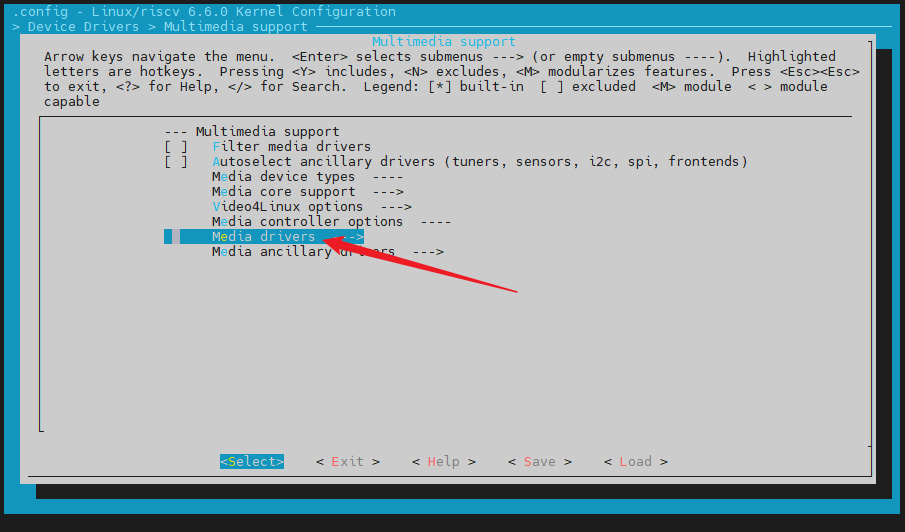

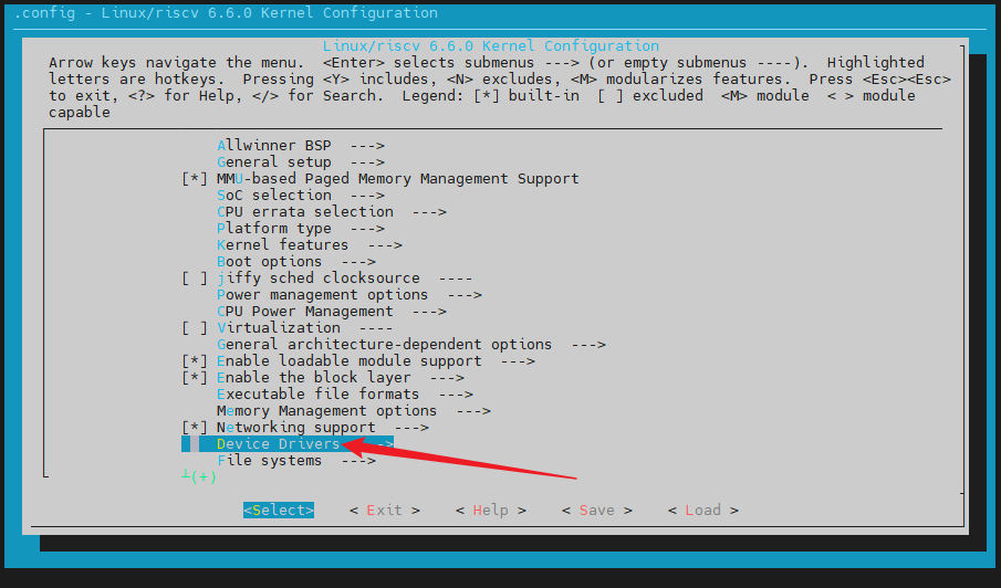

  • 内核配置
v861/目录下运行m kernel_menuconfig
m kernel_menuconfig

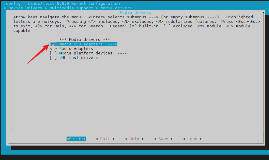

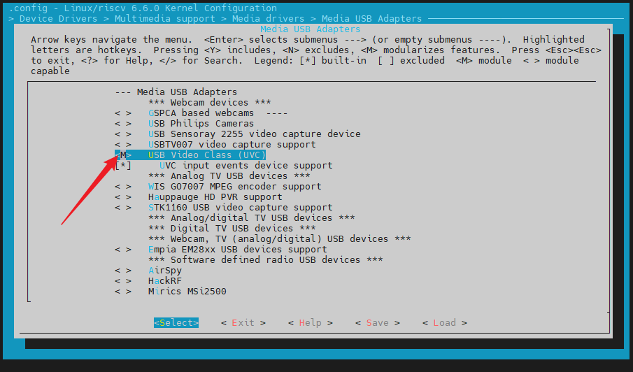

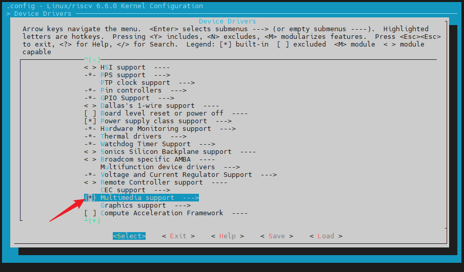

Device Drivers --->
{*}Multimedia support --->
Media drivers --->
[*]Media USB Adapters --->
<M>USB Video Class (UVC)
进入Device Drivers
Y勾选Multimedia support
Y勾选Media drivers
Y勾选Media USB Adapters
M勾选USB Video Class
回到kernel_menuconfig最初页

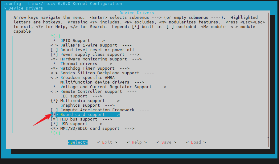

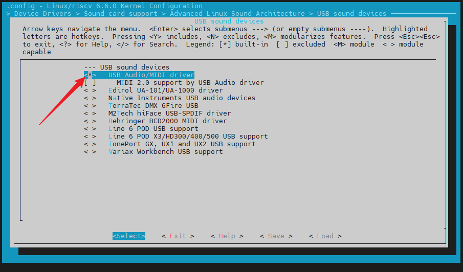

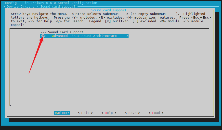

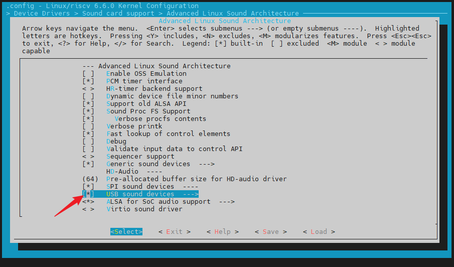

Device Drivers --->
<*>Sound card support --->
<*>Advanced Linux Sound Architecture --->
[*]USB sound devices --->
<*>USB Audio/MIDI driver
进入Device Drivers
Y勾选Sound card support ,并回车进入
Y勾选Advanced Linux Sound Architecture,并回车进入
Y勾选USB sound devices ,并回车进入
Y勾选USB Audio/MIDI driver

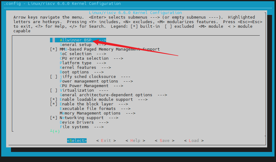

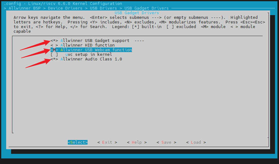

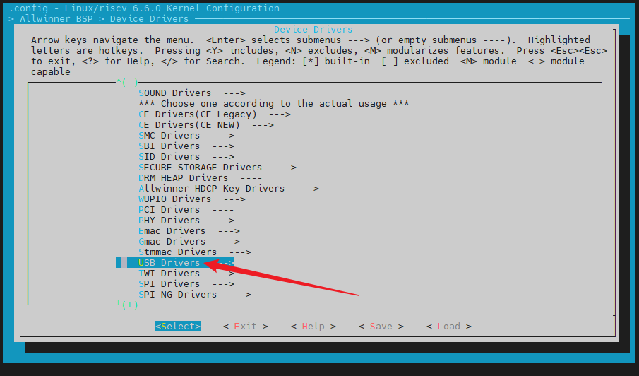

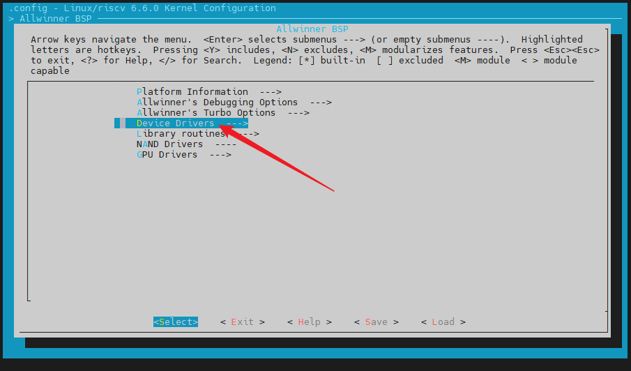

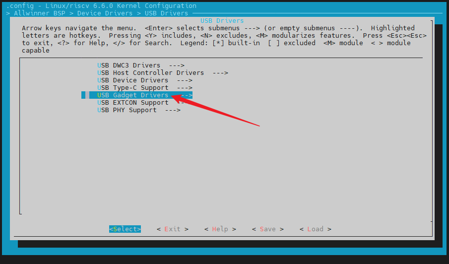

Allwinner BSP --->
Device Drivers --->
USB Drivers --->
USB Gadget Drivers --->
<*>Allwinner USB Gadget support
<M>Allwinner USB Webcam function
<*>Allwinner Audio Class 1.0
进入Allwinner BSP
进入Device Drivers
进入USB Drivers
进入USB Gadget Drivers
Y勾选Allwinner USB Gadget support
M勾选Allwinner USB Webcam function
Y勾选Allwinner Audio Class 1.0

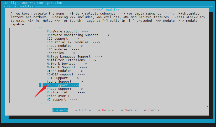

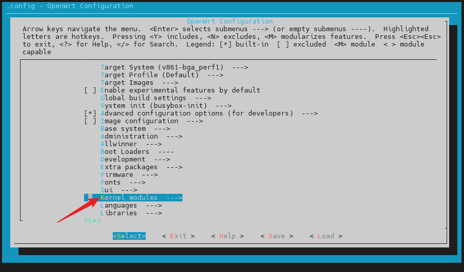

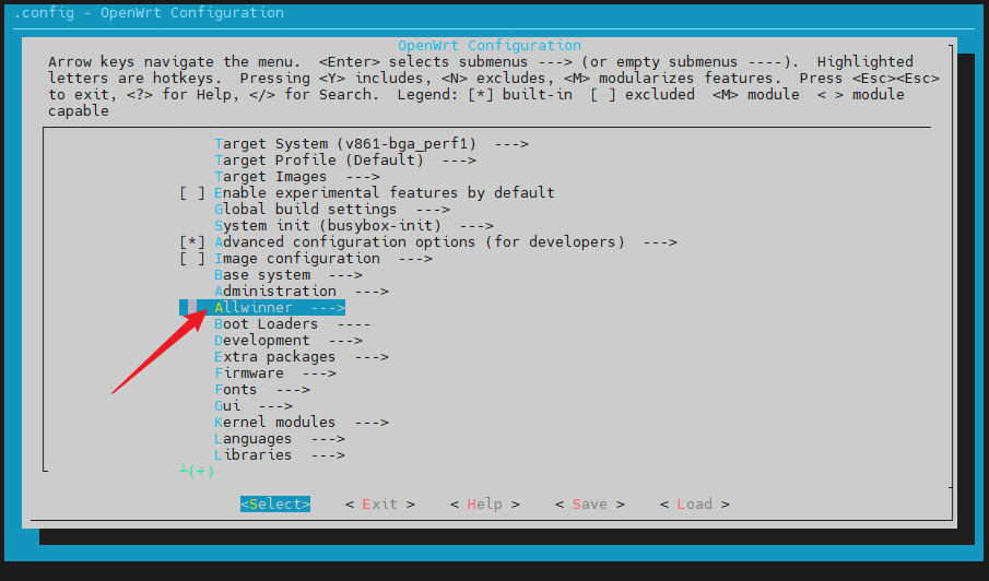

  • Tina配置
v861/目录下运行m menuconfig
m menuconfig

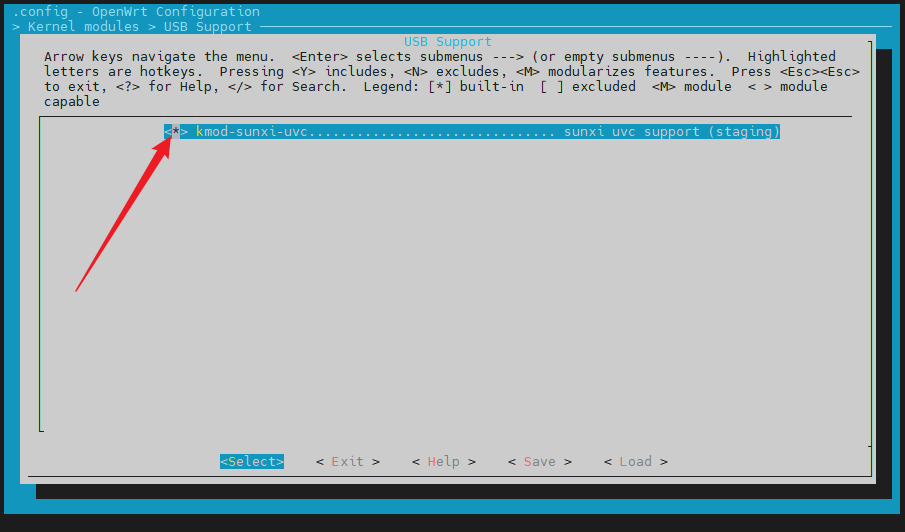

Kernel modules --->
USB Support --->
<*> kmod-sunxi-uvc
进入Kernel modules
进入USB Support
Y勾选kmod-sunxi-uvc

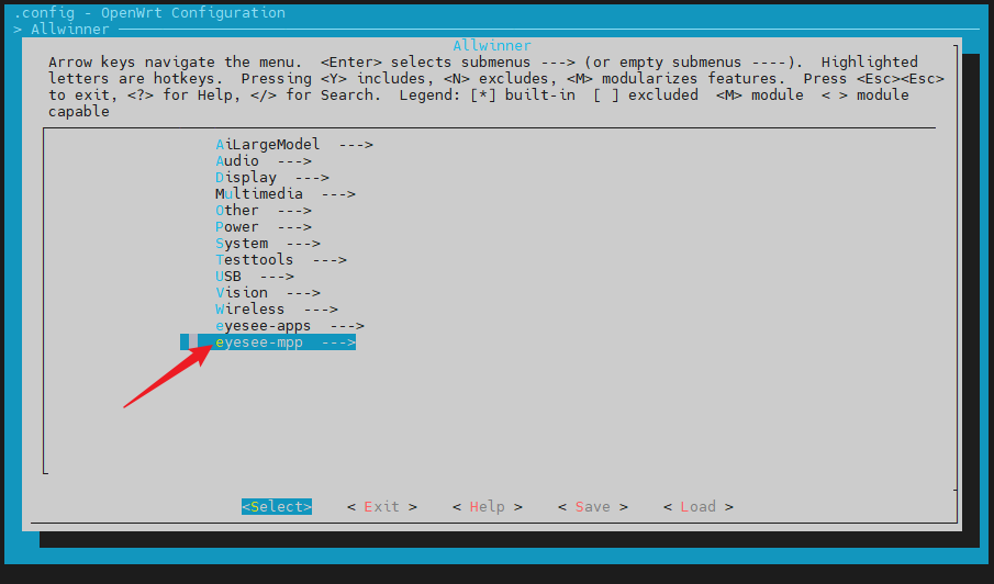

回到menuconfig最初页

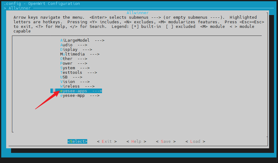

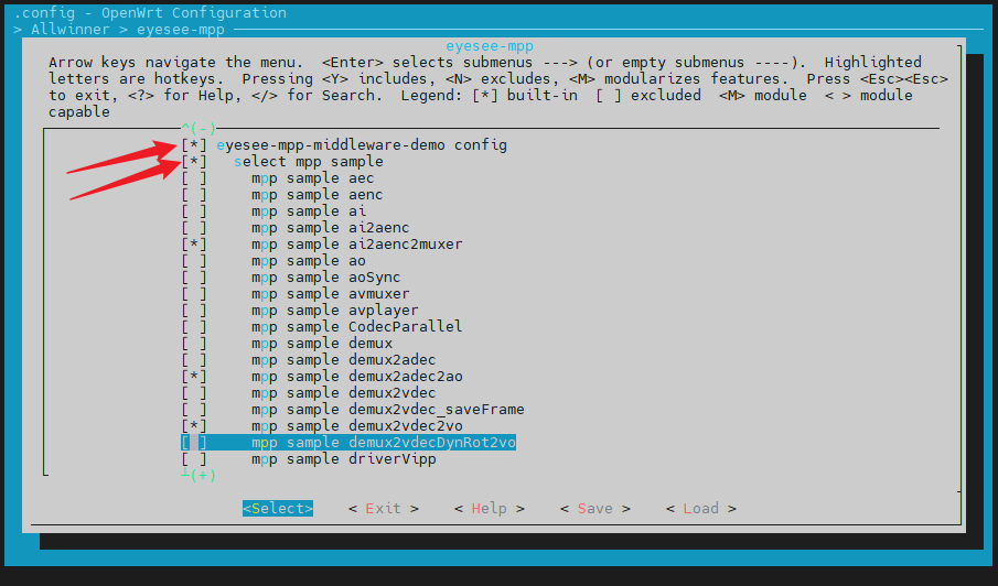

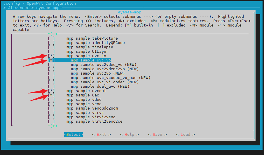

Allwinner --->
eyesee-mpp --->
[*] eyesee-mpp-middleware-demo config
[*] select mpp sample --->
[*] sample uvc in
[*] sample uvc_vo(要先勾选mpp sample uvc in才会出现这一项)
[*] sample uvcout
[*] sample uac
进入Allwinner
进入eyesee-mpp
Y勾选eyesee-mpp-middleware-demo config
Y勾选select mpp sample
Y勾选mpp sample uvc in
Y勾选mpp sample uvc_vo(要先勾选mpp sample uvc in才会出现这一项)
Y勾选mpp sample uvcout
Y勾选mpp sample uac
  • 这四个sample可以根据需要来开
回到menuconfig最初页
Allwinner --->
eyesee-apps --->

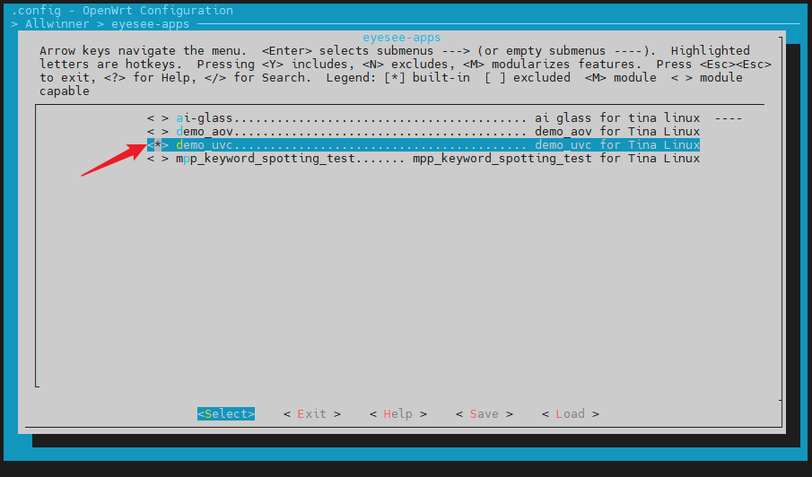

<*> demo_uvc
进入Allwinner
进入eyesee-apps
Y勾选demo_uvc

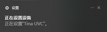

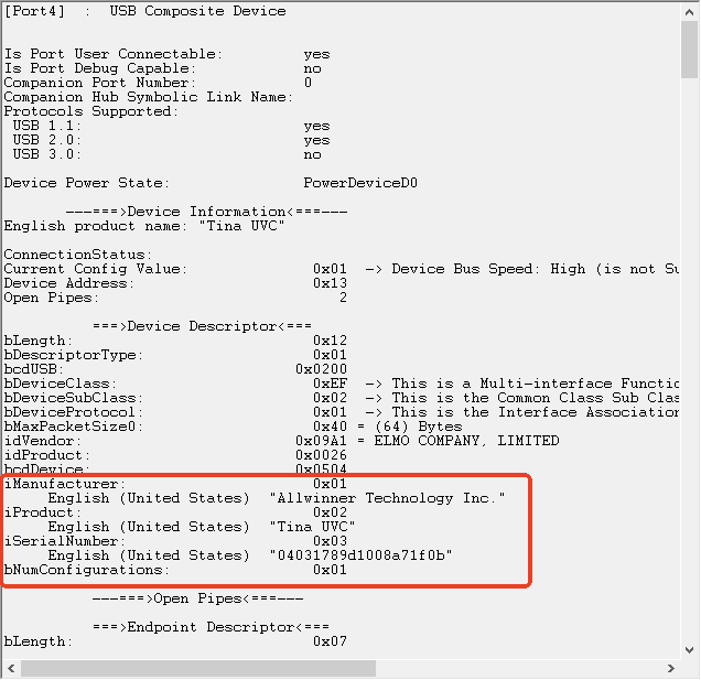

输入 setusbconfig uvc 即可配置 V 为 UVC 设备,可以看到提示新设备 Tina UVC
setusbconfig uvc
可能会有这种报错,可以先不用理会
运行后,ls /dev/video*可以看到出现了新的 video1 节点
ls /dev/video*
PC 可以看到提示新设备 Tina UVC(也可能不提示,可以进设置,设备看看有没有Tina UVC设备)

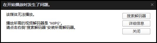

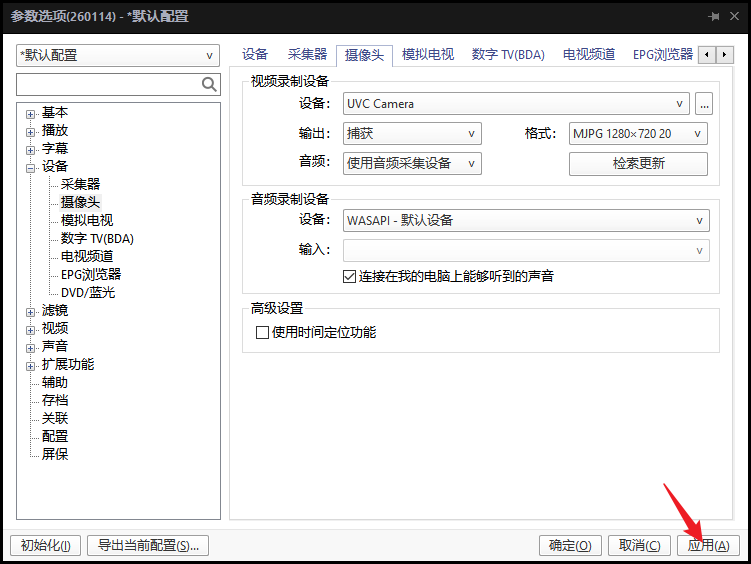

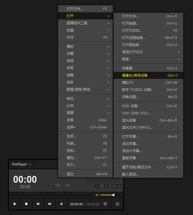

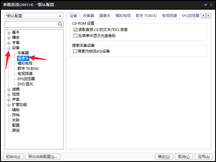

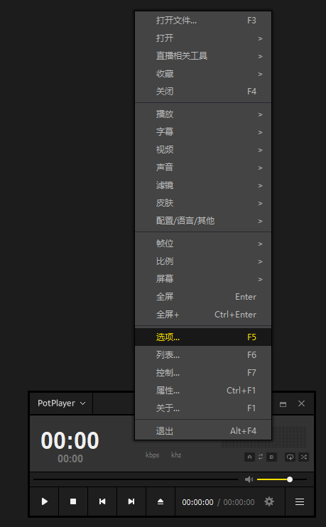

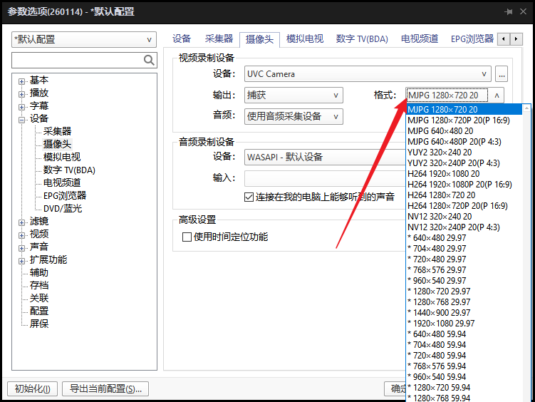

PC端打开PotPlayer,右键-->选项-->设备-->摄像头-->格式 选择对应格式及分辨率角打开设备。
右键-->选项
设备-->摄像头
选择格式
应用并确定
右键-->打开-->摄像头/其他设备
注意,此时应该不会有画面,还有可能有如下提示,这是正常的

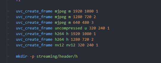

配置支持格式与支持分辨率
修改setusbconfig脚本,路径如下:
platform/allwinner/usb/setusbconfig/setusbconfig
找到enable_uvc函数,修改如下代码格式为:
uvc_create_frame <format> <flag> <width> <height> <index>
uvc_create_frame mjpeg m 1920 1080 1
uvc_create_frame mjpeg m 1280 720 2
uvc_create_frame mjpeg m 640 480 3
uvc_create_frame uncompressed u 320 240 1
uvc_create_frame h264 h 1920 1080 1
uvc_create_frame h264 h 1280 720 2
uvc_create_frame nv12 nv12 320 240 1
修改时注意,需要按照如上代码配置format、flag。相同格式下index从1开始递增,每个格式的 index 都是独立的。

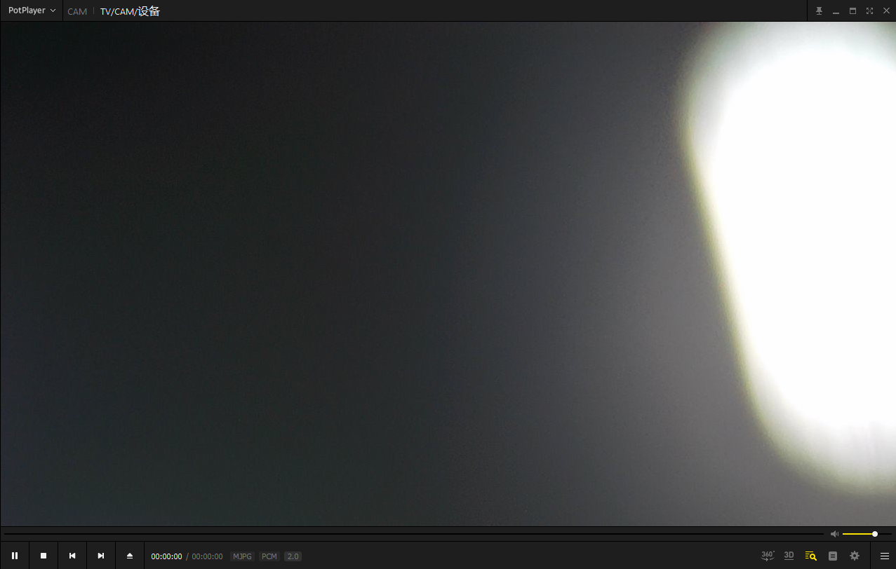

使用测试用例加入-b 1 参数。
./sample_uvcout -D 0 -d 1 -B 10 -b 1 &
右键-->打开-->摄像头/其他设备
可见potplay上有画面

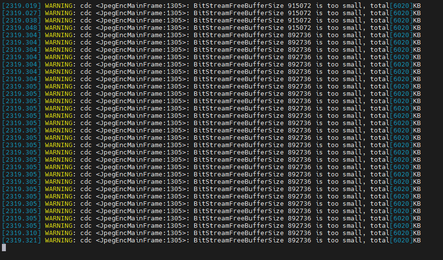

串口调试信息如下

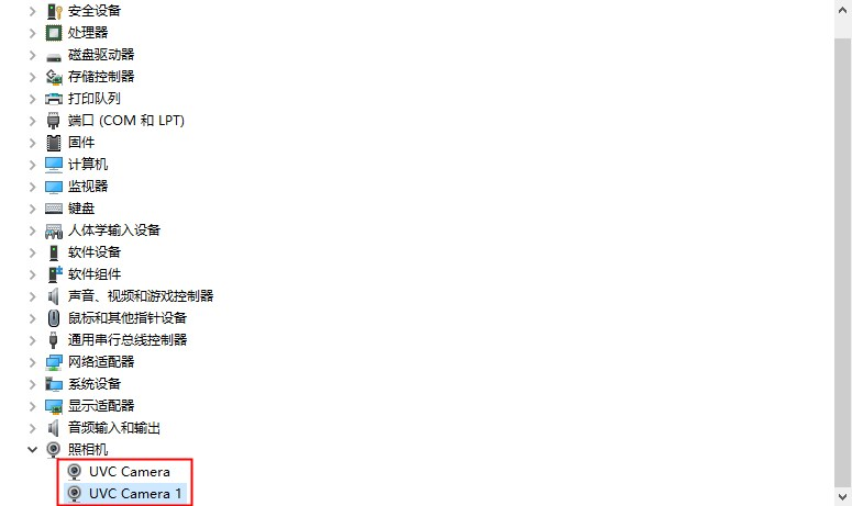

双路UVC设备

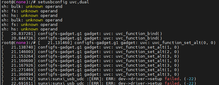

使用如下指令初始化双路UVC设备。
setusbconfig uvc,dual
使用如下指令测试:
sample_uvcout -D 0 -d 1 -B 10 -enable_dual 1 -D 4 -d 2 -B 10 &

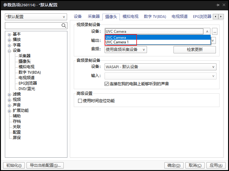

接入Windows PC打开设备管理器可以看到两个UVC设备,使用potplayer打开对应的UVC设备进行预览。

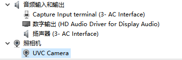

UVC 和 UAC1 复合设备的使用
初始化设备
勾选驱动后进行编译打包烧录,小机端串口输入:
setusbconfig uvc,uac1
切换到UVC+UAC1复合设备。
接入Windows PC后设备管理器会显示出UVC(UVC Camera)+UAC1(AC Interface)设备。(HD Audio 这个是电脑显示屏的,可以无视)

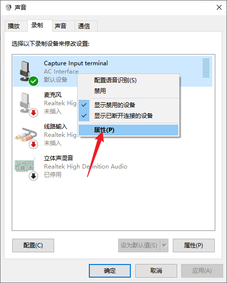

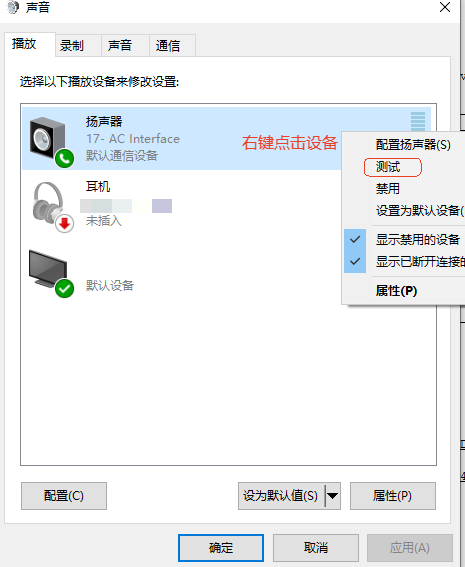

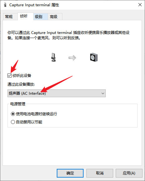

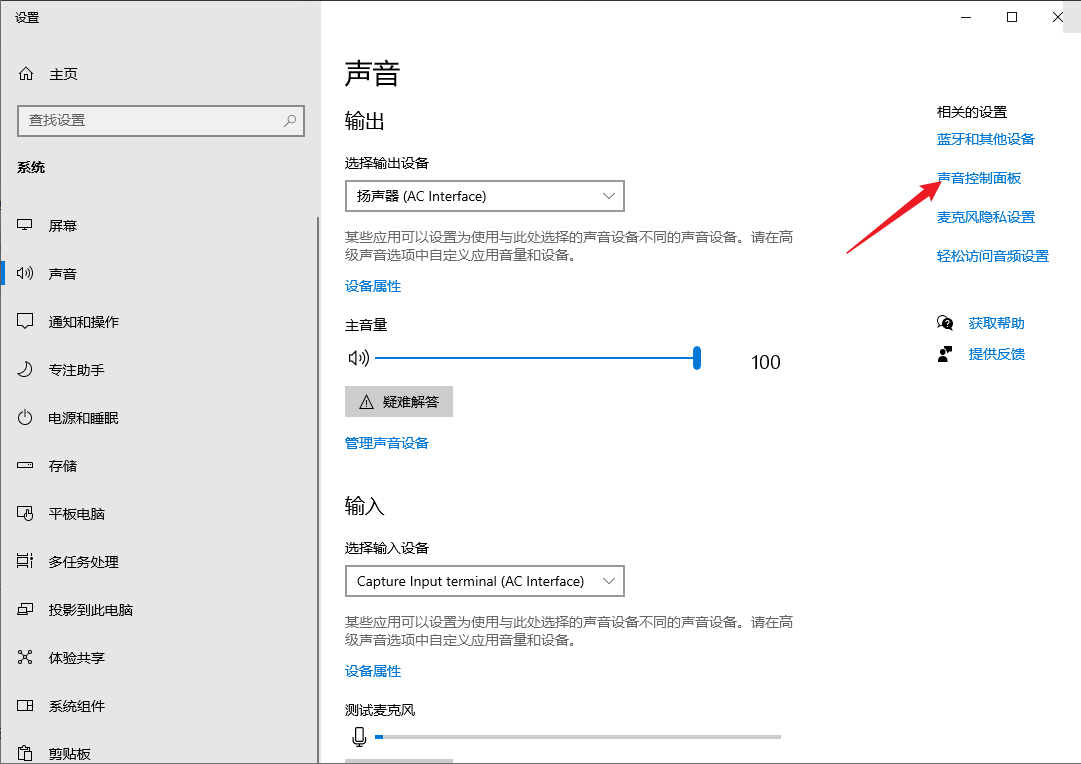

Windows PC可在声音设置界面进行测试验证:
UAC1播放测试:
UAC1采集测试:
使用侦听功能进行测试验证。

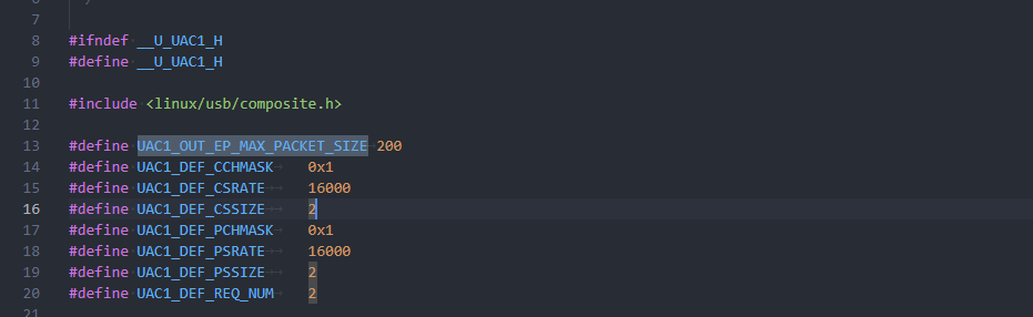

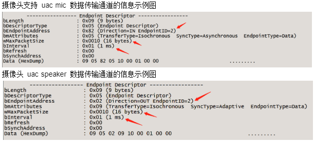

某些门锁猫眼板厂商会对 UAC wMaxPacketSize 大小有要求,这就需要对应修改。
例如在某某厂商某型号猫眼板,对模组的 UAC wMaxPacketSize 要求16 bytes。
在 V861上 wMaxPacketSize 在UAC1驱动中进行修改,如下图修改为16 bytes。
文件路径:
bsp/drivers/usb/gadget/function/u_uac1.h
修改 UAC1_OUT_EP_MAX_PACKET_SIZE 宏定义的数值。
#define UAC1_OUT_EP_MAX_PACKET_SIZE     16

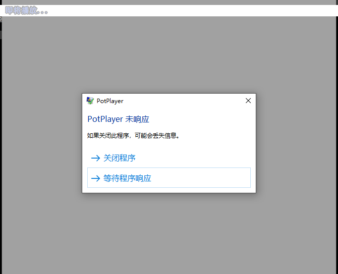

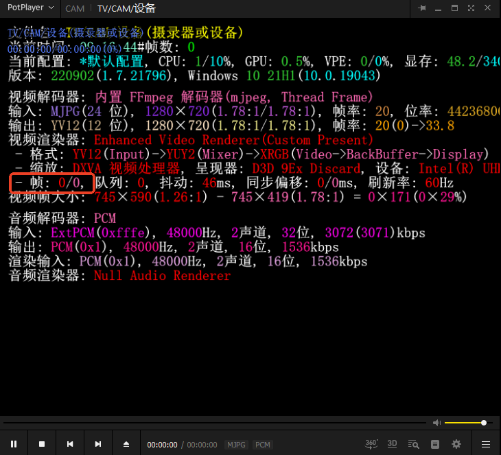

PotPlayer 打开设备卡住最后显示未响应
问题现象:
问题分析:出现这个现象说明 UVC 设备未响应,那么大概率为小机端没有跑 UVC 测试用例或者打开的 video 节点不对。
问题排查步骤:
检查是否运行了 UVC 测试用例,是否 UVC 测试用例报错退出。
UVC设备节点也是 /dev/video 节点与VIPP的节点类似,需要分清楚。可以参考以下几种方式确认打开的UVC节点是否正确。
  1. 执行 setusbconfig uvc 前后查看生成的video节点,如下图 UVC 节点为 /dev/video1

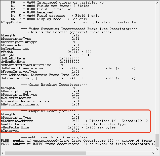

问题分析:V861 支持两种UVC传输模式,每个模式都需要配置对应的UVC设备描述符并且上层处理UVC协议逻辑也要对应选择。所以针对该问题需要对UVC设备描述符和上层应用逻辑一起分析。
问题排查步骤:
  1. 接入PC使用 usbview 工具查看UVC设备描述符配置是否正确,如下图说明该设备为UVC BULK传输模式。
  1. UVC驱动通过驱动模块参数判断是否要配置为BULK模式,可根据如下来确认。
# 1代表UVC BULK模式
root@(none):/# cat /sys/kernel/config/usb_gadget/g1/functions/uvc.usb0/streaming_bulkep
# 0代表UVC ISOC模式
