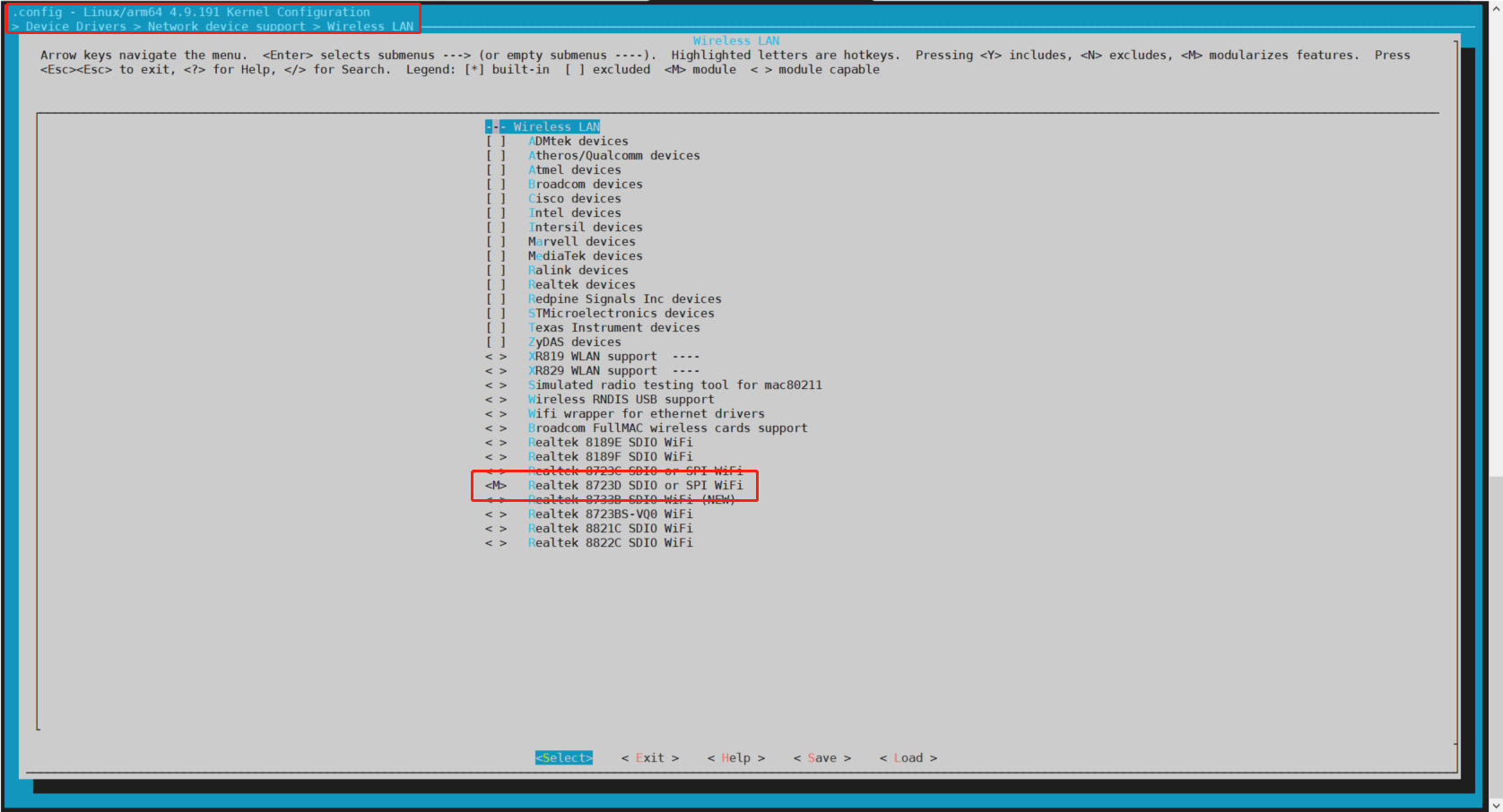

然后make kernel_menuconfig配置内核:
进行无线模组配置选项:
Device Drivers > Network device support > Wireless LAN
可以看到当前选择的模组是Realtek 8723D
image-20210115102540517
*表示编译成模块,可以在启动的时候实用启动脚本加载,<*>表示编译到内核。

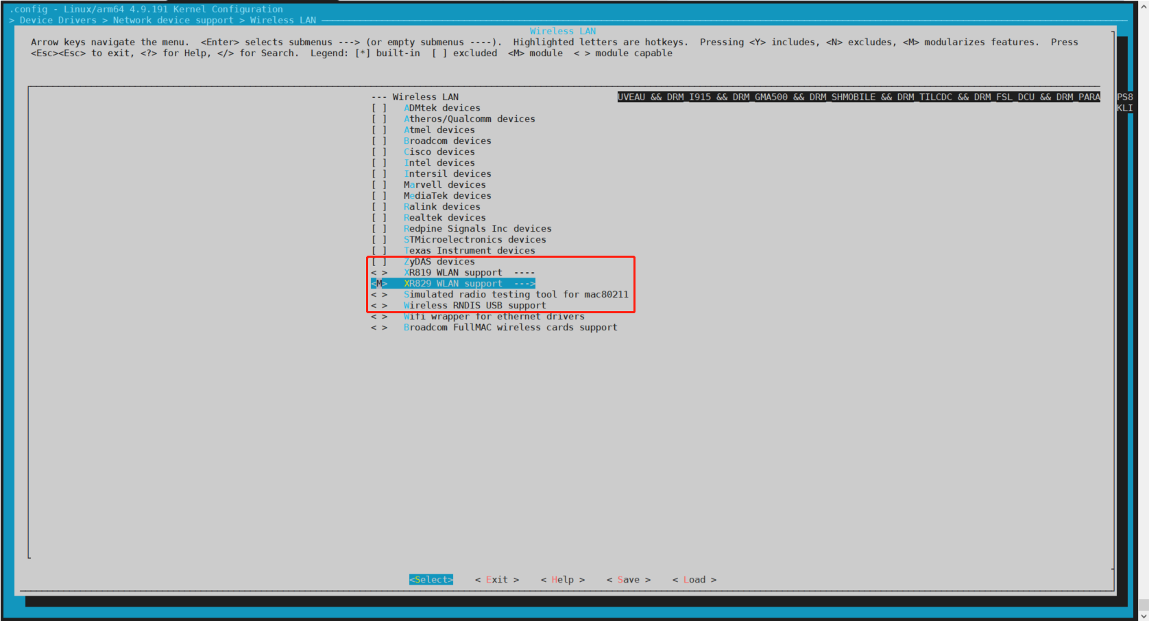

我们将Realtek 8723D反选,并选上XR829:
image-20210115103709170

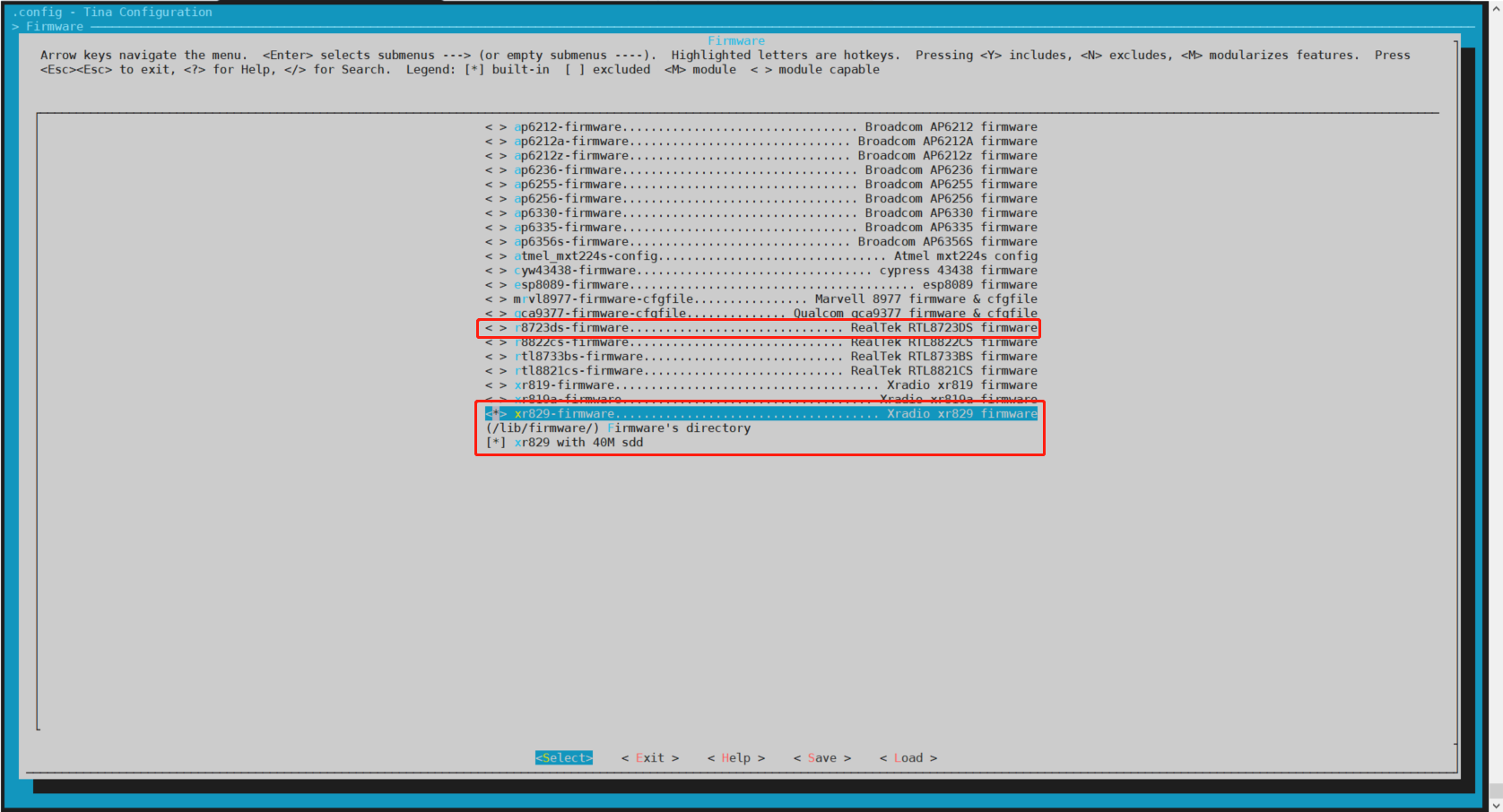

make menuconfig
Firmware
进入Firmware目录,反选r8723ds-firmware,并选上xr829-firmware和xr829 with 40M sdd。xr829 with 40M sdd意思是XR829采用40MHz的外挂晶振。
<*> xr829-firmware..................................... Xradio xr829 firmware
[*] xr829 with 40M sdd
image-20210115104249617

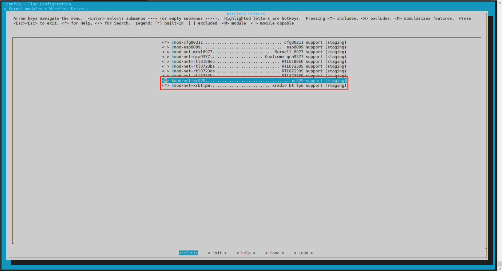

Wireless Driver
进入Kernel modules > Wireless Driver,反选kmod-net-rtl8723ds,并选上kmod-net-xr829kmod-net-xrbtlpm,意思是启动的时候加载xr829模块。
image-20210115140853799

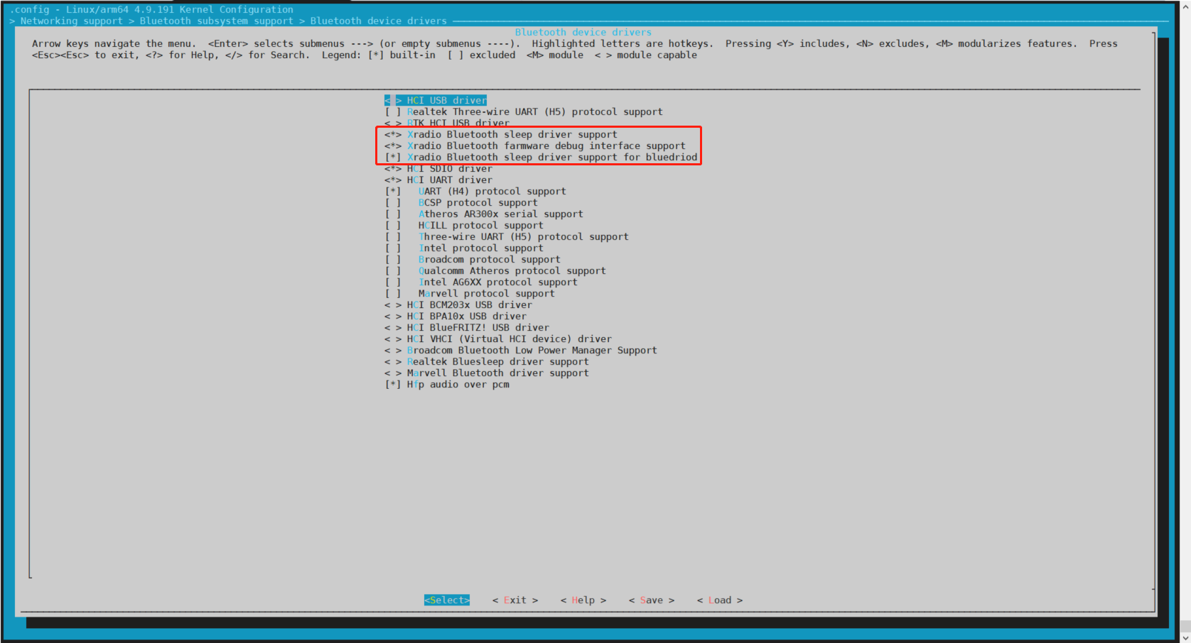

make kernel_menuconfig内核配置选上:
Networking support > Bluetooth subsystem support > Bluetooth device drivers
<*> Xradio Bluetooth sleep driver support
<*> Xradio Bluetooth farmware debug interface support
[*] Xradio Bluetooth sleep driver support for bluedriod
image-20210115182642462
