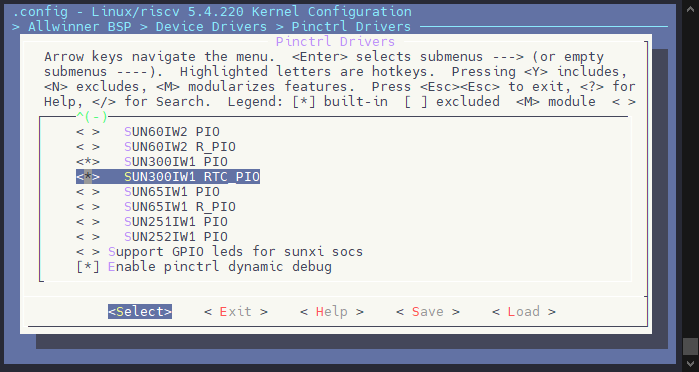

模块配置
驱动配置
Allwinner BSP --->
Pinctrl Drivers --->
<*> Pinctrl Support for Allwinner SoCs
<*> SUN300IW1 PIO
<*> SUN300IW1 RTC_PIO
