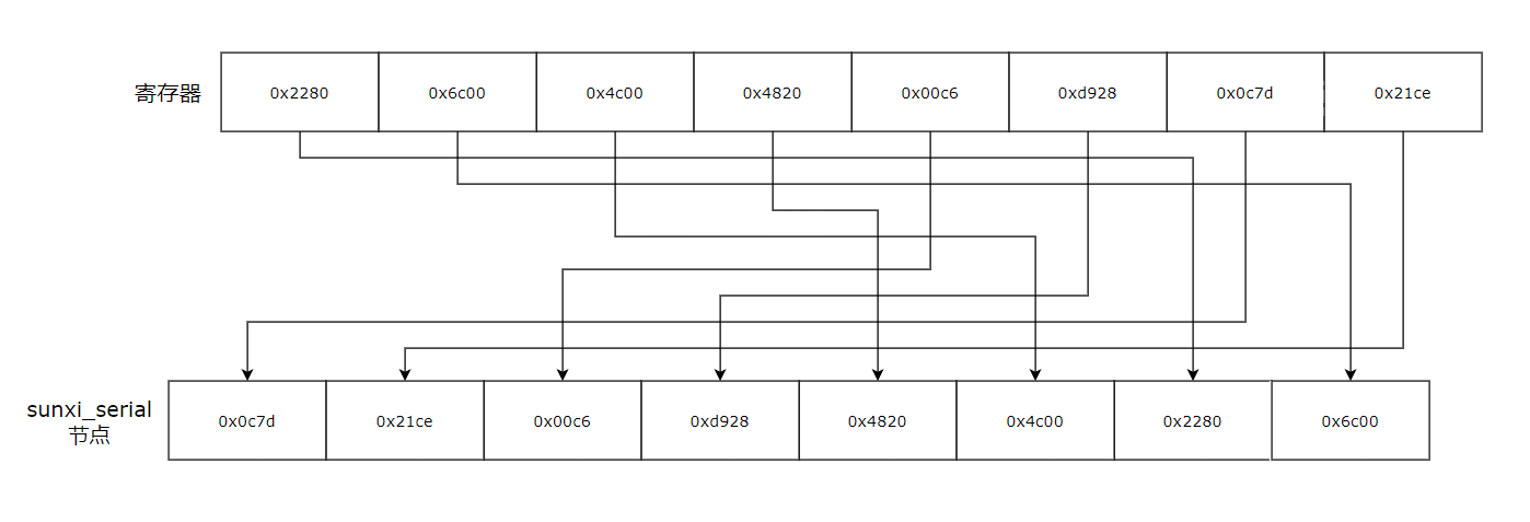

通过寄存器读出来的 Sunxi Serial 排布方式与 SYSFS 读出的有排布差异,转换方式如下:
sunxi_serial[0] = sunxi_soc_chipid_reg[3];
sunxi_serial[1] = sunxi_soc_chipid_reg[2];
sunxi_serial[2] = sunxi_soc_chipid_reg[1];
sunxi_serial[3] = sunxi_soc_chipid_reg[0];
