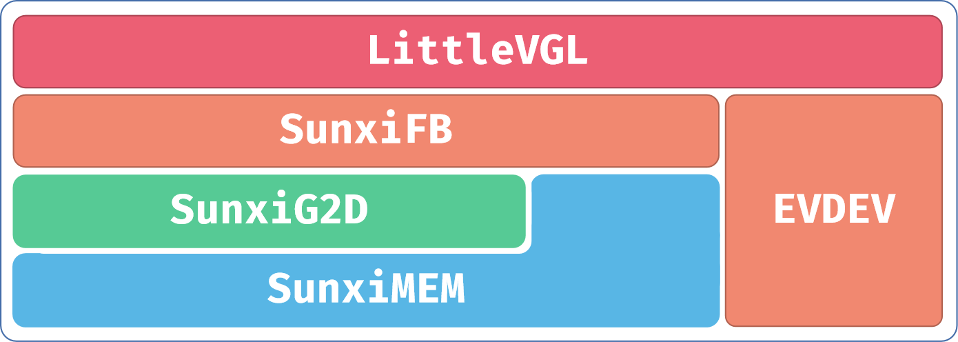

LVGL 源码位于 platform/thirdparty/gui/lvgl-8, 其框架如图:
image-20220704155816774
