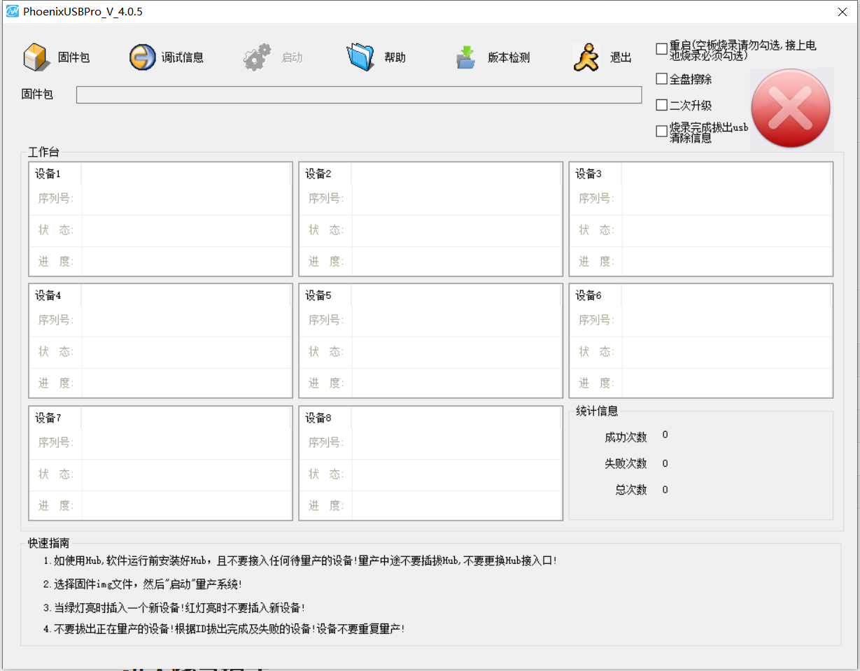

(3) )PhoenixUSBpro: 8 lanes PhoenixSuit. It is suitable for mass production in production lines. . (As shown below)

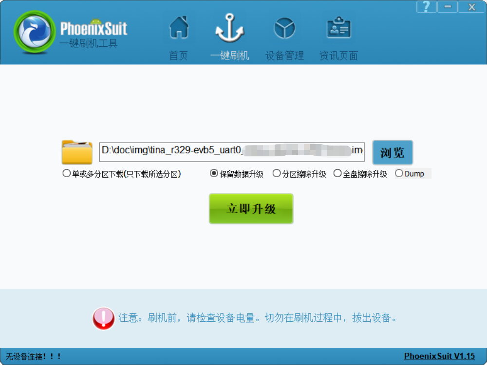

PhoenixSuit Use
The following mainly introduces the method of flash with PhoenixSuit. The flash method of LiveSuit and PhoenixUSBpro is similar.
Download PhoenixSuit:PhoenixSuit
Before using PhoenixSuit, you need to install the driver at the same time: Allwinner USB Driver
*Enterprise developers will also install the Allwinner USB driver when installing APST, so there is no need to install it separately
Specific steps are as follows:
(1) Open PhoenixSuit, when the device is powered on and connected to the PC, PhoenixSuit will prompt to recognize the device;
(2) Click One-click flash-browse to select the firmware to be flashed;
(3) Click Upgrade now, then a restart command will be sent to the device through USB, the device will restart with the programming logo, and enter the flash mode in the restart stage;
(4) When the device returns to boot, it will be automatically programmed, and you can see that the progress bar of PhoenixSuit is moving;
(5) After the flash is successful, the device restarts.

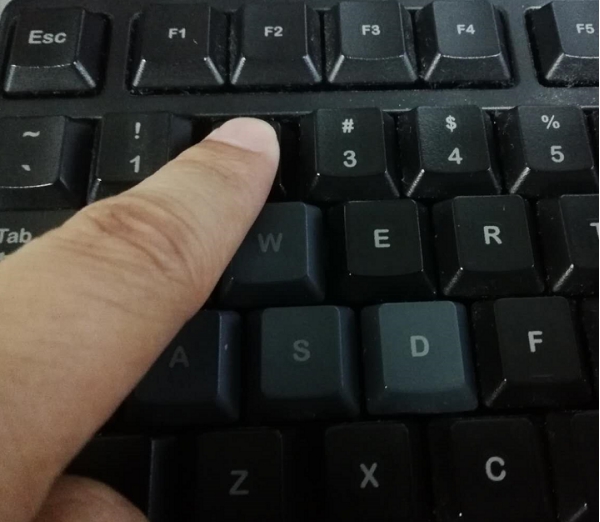

Press PC Button "2"
During the power-on process of the device, press and hold "2" on the PC keyboard on the serial terminal to continuously input "2". When the device starts up, if the input of "2" is detected, it will automatically jump to the flash mode. As shown in the figure (it is really pressing the "2" of the keyboard, many new developers do not understand this hidden operation):

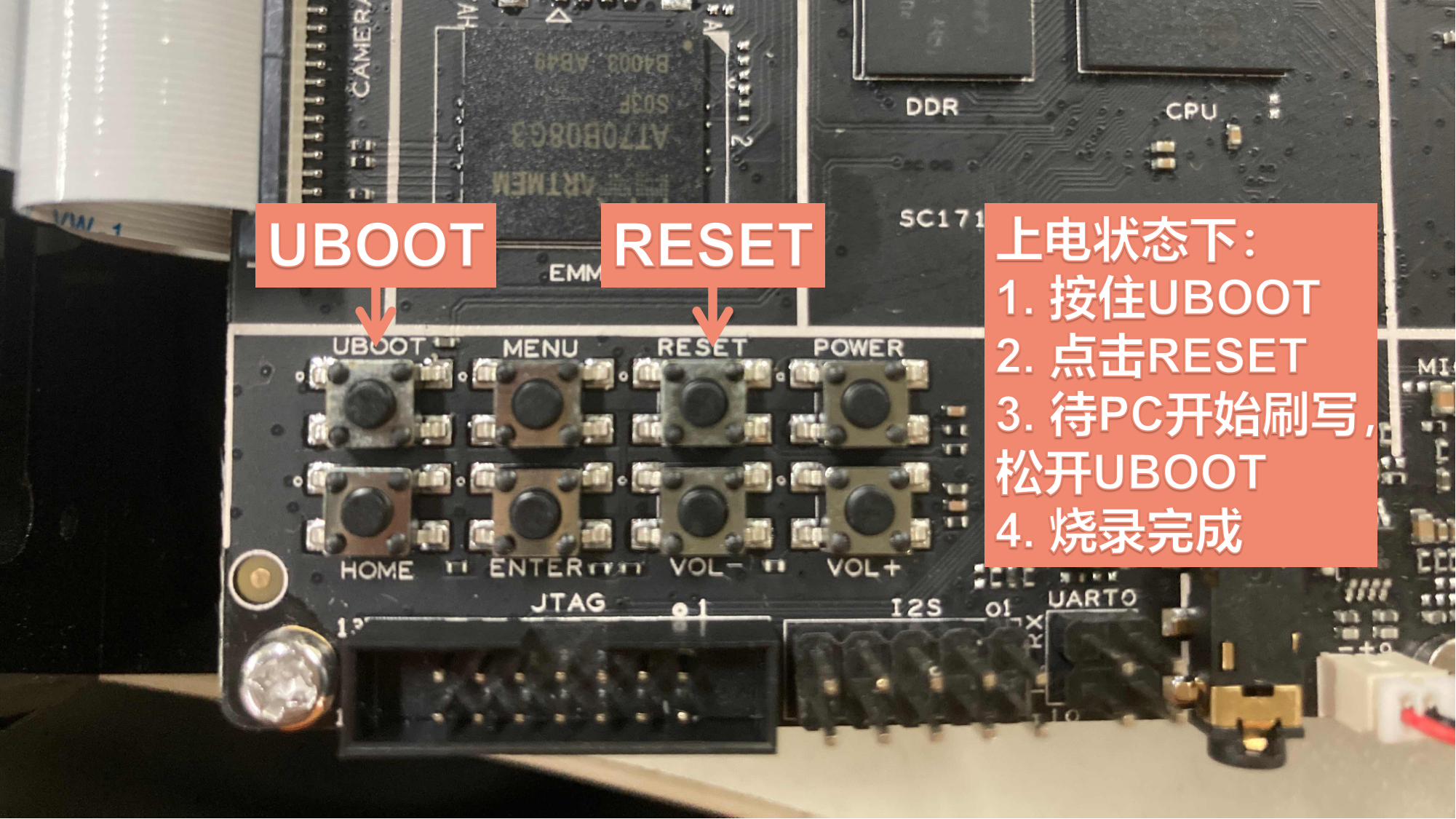

Press Board Button "UBOOT"
In the power-on state, press and hold UBOOT first, then click the RESET button, keep UBOOT unreleased, and release it after the PC starts to flash to force it into the flash mode.

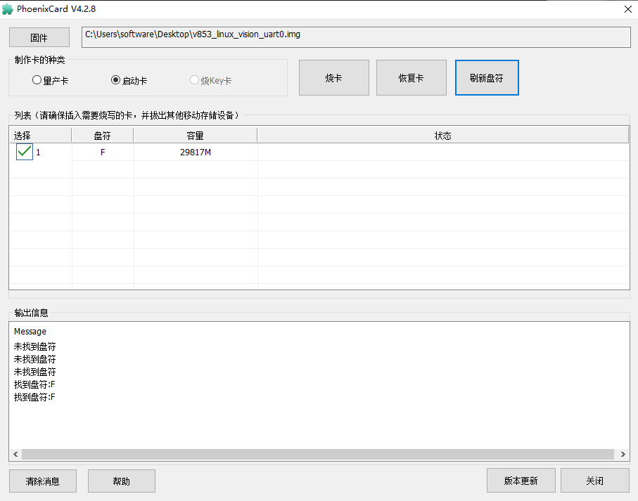

PhoenixCard Use
Prepare an SD card of suitable size and insert it into the computer. Select the firmware that needs to be flashed, and select the type of production card:
- Mass production card: Make a card for flashing firmware. After the system starts, the SD card will write firmware to the onboard eMMC storage.
- Boot card: Boot the firmware directly from the SD card (usually select the boot card)
After selecting, check whether the SD card to be burned is correct, and click flash card.
