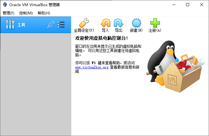

Oracle VM VirtualBox
Oracle VM VirtualBox is a powerful cross-platform open source virtual machine software. There are many tutorials and materials about using this software to install Ubuntu20.04 virtual machine on the Internet, so I won't go into details here, but I will focus on some points that need attention.
Download and Install
Official download link: https://www.virtualbox.org/
Oracle VM VirtualBox official website download and installation tutorial: https://blog.csdn.net/kaixuansui/article/details/89334859/

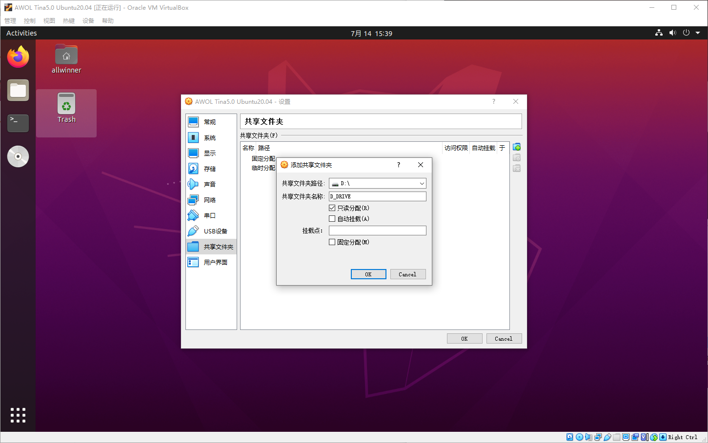

How to implement a shared folder:
The reference link for creating a shared folder in VirtualBox is as follows: http://www.koudaipe.com/funny/1002.html
Shared folder After sharing a folder, it may not be possible to operate due to permission issues. You need to do the following:
sudo usermod -aG vboxsf $(whoami)
*Note: Replace $(whoami) with your Ubuntu username

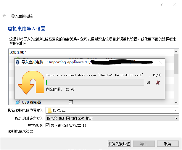

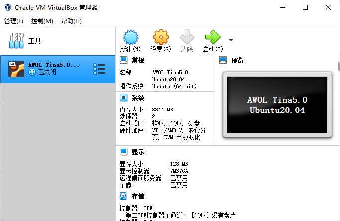

First install a virtual machine software, the free and open source VirtualBox virtual machine is recommended. Of course, VMWare WorkStation, ESXi and other virtual machine software are also supported. Here VirtualBox is used as an example.
Download the virtual machine file, a Ubuntu20.04.ova file, and double-click it to open it.

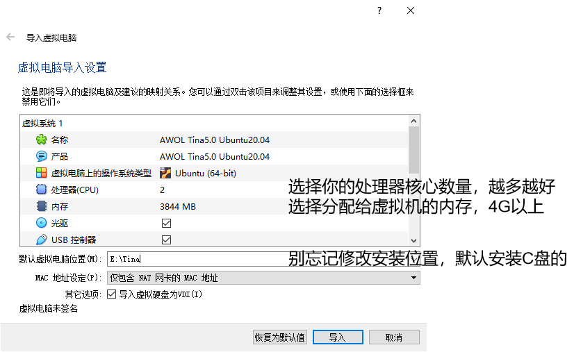

Enter this configuration page and configure the virtual machine parameters as shown in the figure.
Click Import to start importing (the virtual machine is larger and may be slower)

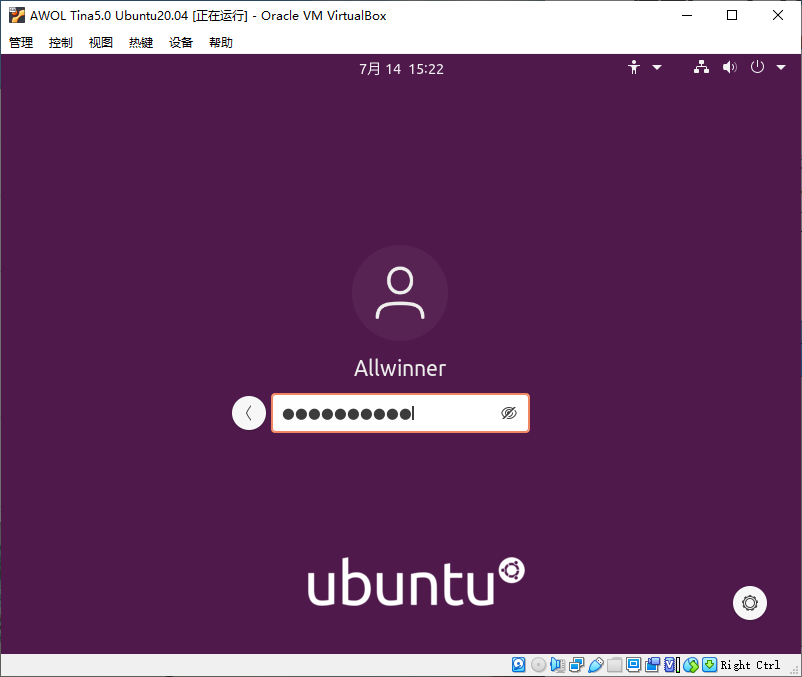

Start after importing
虚拟机使用说明
Virtual Machine Instructions

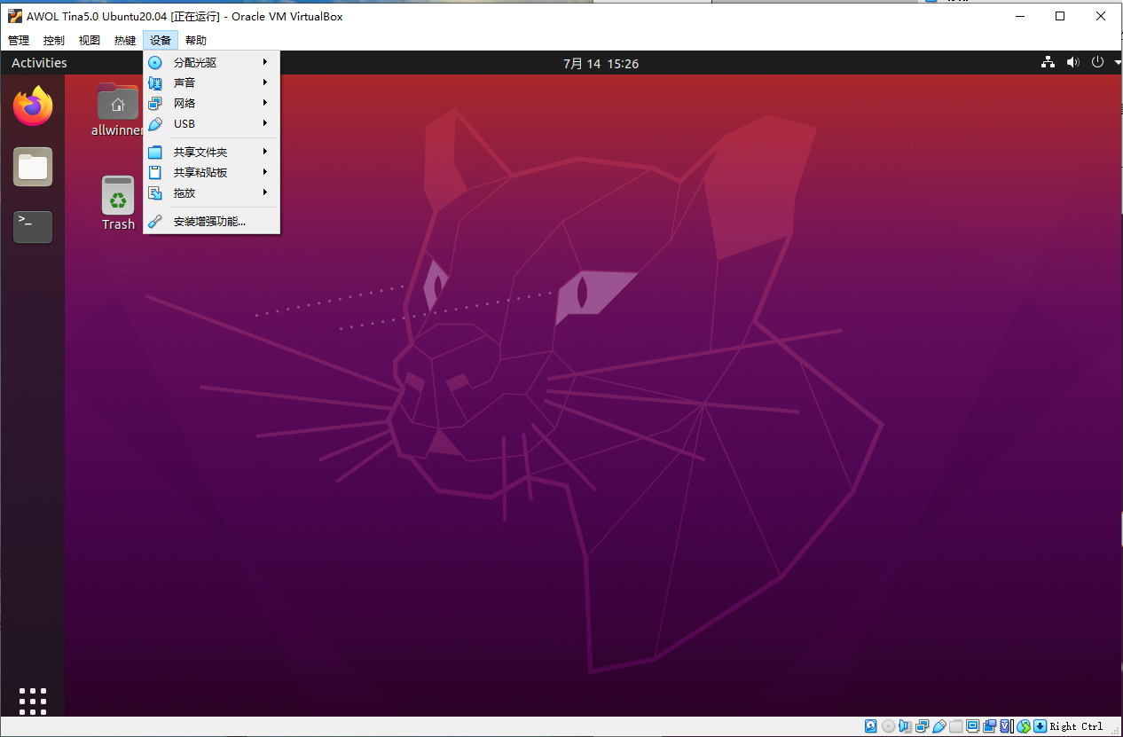

The virtual machine is installed, but there are still enhancements that need to be configured, such as copying of host and virtual machine files, shared folders, shared pasteboards, and more.
We first start the virtual machine and enter the password Pass123456 to enter the system.

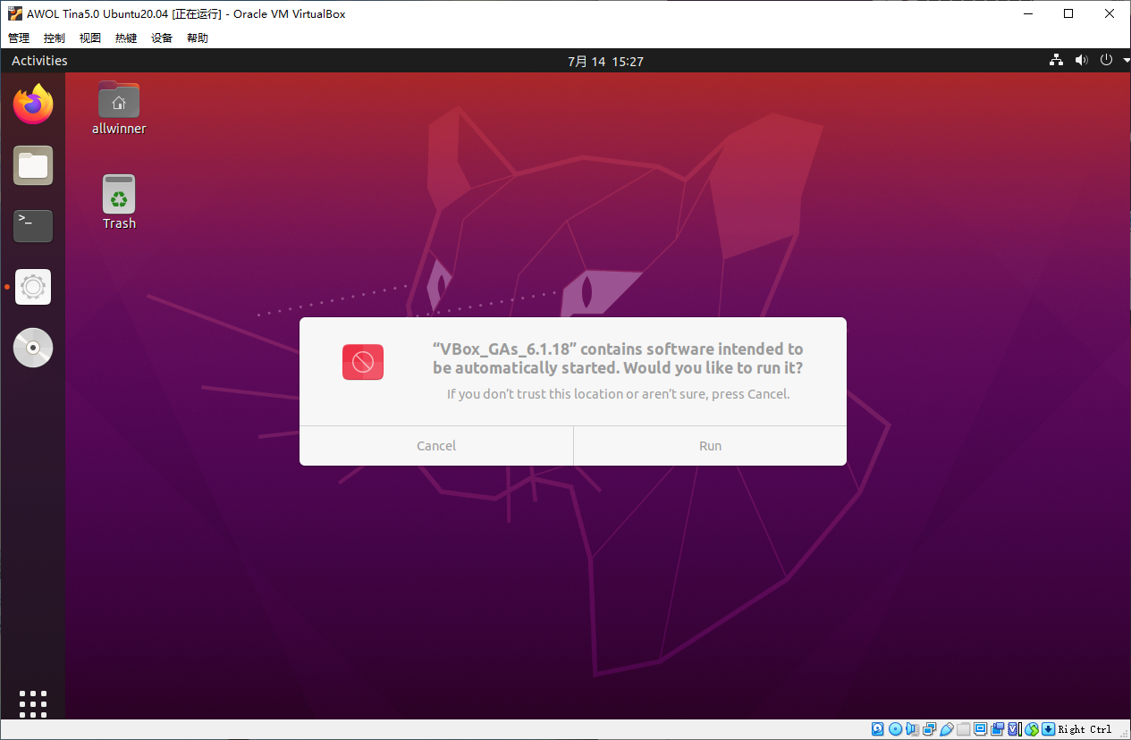

Go to Device -> Install Enhancements click and install the enhancements.

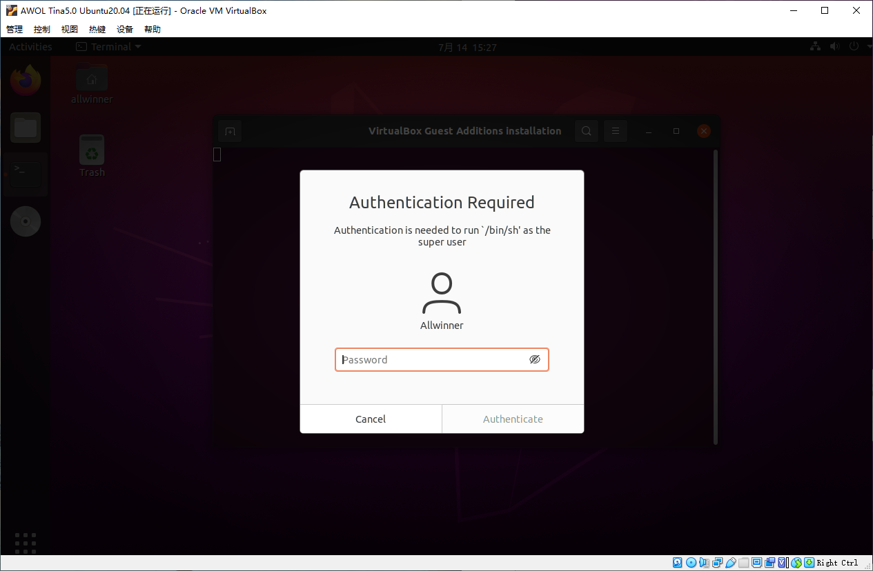

Click Run

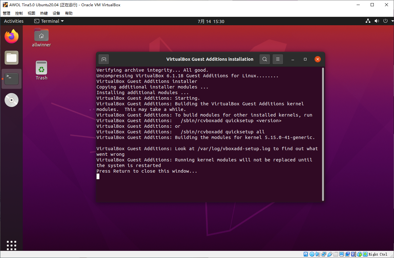

Input password Pass123456
Installation is complete, press enter

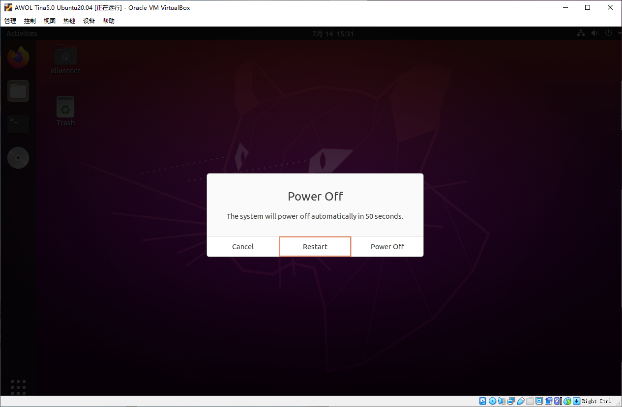

Restart the virtual machine

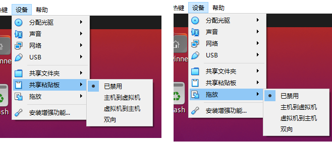

Set shared pasteboard to bidirectional, drag and drop bidirectional
You can also set up shared folders
