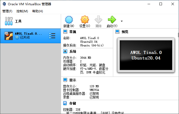

Prepare the Build Environment
Here we use the virtual machine installed in the Compile Environment Configuration chapter for demonstration. This virtual machine has been configured with some basic compilation tools and cross-compilation toolchain, which is more convenient to use.

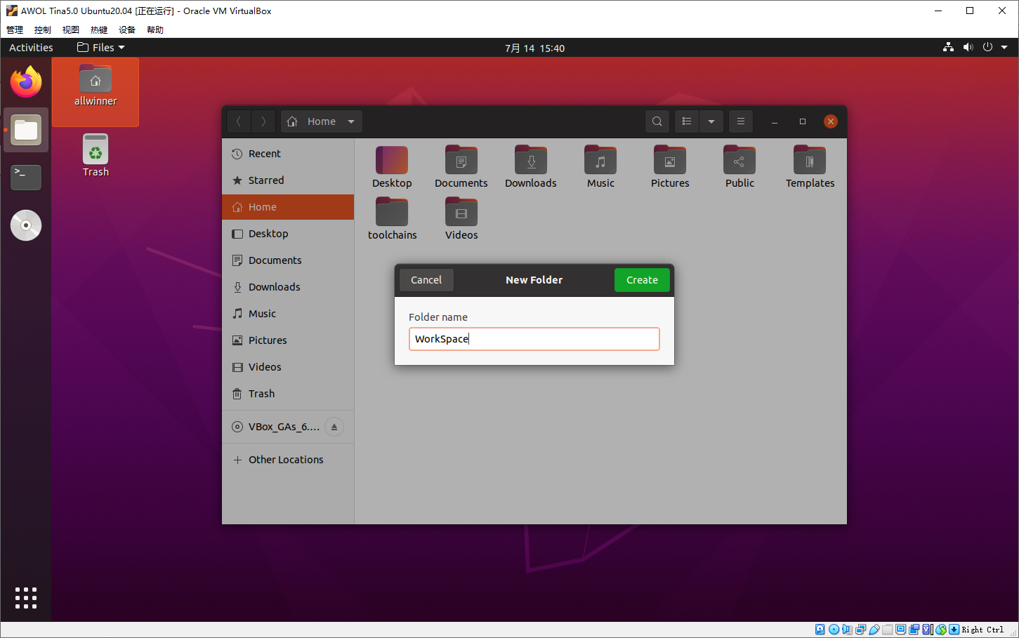

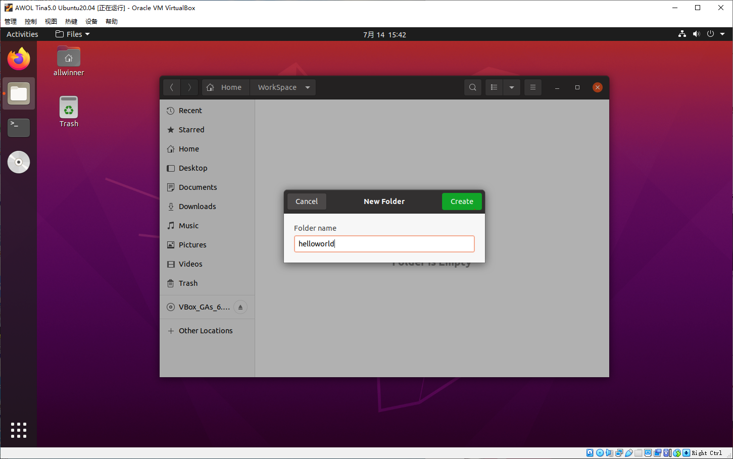

We first create a new folder in the folder as a folder to store the project, named WorkSpcae
Then create a new folder in the WorkSpace folder to store our helloworld code, named helloworld
At this point, the environment for compiling the helloworld project is ready.

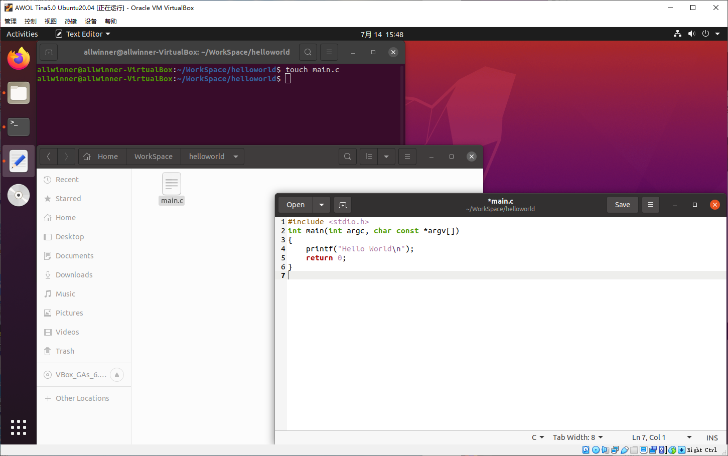

Wirte HelloWorld Code

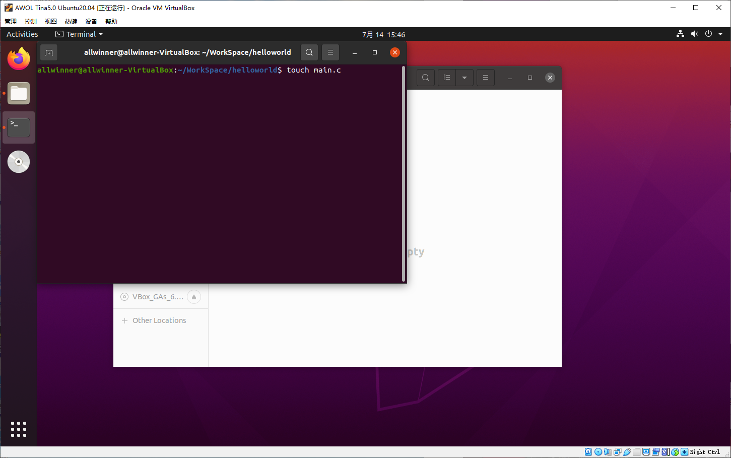

Go to the helloworld folder, right click on the blank space to see the Open in Terminal option
Open the command line and enter the touch main.c command to create a new main.c source file.
Double-click to open the main.c source file, write the source code and save it
printf("Hello World\n");

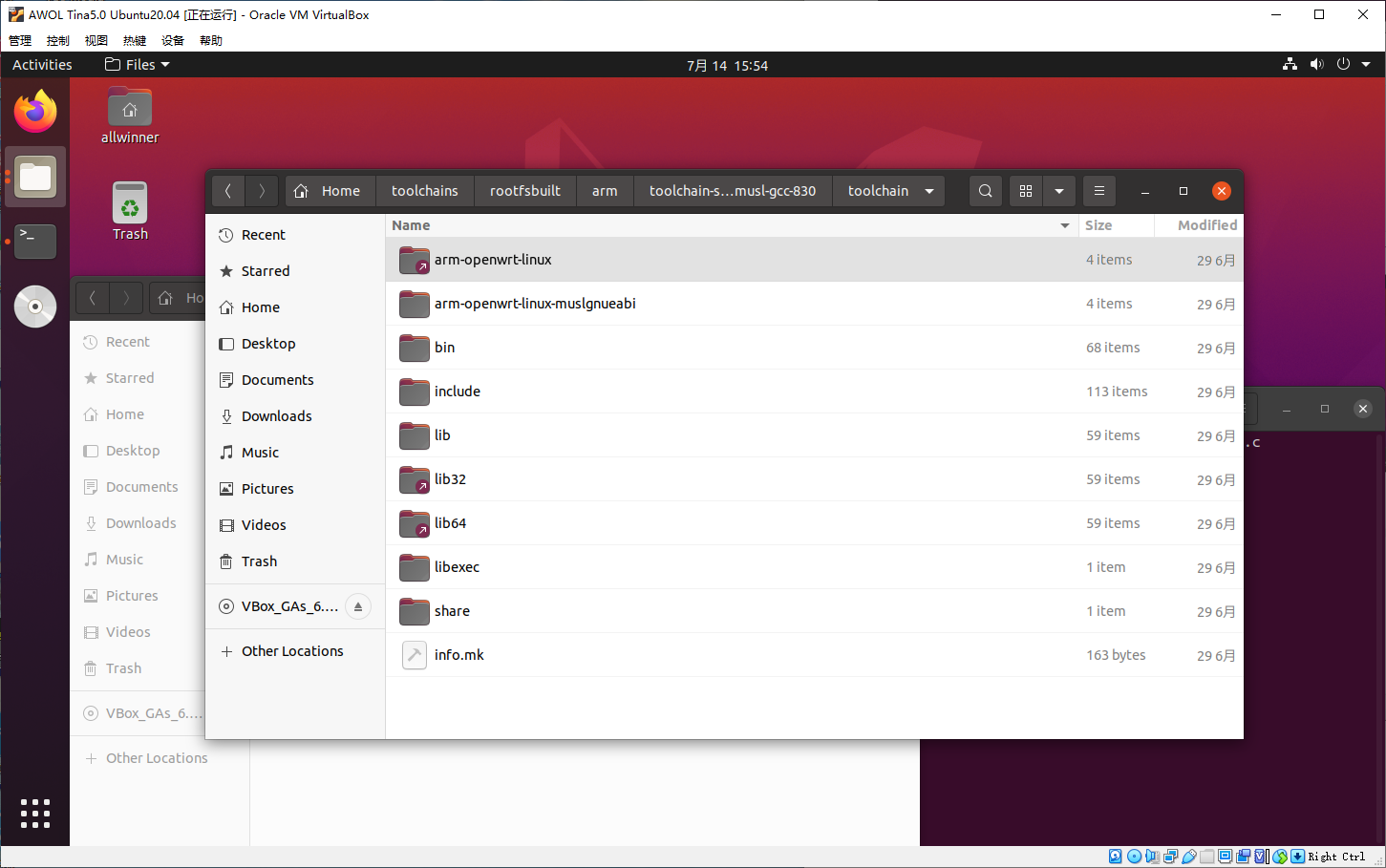

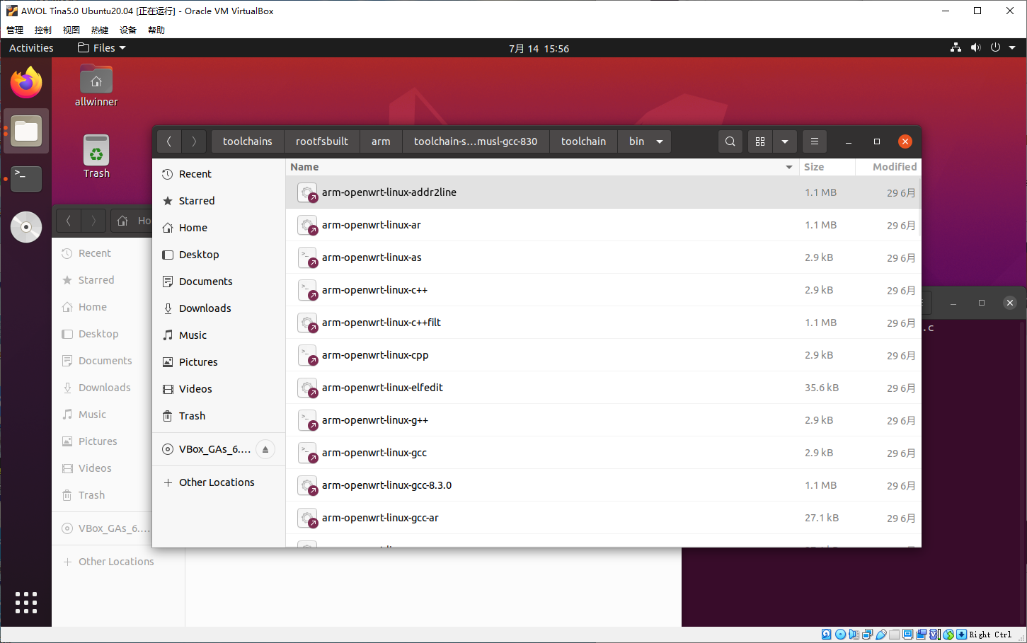

The cross-compilation toolchain used for cross-compilation is named toolchain-sunxi-musl-gcc-830 and is stored in the toolchains\rootfsbuild\arm\ folder.
The gcc compiler used for compilation is in the toolchains/rootfsbuilt/arm/toolchain-sunxi-musl-gcc-830/toolchain/bin folder.

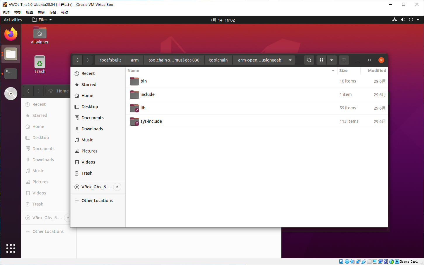

Of course, a compiler is not enough, you also need to provide those library files and header files that you need to use when compiling. These files are stored in the toolchains/rootfsbuilt/arm/toolchain-sunxi-musl-gcc-830/toolchain/arm-openwrt-linux-muslgnueabi folder.

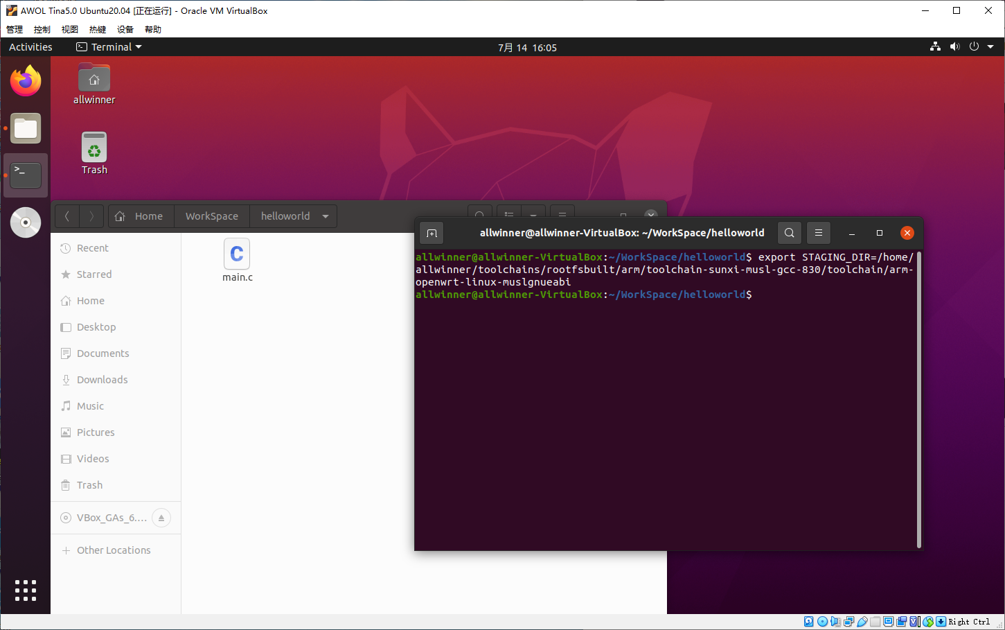

First, specify the folder where the header files of the library files needed for cross-compilation are stored.
export STAGING_DIR=~/toolchains/rootfsbuilt/arm/toolchain-sunxi-musl-gcc-830/toolchain/arm-openwrt-linux-muslgnueabi
Then you can use the cross-compilation toolchain to compile, and you can see that the compiled helloworld executable file has been generated.
~/toolchains/rootfsbuilt/arm/toolchain-sunxi-musl-gcc-830/toolchain/bin/arm-openwrt-linux-gcc -o helloworld main.c

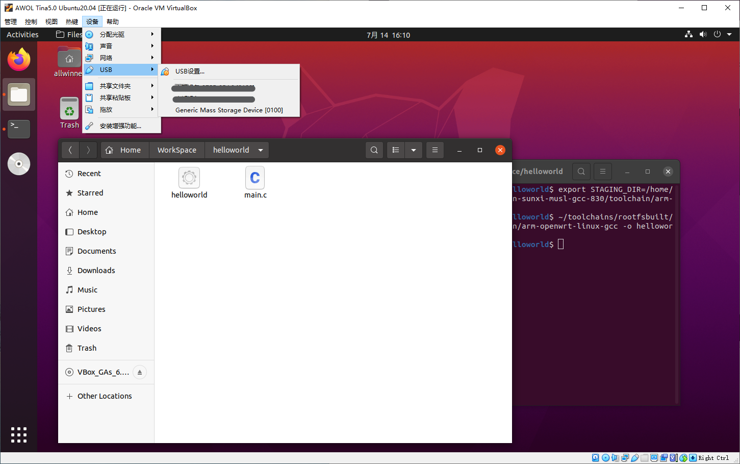

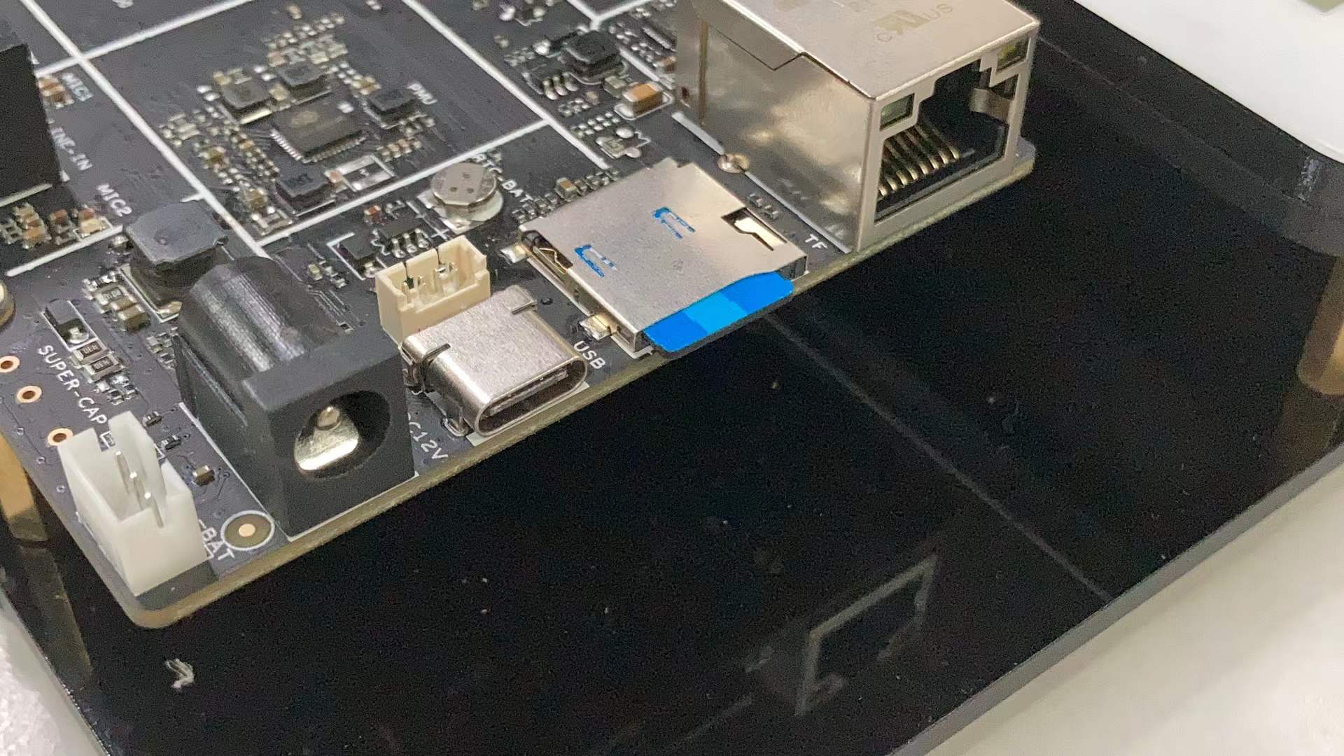

We can upload files to the dev board using various methods such as U disk, adb, nfs, TF card, etc. Here we use the TF card to upload the helloworld executable file to the development board.

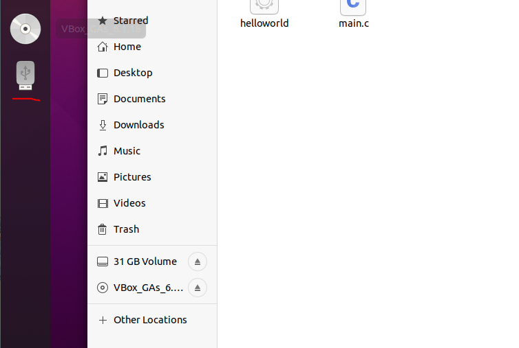

First, insert the TF card into the card reader and connect it to the computer. In the device, you can see a Mass Storage device in the USB. Check this device.
Then you can see the card reader in the virtual machine.

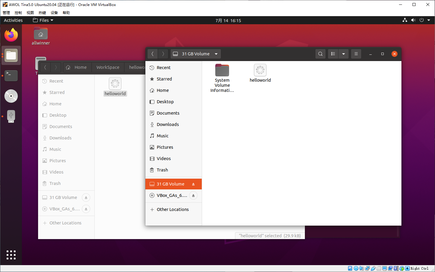

Copy helloworld into TF card
Insert the TF card into the dev board

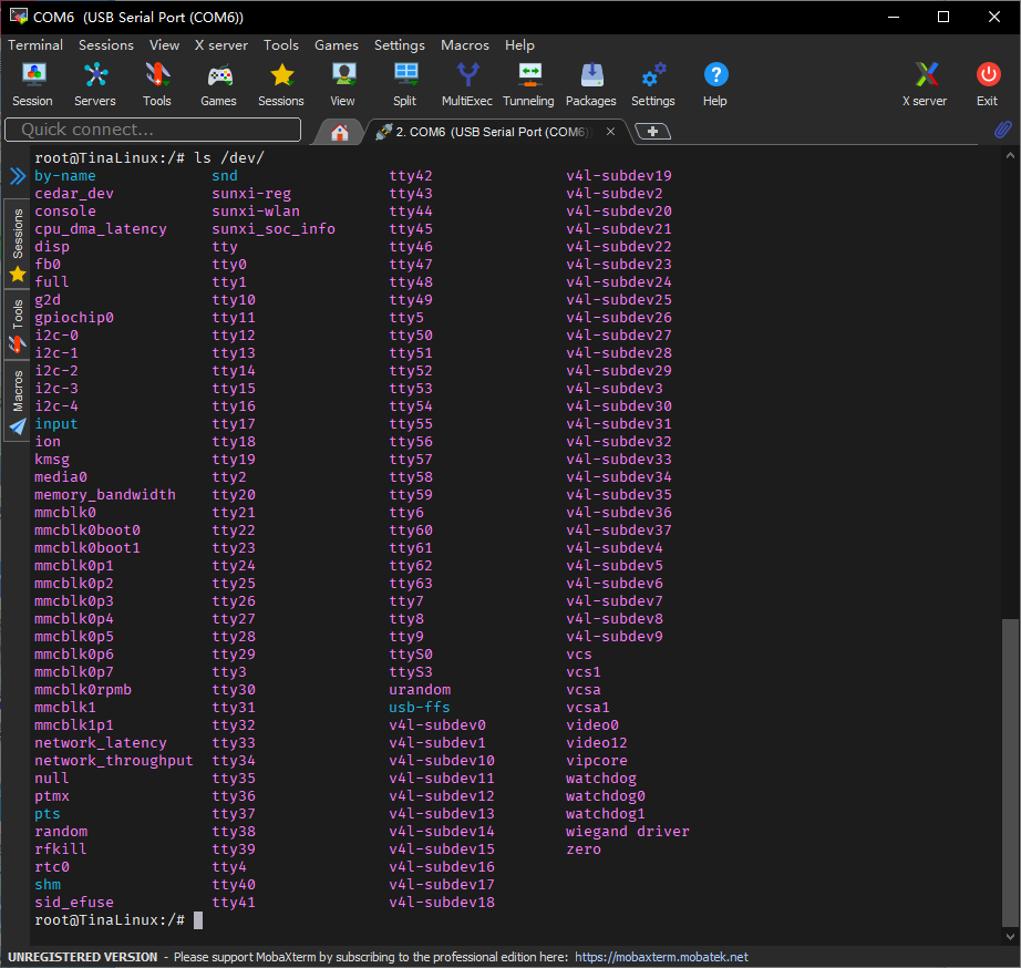

ls /dev Check if mmcblk1 appears, you can see that there is mmcblk1 here
Then mount the TF card, the partition is mmcblk1p1, mount it to the /mnt/SDCARD path, then cd into the /mnt/SDCARD folder, you can use the ls command to list the files, You can see that helloworld is here.
