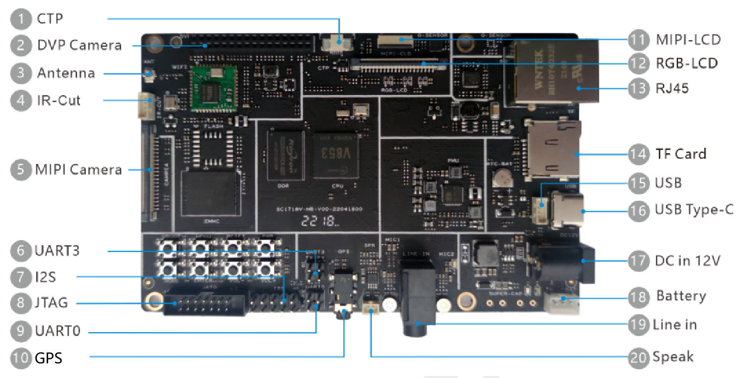

Dev Board User Guide
This chapter will introduce the basic usage of each module on the V853 development board.
The V853 development board integrates LED, WiFi, Bluetooth, Ethernet, audio, screen, USB, TF card and other modules. This chapter will briefly introduce the operation of these modules, so that developers can quickly get started and understand the development board.

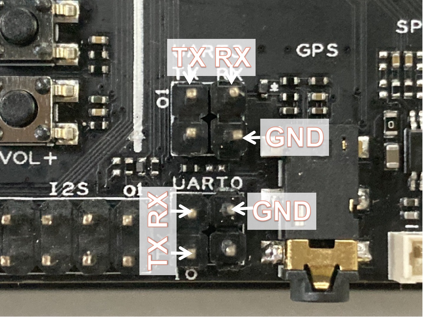

Serial debug

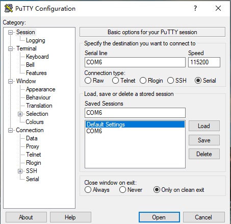

The V853 development board has two independent debug serial ports to choose from, UART0 and UART3, corresponding to the chip's UART0 PH9 PH10, UART3 PH1 PH2.
According to the default SDK configuration, UART0 provides debug output of Arm core, and UART3 provides debug output of E907 RV core. The provided FT232 USB-to-serial cable is defined as: black-GND, green-RX, white-TX, red is power.
After the hardware connection is completed, use the serial terminal to access, the baud rate is 115200 . For example PuTTY used here

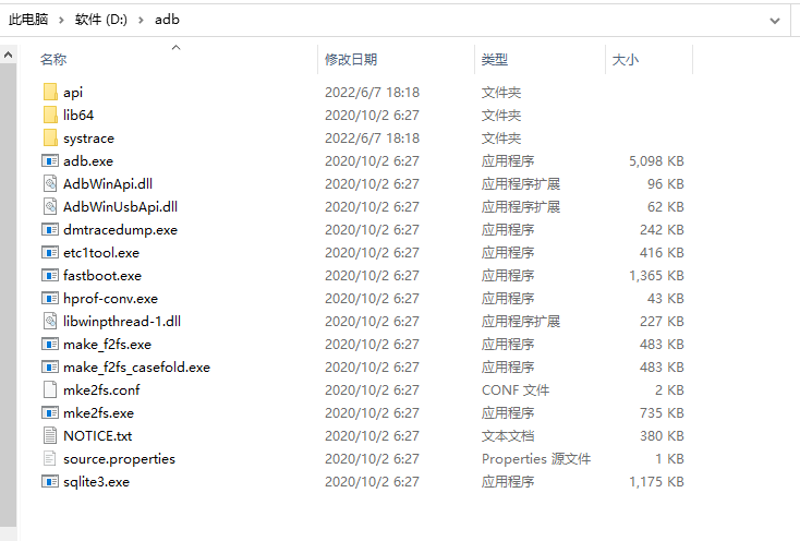

(1) Download the ADB tool ADB(tab auto-completion version) in Allwinners Developer Community-Data Download Area
(2) After downloading, unzip it and put it on the local disk (for example, in the adb folder of the D disk)

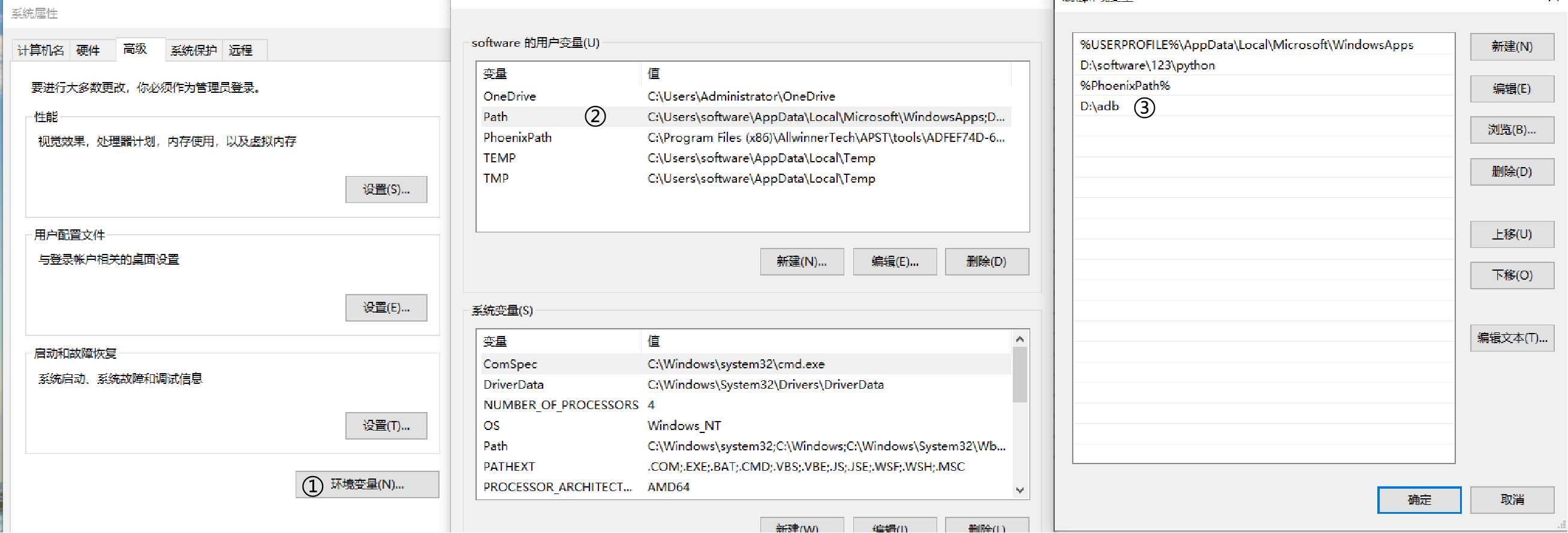

(3) Right-click "This Computer", Properties, find Advanced System Settings, click Environment Variables, xxx user's environment variables, Path, and add an environment variable.
(4) Open a command prompt and enter adb shell

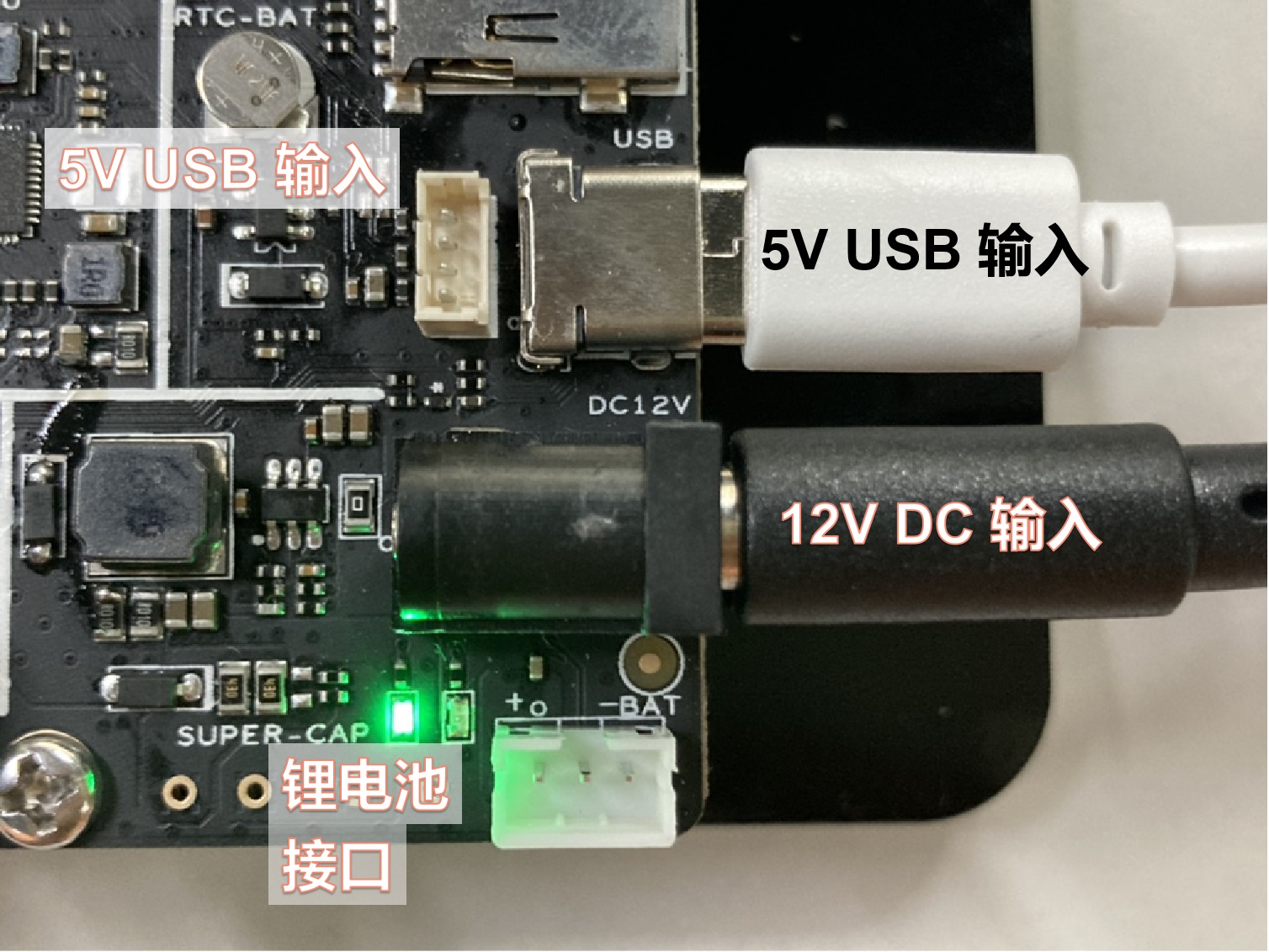

Start and Restart
Start

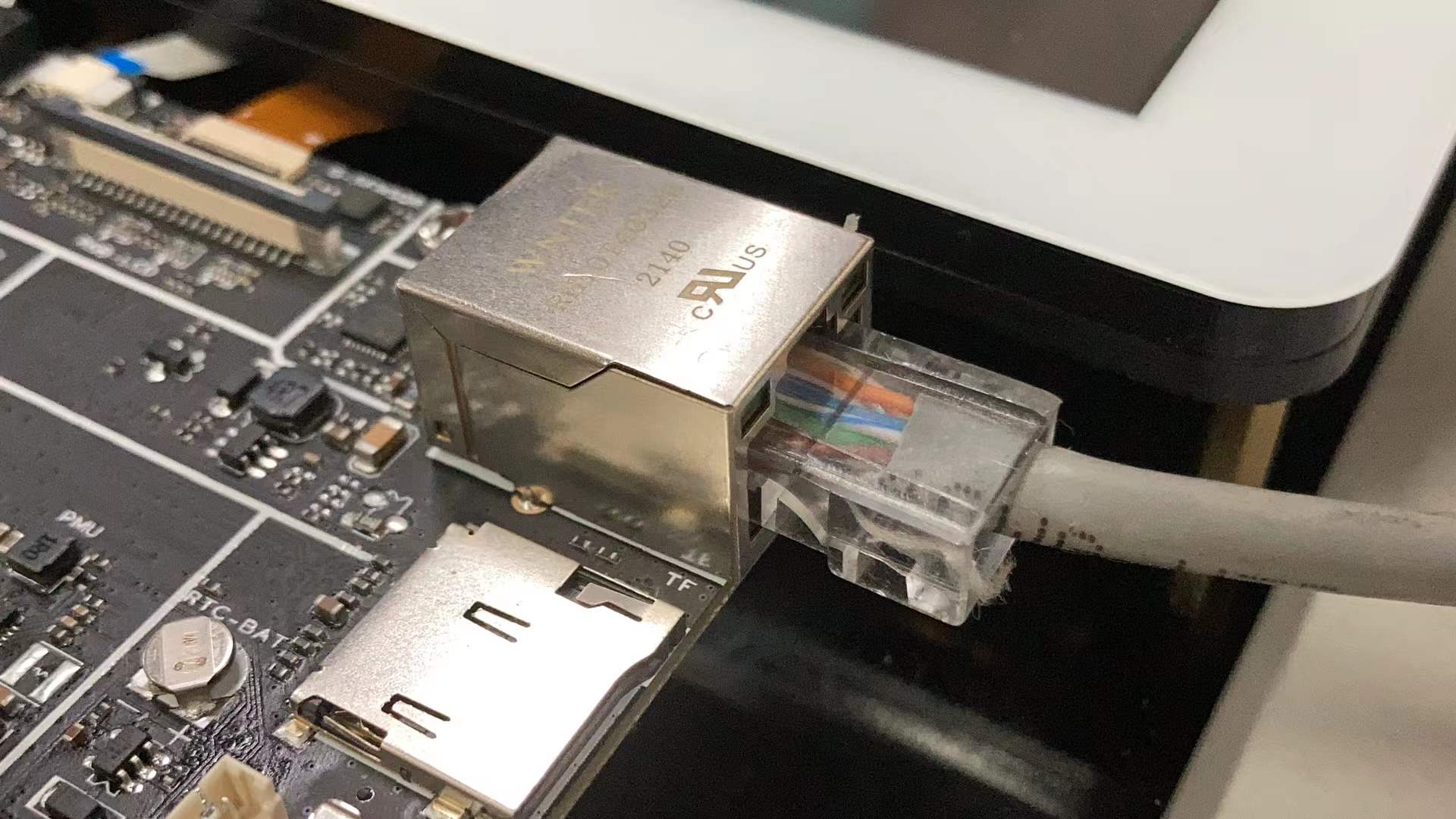

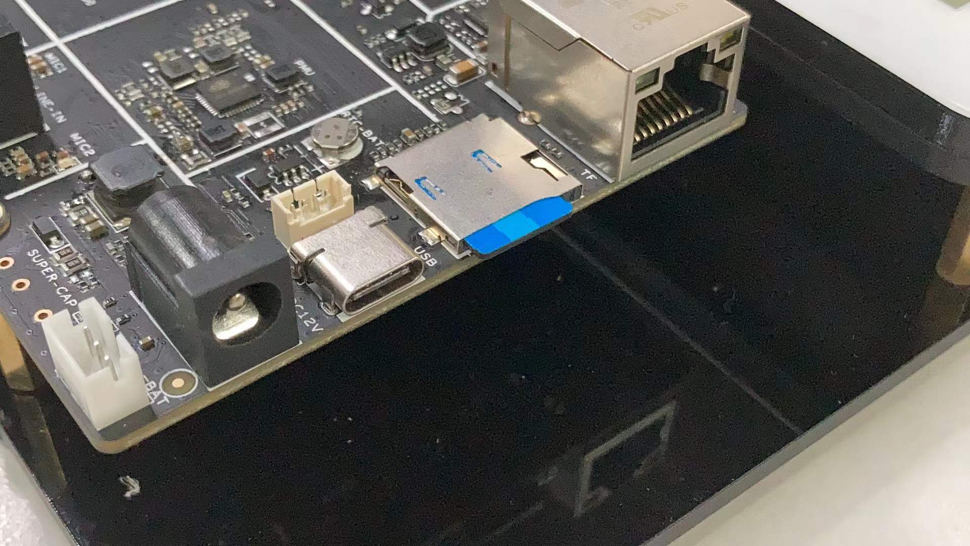

At present, the development board is in the power-on mode, only need to plug in the 12V DC power adapter or use the USB Type C cable to connect the power supply.
Please note that if the Type C is connected to the USB port of the computer, the device may boot repeatedly due to the low output current of the computer's USB. At this time, you need to insert a 12V DC power adapter as an auxiliary power supply.
At the same time, the USB can also be connected through the connector on the left side of the USB port in the figure (beige), which is convenient for assembly and use.
The white connector on the lower right corner of the development board is the battery interface, which can be connected to a supported lithium battery.

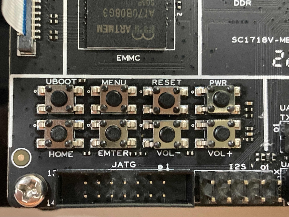

Flash Mode
There tow ways to enter Flash Mode.
Button Enter Flash Mode
Find the button RESET and UBOOT in the board
(1) Press UBOOT button until (3) ready;
(2) Click RESET button;
(3) Wait board connect borad success, release UBOOT button;
Command EnterFlash Mode
In Linux shell, enter command reboot efex in board so that it will restart and enter flash mode.
root@TinaLinux:/# reboot efex
In U-Boot shell, enter command efex so that it will enter flash mode.
=> efex

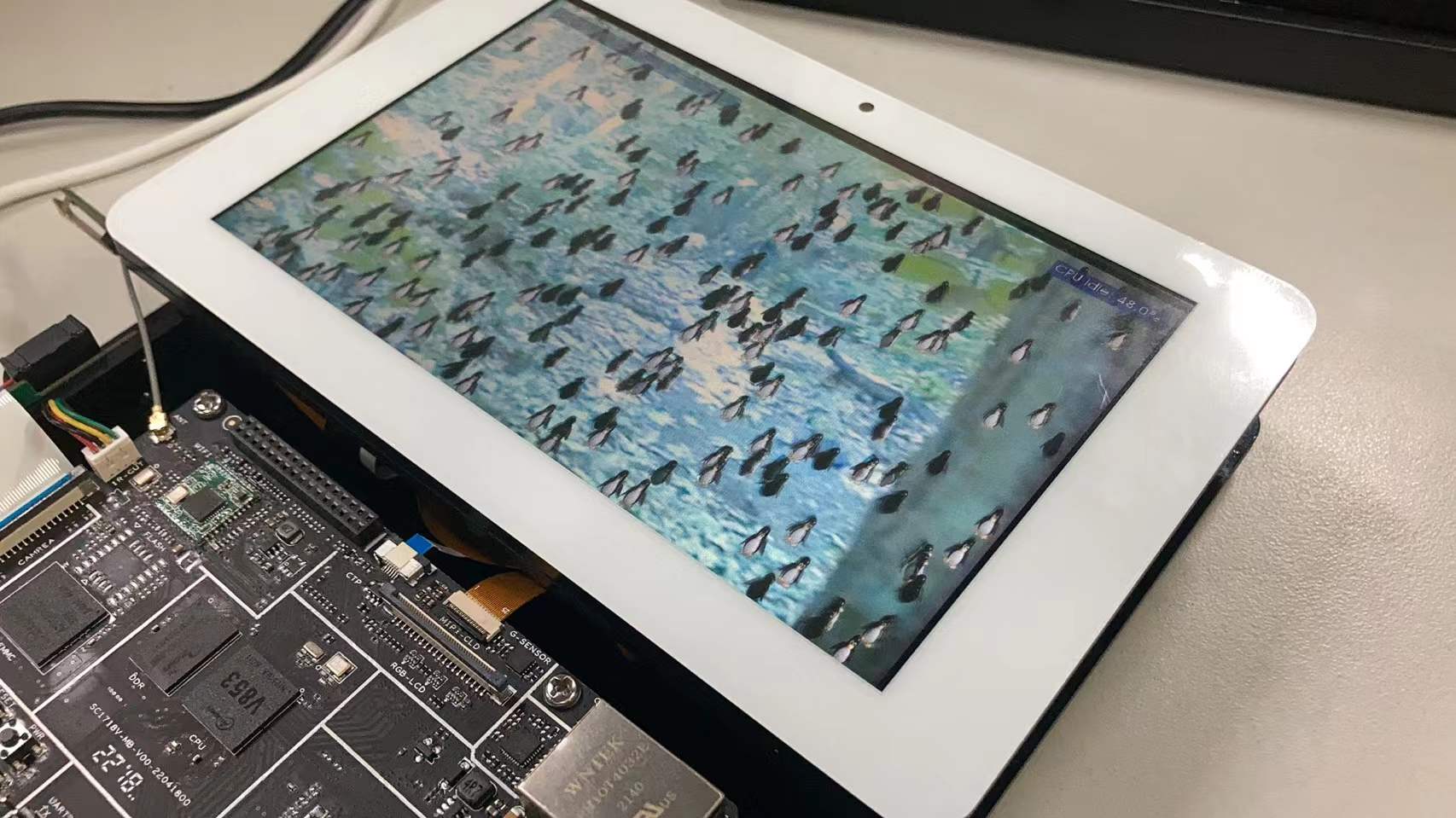

GPIO Light a Lamp

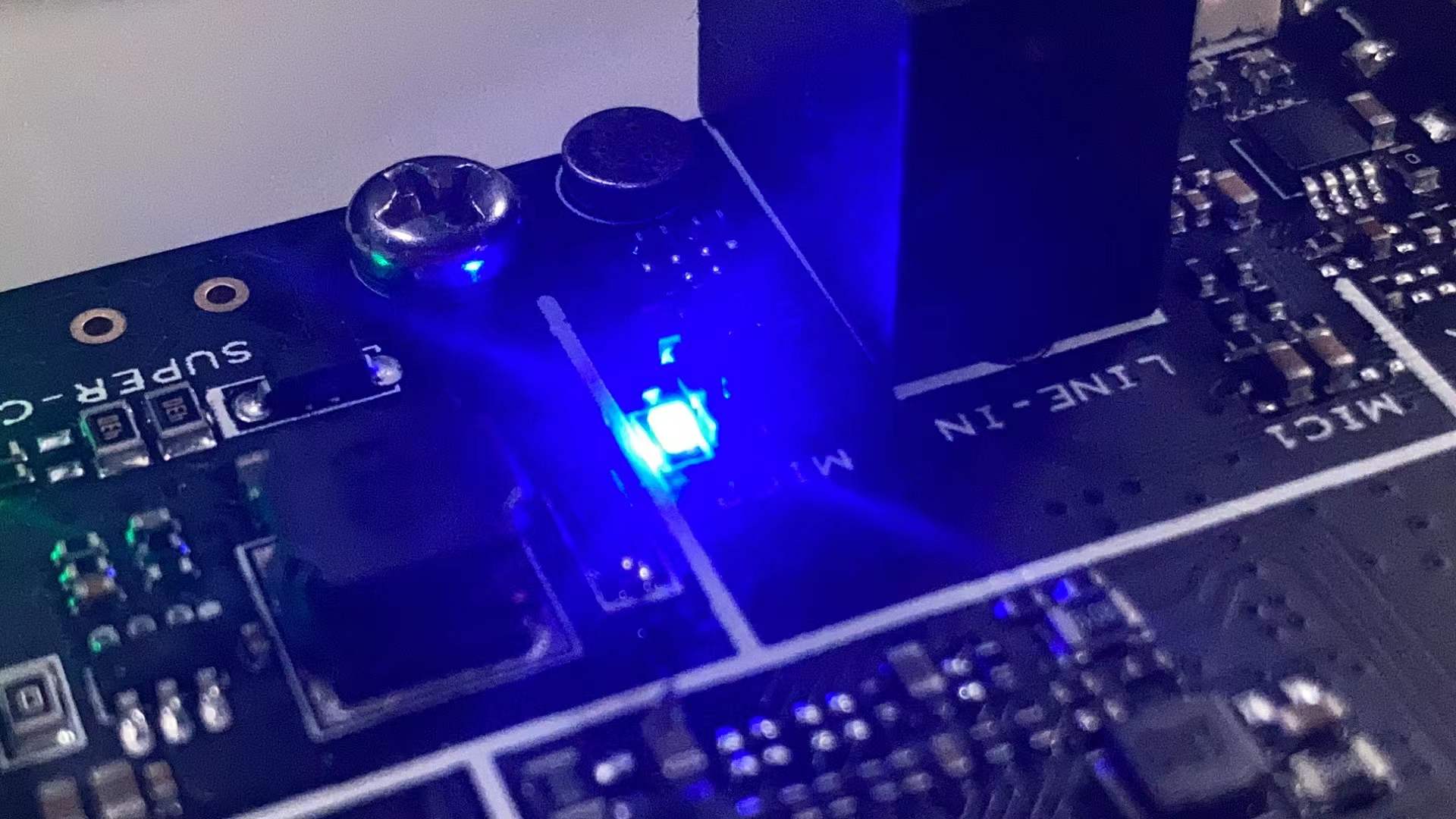

The development board has an LED light for user operation, which is connected to PH11.
Convert the digital label of the IO to: 7 * 32 + 11 = 235, or check the IO multiplexing table, where (MUX UNCLAIMED) indicates that this GPIO is not currently used:
root@TinaLinux:/# cat /sys/kernel/debug/pinctrl/pio/pinmux-pins
It will output the following:
pin 231 (PH7): (MUX UNCLAIMED) (GPIO UNCLAIMED)
pin 232 (PH8): (MUX UNCLAIMED) (GPIO UNCLAIMED)
pin 233 (PH9): uart0 (GPIO UNCLAIMED) function uart0 group PH9
pin 234 (PH10): uart0 (GPIO UNCLAIMED) function uart0 group PH10
pin 235 (PH11): (MUX UNCLAIMED) (GPIO UNCLAIMED)
pin 236 (PH12): (MUX UNCLAIMED) pio:236
pin 237 (PH13): 2020000.wiegand pio:237 function wiegand group PH13
pin 238 (PH14): 2020000.wiegand pio:238 function wiegand group PH14
pin 239 (PH15): (MUX UNCLAIMED) pio:239
Let's export the GPIO first:
echo 235 > /sys/class/gpio/export
cd /sys/class/gpio/gpio235
Then put the IO into the output state, you can operate its level:
echo out > direction
echo 1 > value #LED light up
echo 0 > value #LED snub out

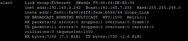

root@TinaLinux:/# wifi -c awol 12345678
(4) After connecting to the network, enter ifconfig to view the current ip address
Network connectivity can be tested using the ping command
root@TinaLinux:/# ping www.baidu.com

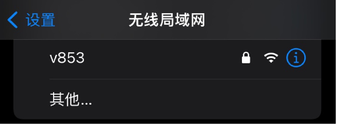

Wi-Fi hotspot
(1) Create a hotspot (SSID: v853, password: 12345678)
root@TinaLinux:/# wifi -o ap v853 12345678
(2) Then you can scan to Wi-Fi, enter the password 12345678 to connect.

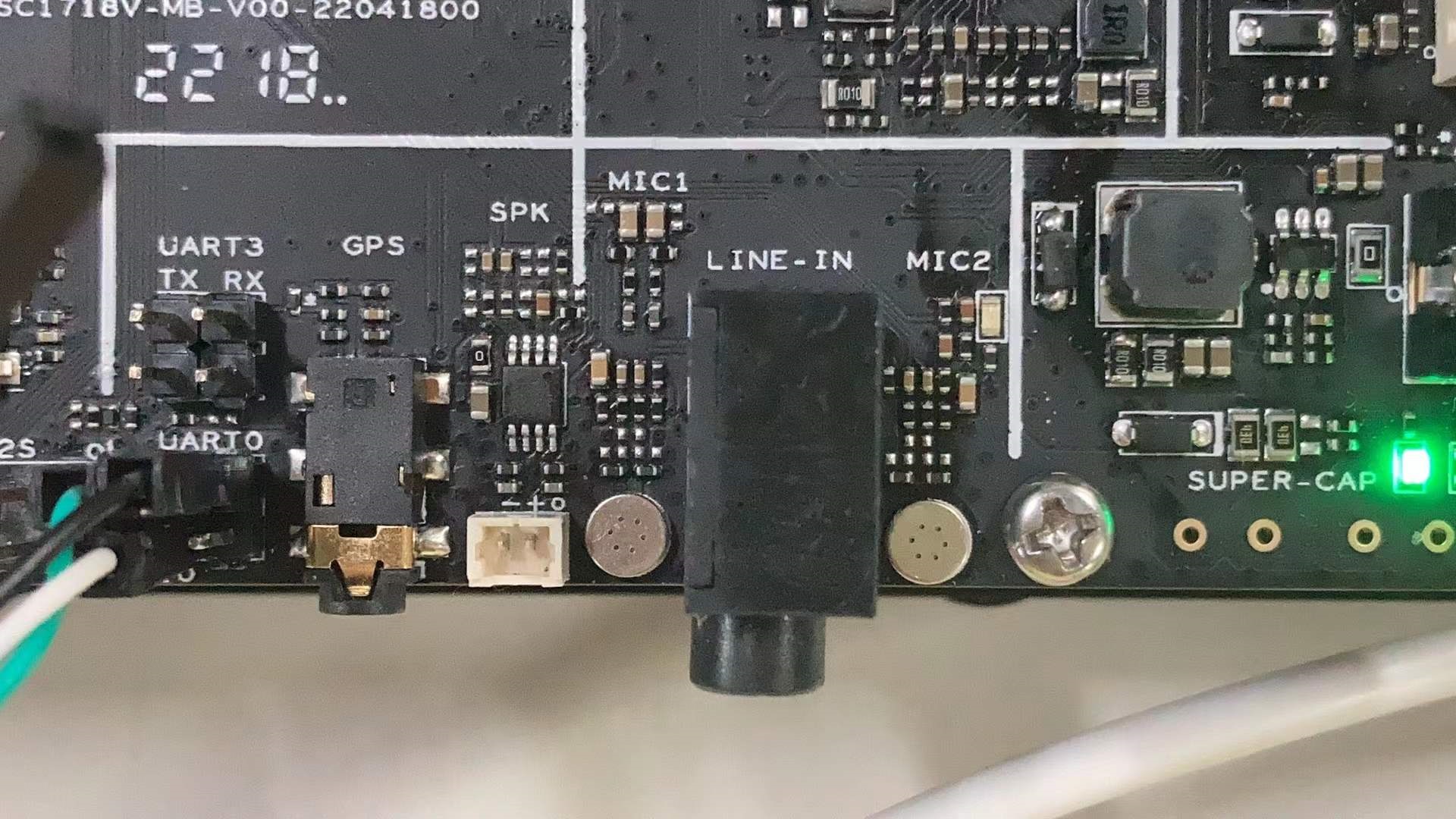

The V853 development board has two microphone inputs, one audio input, and one speaker output. /*Note that the 3.5mm headphone jack next to UART0 on the left is the UART port used by GPS, not the headphone jack
Record
View record equipment
You can use the arecord -l command to view the recording devices provided by the development board.
root@TinaLinux:/# arecord -l
**** List of CAPTURE Hardware Devices ****
card 0: audiocodec [audiocodec], device 0: soc@03000000:codec_plat-sunxi-snd-codec sunxi-snd-codec-0 []
Subdevices: 1/1
Subdevice #0: subdevice #0
card 1: snddaudio0 [snddaudio0], device 0: 2032000.daudio0_plat-snd-soc-dummy-dai snd-soc-dummy-dai-0 []
Subdevices: 1/1

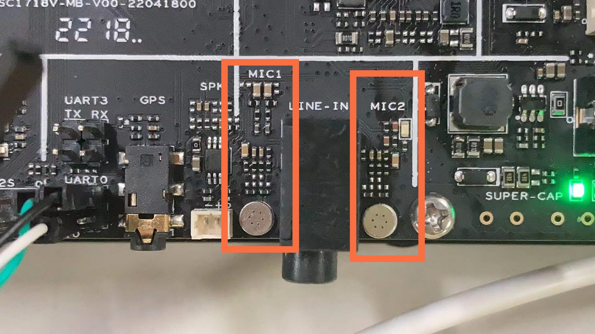

Microphone Record
The V853 development board has two microphones onboard, located near the LINE-IN interface.
Before recording, you need to open the audio channel first, and configure the internal MIC1 and MIC2 to record dual-channel audio.

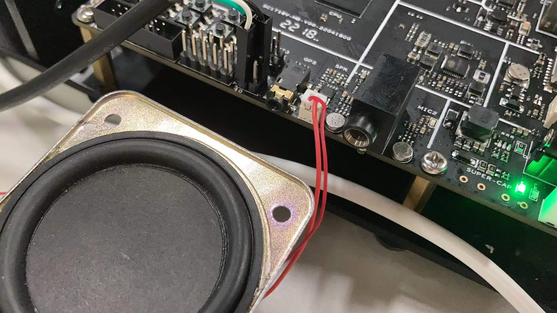

Speaker play audio
Before playing, you first need to open the audio channel and configure the speakers to play audio.
Enable LINEOUT output function
root@TinaLinux:/# amixer -D hw:audiocodec cset name='LINEOUT Output Select' 1
numid=22,iface=MIXER,name='LINEOUT Output Select'
; type=ENUMERATED,access=rw------,values=1,items=2
; Item #0 'single'
; Item #1 'differ'
: values=1
Open LINEOUT channel
root@TinaLinux:/# amixer -D hw:audiocodec cset name='LINEOUT Switch' 1
numid=20,iface=MIXER,name='LINEOUT Switch'
; type=BOOLEAN,access=rw------,values=1
: values=on
Set the output volume
root@TinaLinux:/# amixer -D hw:audiocodec cset name='LINEOUT volume' 25
numid=16,iface=MIXER,name='LINEOUT volume'
; type=INTEGER,access=rw---R--,values=1,min=0,max=31,step=0
: values=25
| dBrange-
rangemin=0,,rangemax=1
| dBscale-min=0.00dB,step=0.00dB,mute=1
rangemin=2,,rangemax=31
| dBscale-min=-43.50dB,step=1.50dB,mute=1
Use aplay to play the audio you just recorded through the external speakers.
aplay -D hw:audiocodec t.wav
Playing WAVE 't.wav' : Signed 16 bit Little Endian, Rate 16000 Hz, Stereo

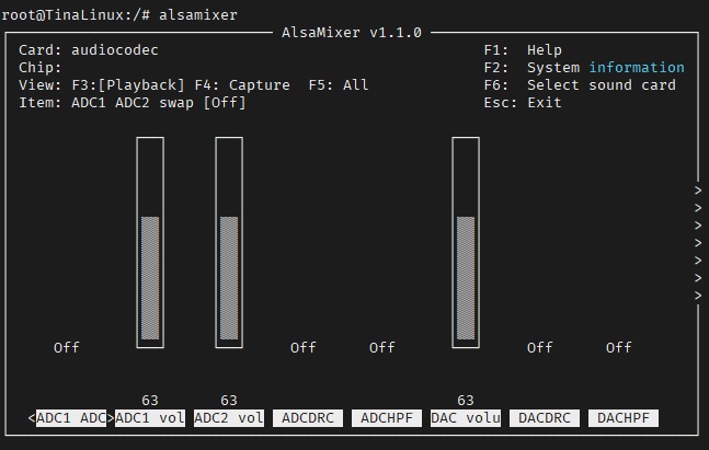

Adjust Volume
Use the graphical interface provided by alsamixer to adjust the volume.
root@TinaLinux:/# alasmixer

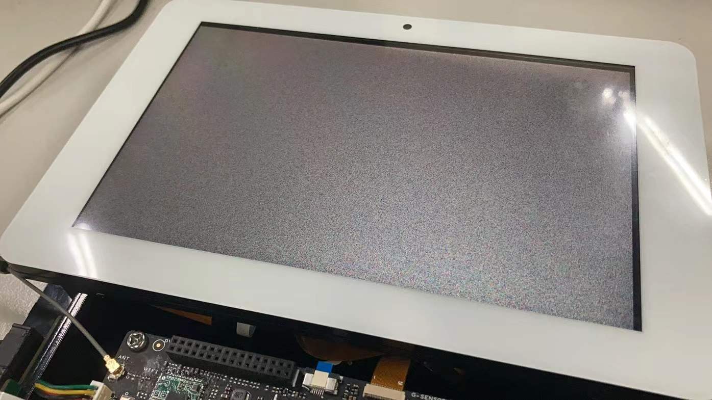

Snowflake Test
cat /dev/urandom > /dev/fb0

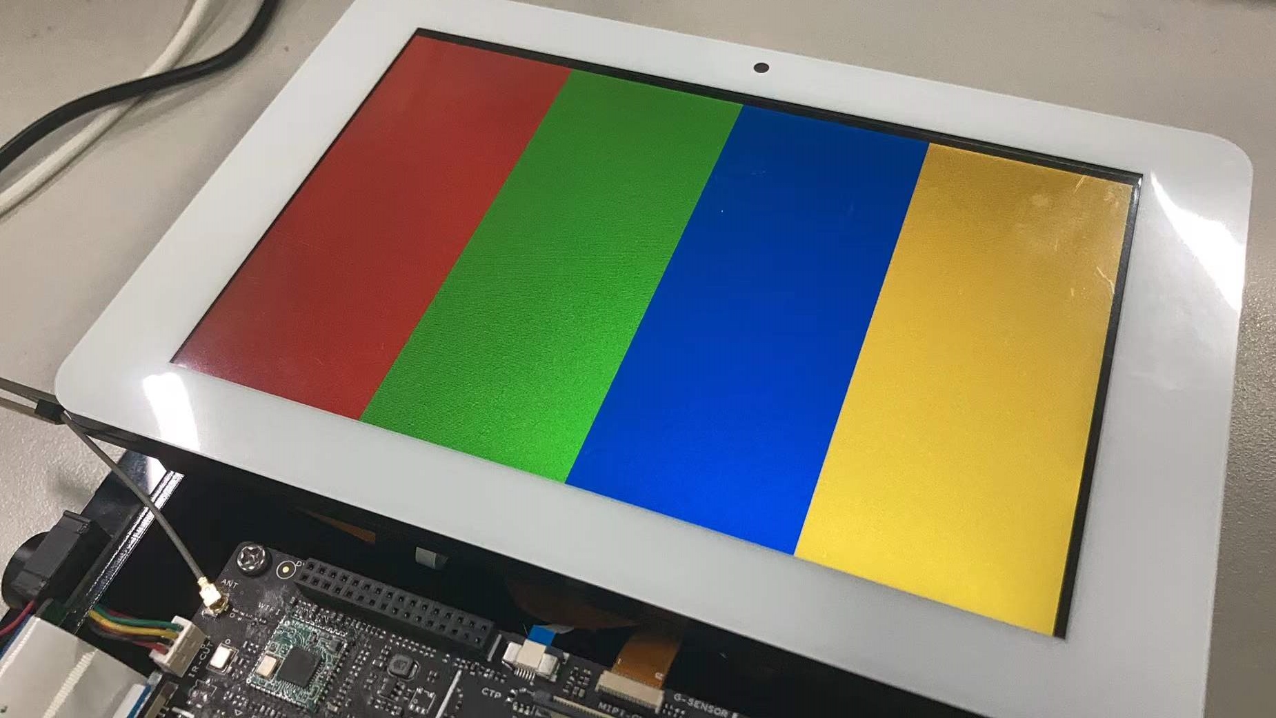

Color Stripe Test
Test through echo to /sys/class/disp/disp/attr/colorbar, 0 to 7 are different color stripe effects
echo 0 > /sys/class/disp/disp/attr/colorbar

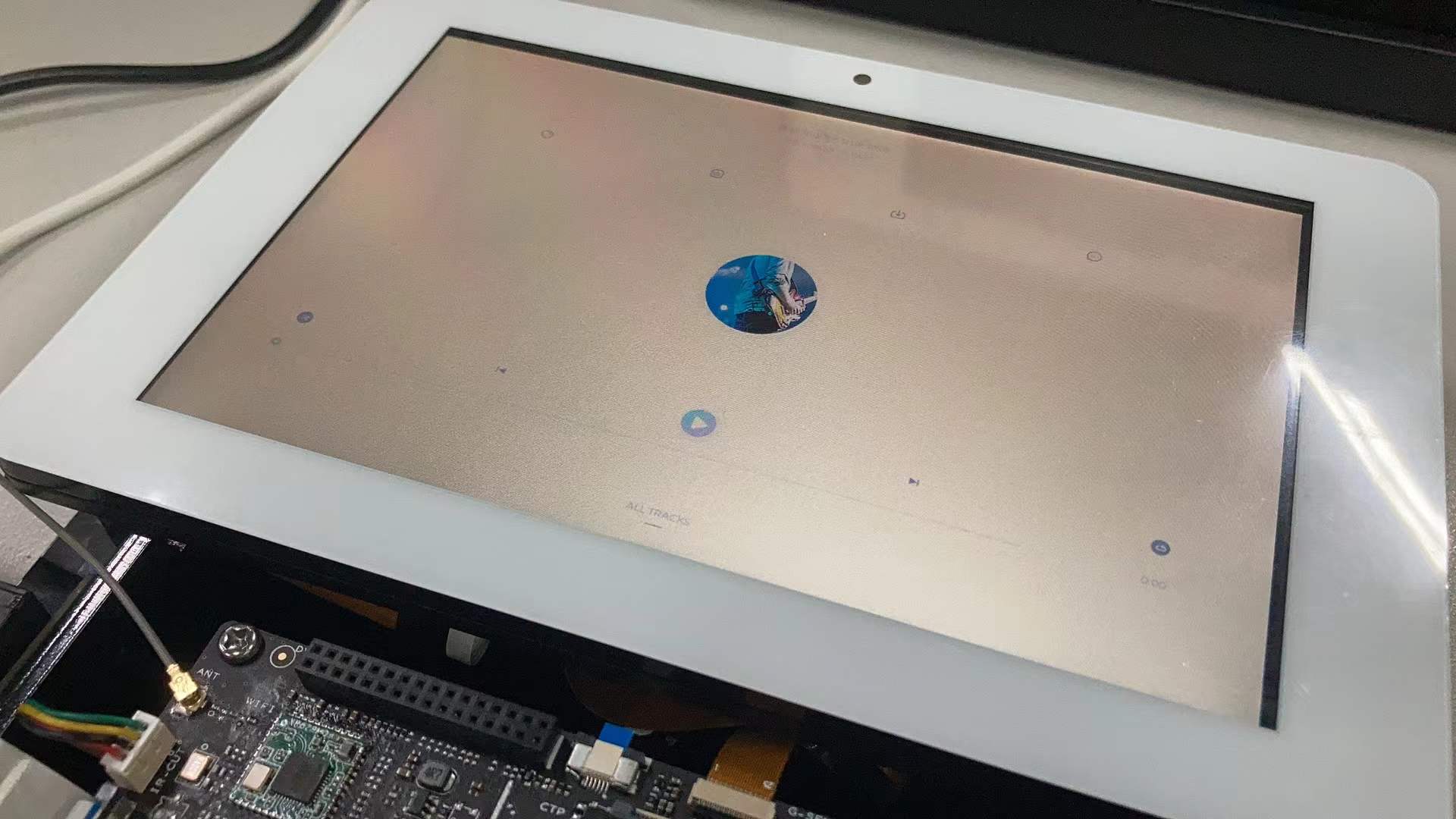

LVGL Test
LVGL (Lightweight and Versatile Graphics Library) is a free and open source graphics library that provides everything you need to create embedded GUIs with easy-to-use graphical elements, beautiful visual effects and a low memory footprint. This runs lv_examples 1 for testing.
root@TinaLinux:/# lv_examples 1
At the same time, the firmware also provides a variety of test effects.
lv_examples 0 = lv_demo_widgets
lv_examples 1 = lv_demo_music

TF Card
Insert the TF card, the TF card will be automatically mounted to the /mnt/sdcard directory
